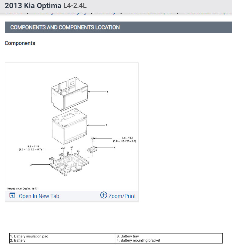

Here is a guide to help you test the battery and how to change it out in case it fails the test, also you can take the battery to the auto parts store so they can test it as well.
Check out the images (below). Please upload pictures or videos of the problem so we can see what's going on.

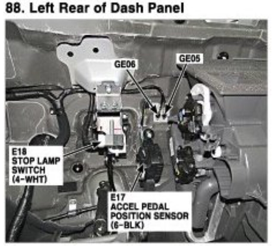

Thanks for the information and I appreciate it. I'm not sure yet but I'm leaning towards the brake light switch. I couldn't get any power to the brake switch fuse. So, I'm going to start with a new switch and see what happens. Thanks again and I will let you know if I get it fixed.
Dec 22, 2023 at 6:29 AM
  • 55,447 POSTS
Okay, here is how to change the brake light switch out to help us find out what's going on. Check out the images (below). Please let us know what happens.
