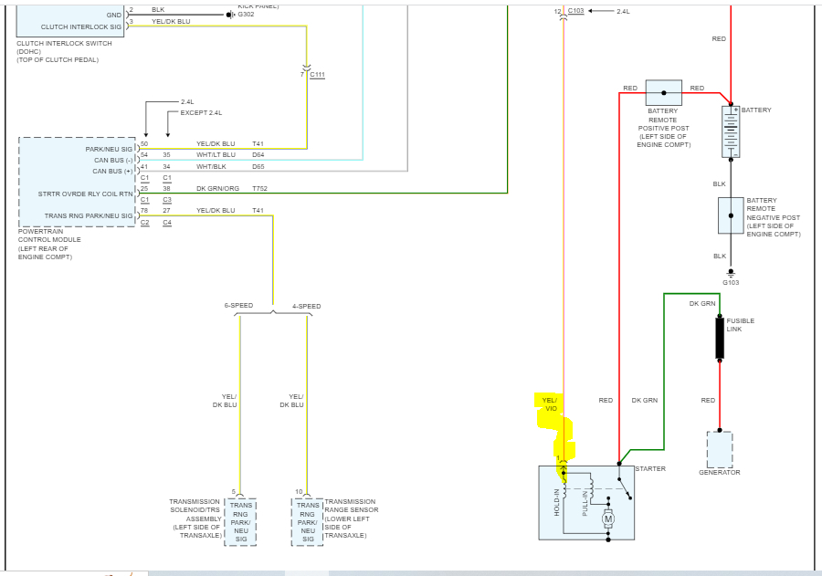

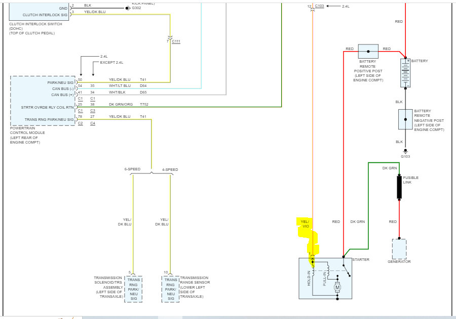

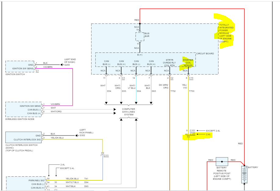

First, I attached the wiring schematic for the starter circuit below so that you have a reference. Before I jump into that, I have a question. When you hear the slow clicking, is it coming from the starter motor?

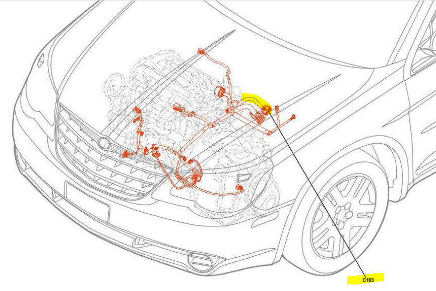

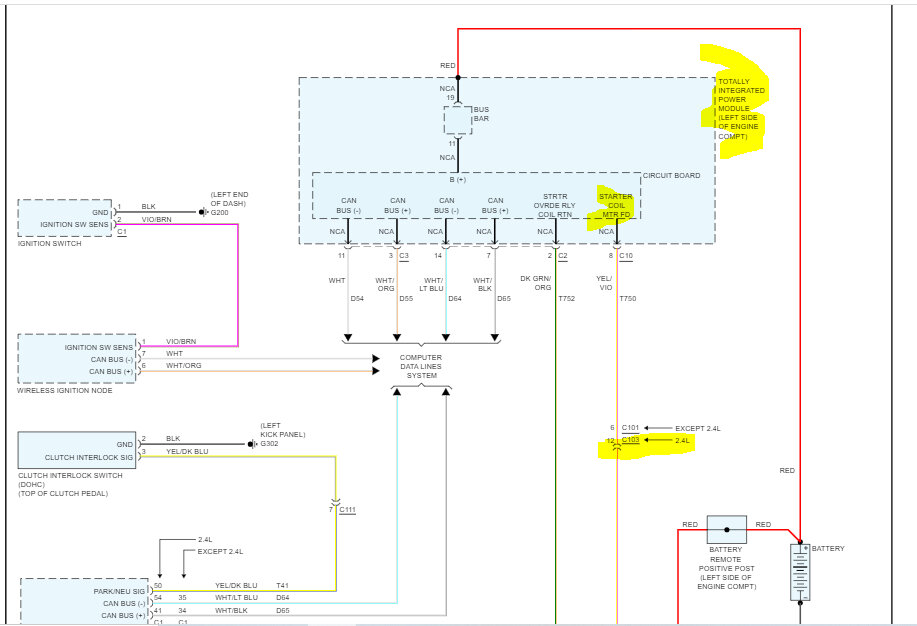

Also, I noticed in the schematic there is a connector between the power module and the starter motor trigger post. I need you to check the condition of that connector. Disconnect it and check the connector pins to make sure they aren't corroded or damaged. Pic 3 below shows the connector location.

Thanks for the info. I can tell you the connector on the starter side was clean. I can take a look at the TIPM side tomorrow. Can you help with the location of the connector in the middle? It appears buried in wire loom.

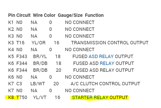

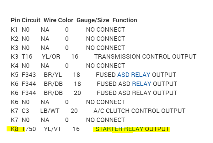

No problem. The relay output is in connector 10 and is pin 8. If you look below, I attached two pics. The first shows the connector pinout and the color of the connector. It is an 8-pin, light gray connector. I highlighted the connector pin.
The second pic is a legend of the connector pins.
Let me know if this helps.
