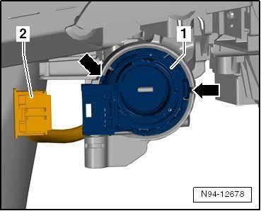

Here are the directions for replacing the switch. I'm not sure what you are jumping to start it. If you need a wiring schematic for a specific component, let me know.
2010 Volkswagen GTI (5K1) L4-2.0L Turbo (CBFA)
Ignition Switch
Vehicle Starting and Charging Sensors and Switches - Starting and Charging Ignition Switch Service and Repair Removal and Replacement Ignition Switch and Lock Cylinder, from 06/2010 Ignition Switch
IGNITION SWITCH
Ignition Switch
Removal
- Remove the steering column trim.
- Disconnect harness connector - 2 - from ignition/starter switch - 1 -.

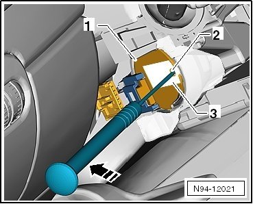

- Release the ignition switch with two small screwdrivers - arrows -.
pic 3
- Pull out ignition/starter switch - 1 - from steering lock housing.

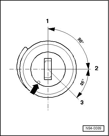

Key positions of lock cylinder:
1 Position Off
2 Position Run
3 Position Start
