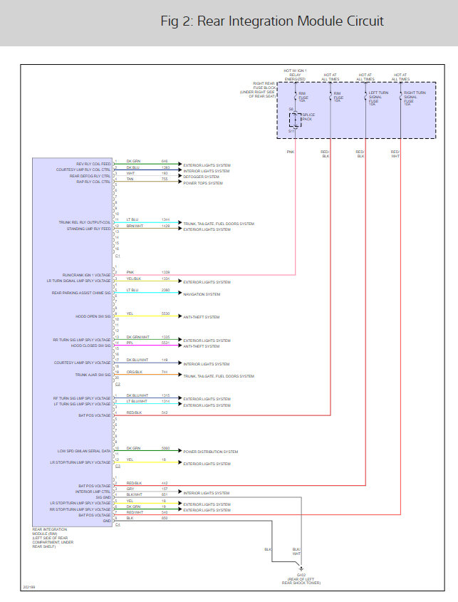

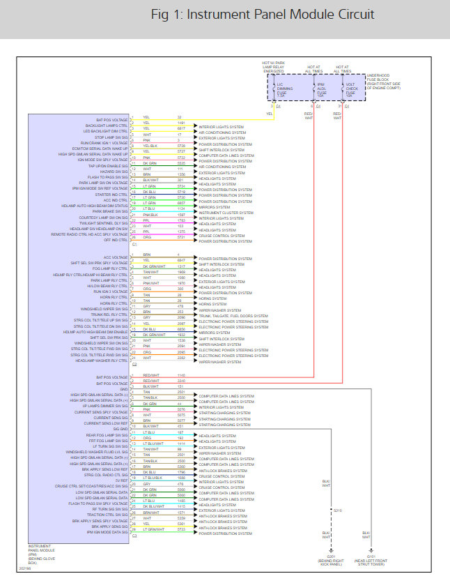

It sounds like the BCM has had a problem. Here is the location and the wiring diagrams and a guide so you can confirm the failure. Check for power and grounds to the modules.
Below are the BCM wiring diagrams.
