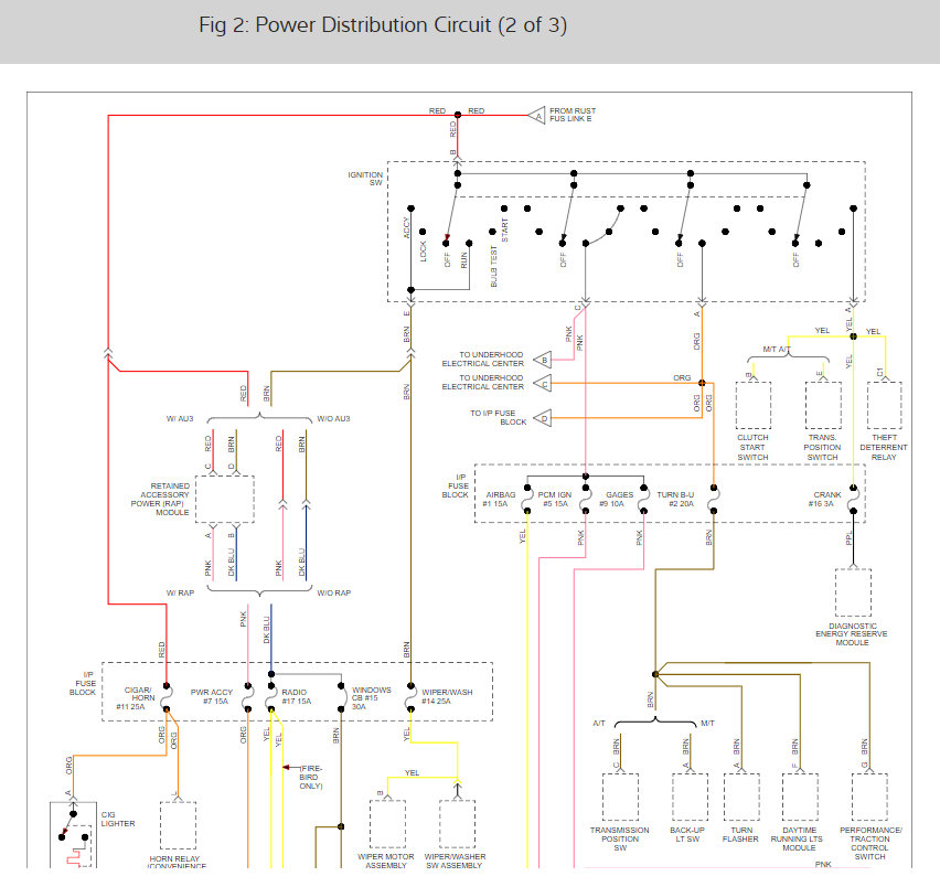

When I turn the key no gauge lights or warning lights come on nothing happens it will make a click noise but nothing else. Radio works lights inside lights work doors work windows work. Put in new starter checked wires from battery to starter and so on.

It sounds like the ignition switch went bad or one of the fusible links has failed. Here is a guide to help us check for power outside the switch and the wiring diagrams so you can see how the ignition switch works. Make sure power is coming out of the brown/pink and orange wires with the switch on.
