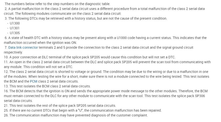

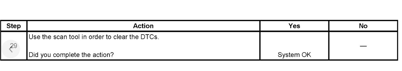

The problem first started when my radio burnt out, my cluster went crazy, ran for another week. week in half then it won"t start. I have no crank, no start and no communication to a code reader. battery fully charged checked fuses.
Feb 4, 2020 at 12:40 AM
Good evening,
Does the check engine light come on when you turn the key on?
Most times it is either a connection or the ECM is bad.

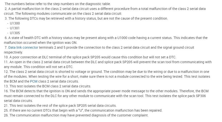

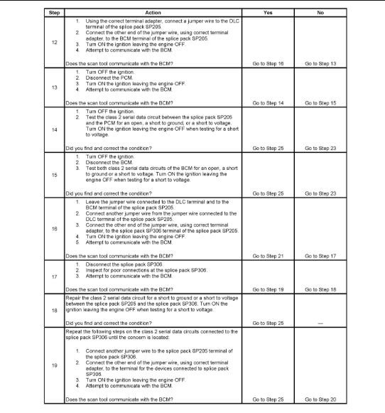

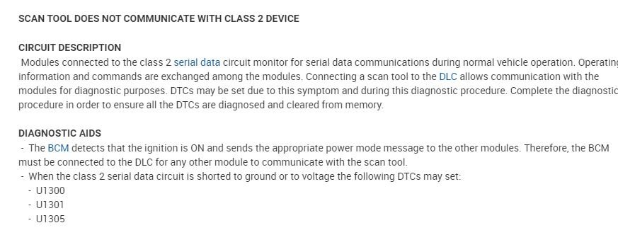

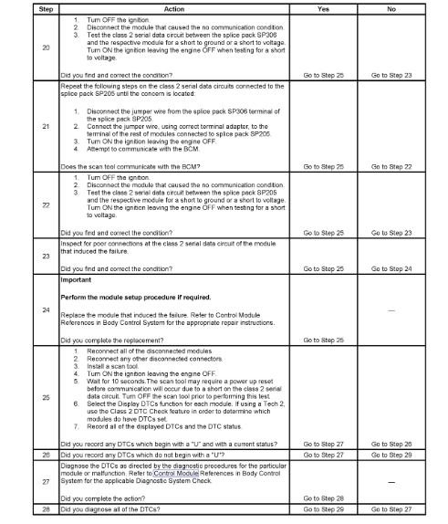

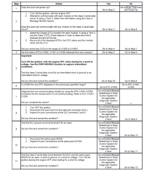

I attached a flow chart for you to follow.
