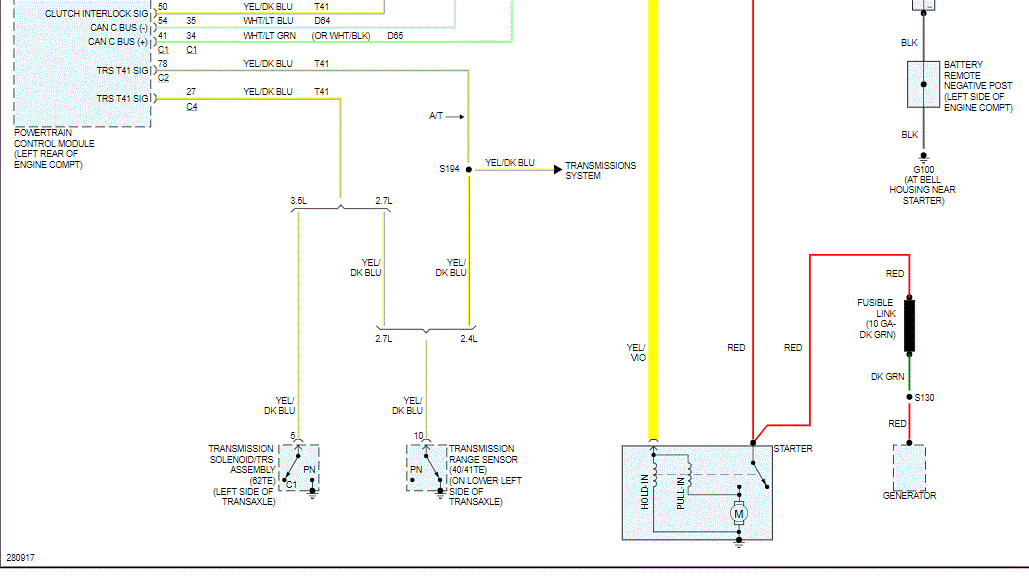

Engine will not crank, no codes from PCM. starter has been bench checked good, battery load tested good, all lights on dash work, radio works and headlights work. when you turn the key nothing; no click, no nothing, does not dim the headlights when turning to start.

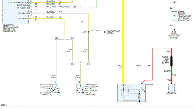

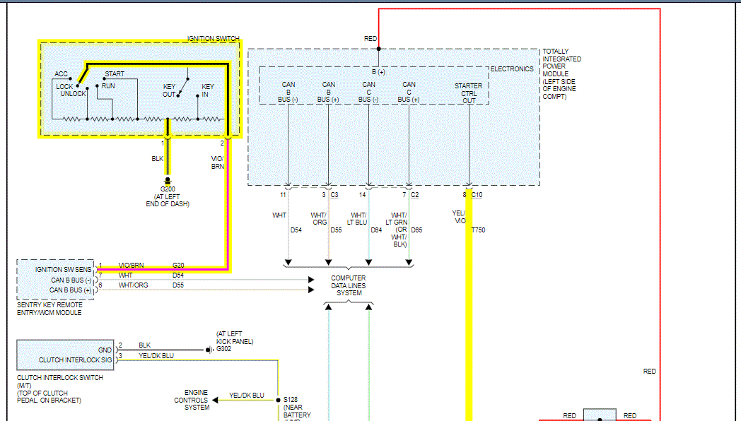

Do you have a test light or voltmeter to do some checks as to why it will not start?
I attached a starting diagram for you to view. Let me know when you are ready to do some testing.
Aug 18, 2020 at 12:23 AM
BJM4002
Yep, I have a test light and a VOM.
Aug 18, 2020 at 12:57 AM

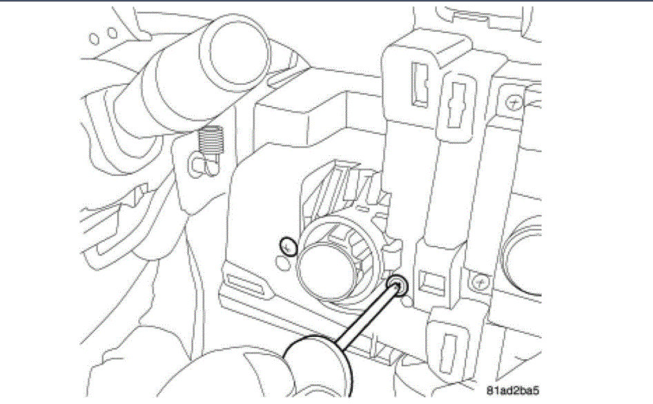

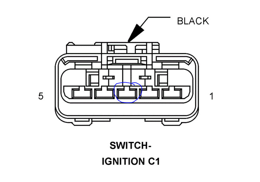

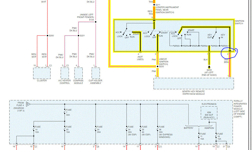

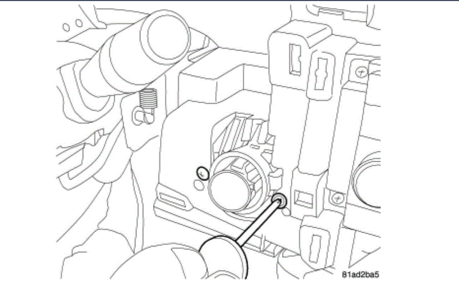

Okay, I need you to check and be sure voltage is being sent to the ECM for starting. You need to test the terminal I circled on the ignition switch for power with the key in the start position.

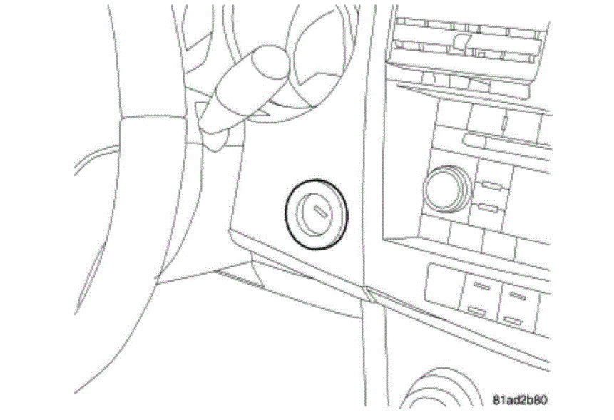

REMOVAL
1. Ignition switch location.

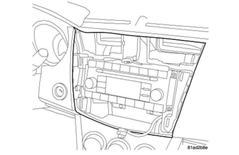

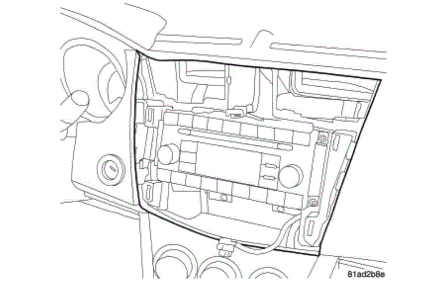

2. Remove radio bezel, See: Dashboard / Instrument Panel > Removal and Replacement > Instrument Panel Center Bezel - Removal
3. Disconnect negative battery cable.

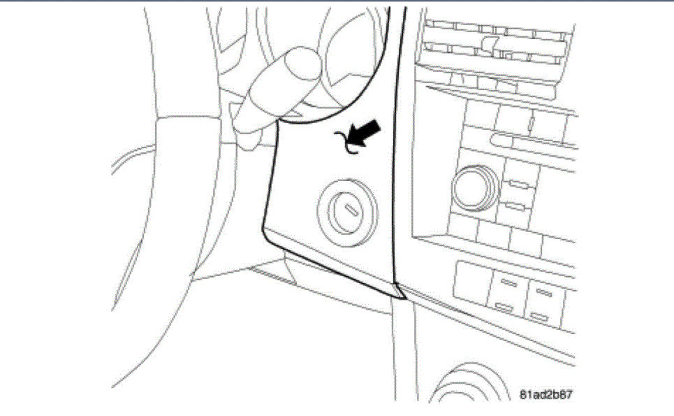

4. Remove instrument cluster bezel, See: Instrument Cluster / Carrier > Removal and Replacement > Instrument Panel Cluster Bezel - Removal.
5. Remove the knee bolster, See: Dashboard / Instrument Panel > Removal and Replacement > Removal.

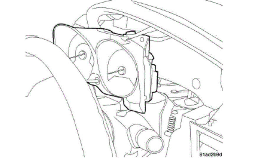

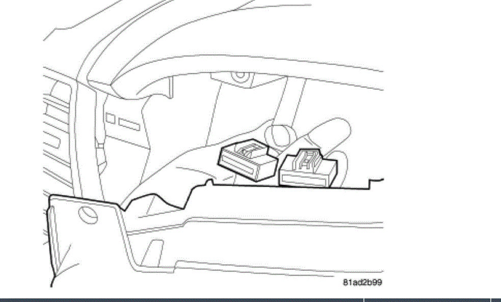

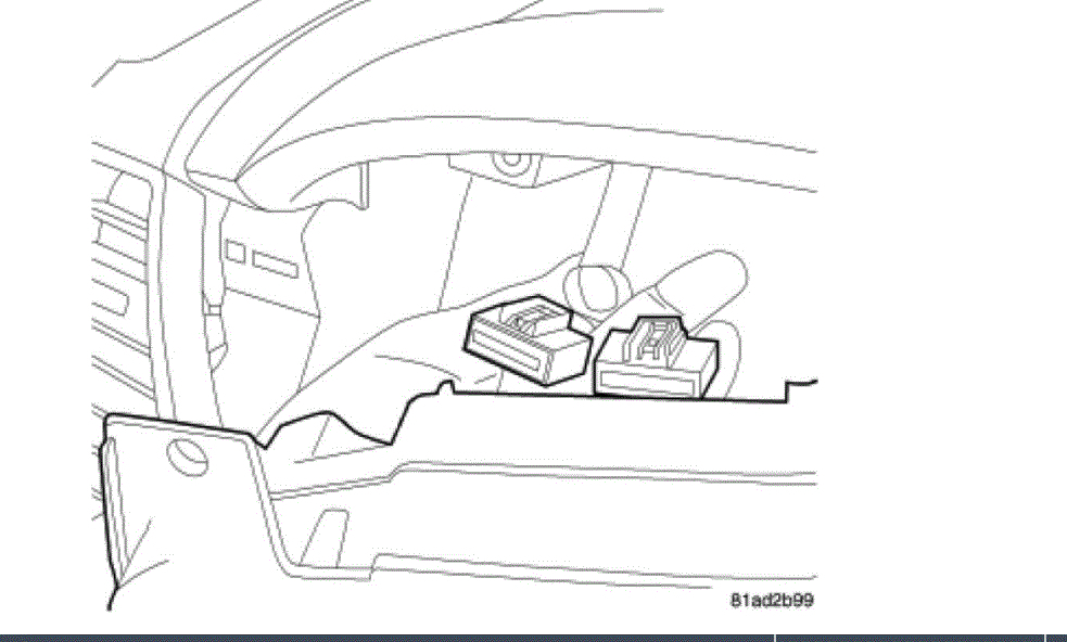

6. Disconnect two electrical connectors from the back of instrument cluster.

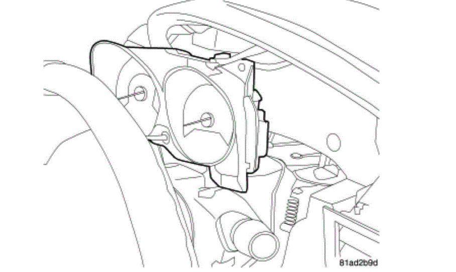

7. Relocate instrument cluster to the left.
8. Remove the two front mounting screws for ignition switch.
9. Remove one rear mounting screw and washer from ignition switch.
10. Use a thin screw driver and unclip ignition switch from mounting position. Push switch back to remove.
11. Push switch back and down to opening from knee bolster area.
