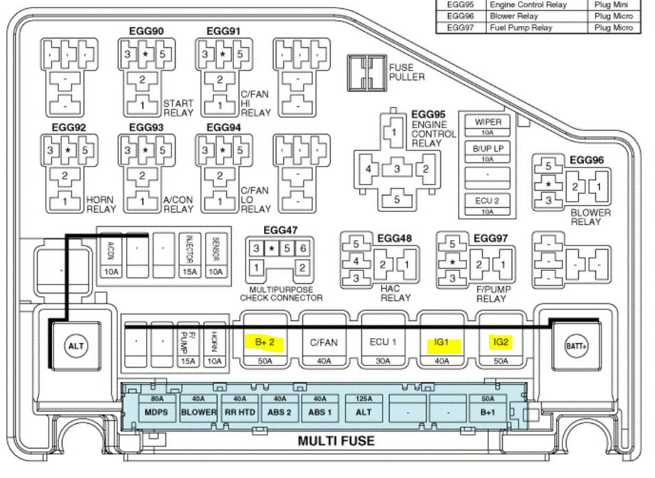

Do me a favor. I need you to check three fuses in the under-hood fuse box. The ign 1, ign 2, and the B+ 2 fuses.
These three fuses provide power to the ignition switch. which then powers the interior fuse box. Actually, the B+2 provides power to a portion of the interior fuse box all the time.
Do the same thing with these three fuses. Inspect the fuse and also confirm there is power to and from it.
Let me know what you find.
See pics below. Pic 2 shows the fuses to check in the under-hood fuse box.

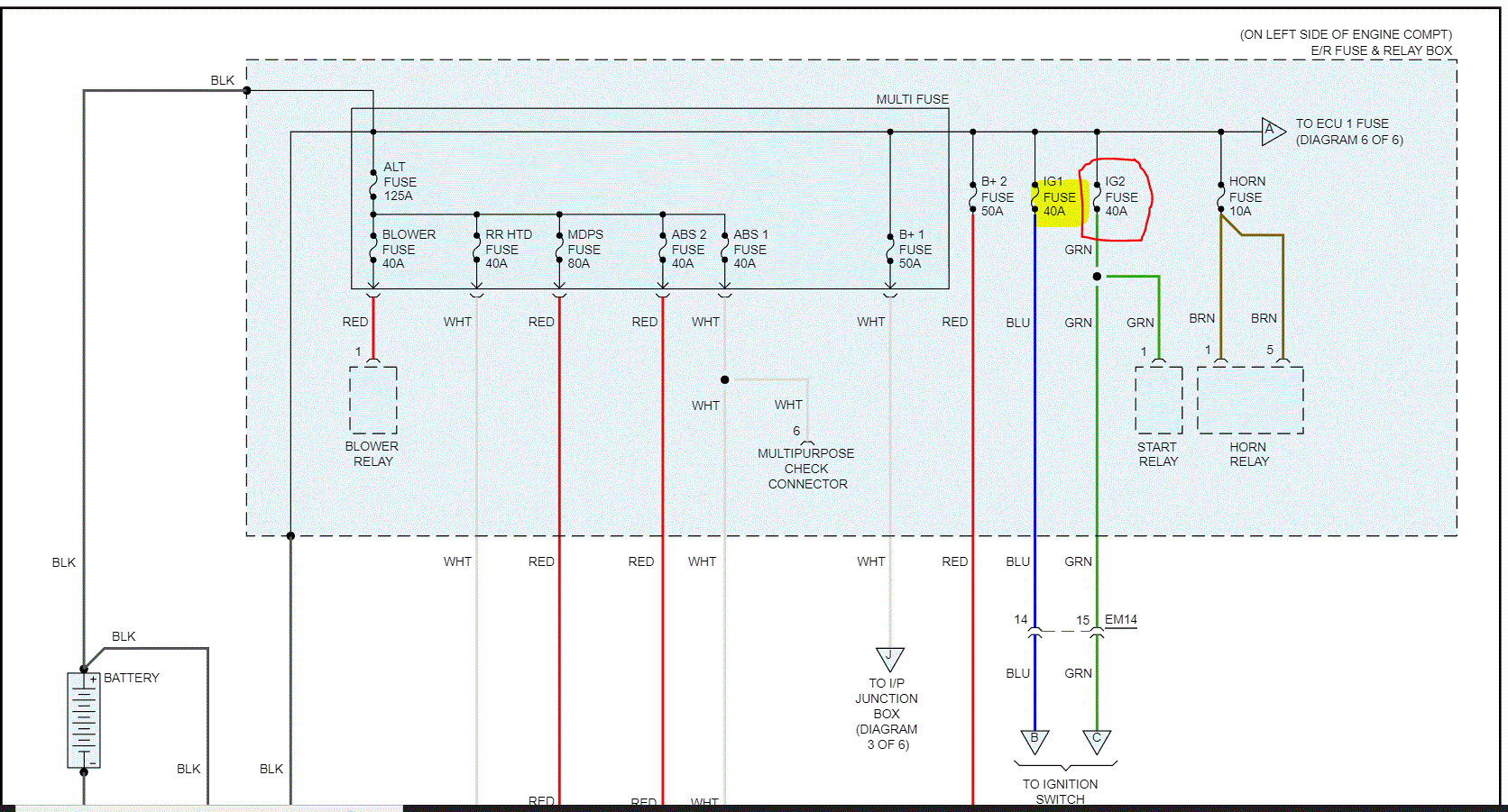

Okay. So, all three fuses are good and have power. I did notice that the diagram shows a 50-amp fuse for the IG2. However, the fuse that is in there is a 40 amp.

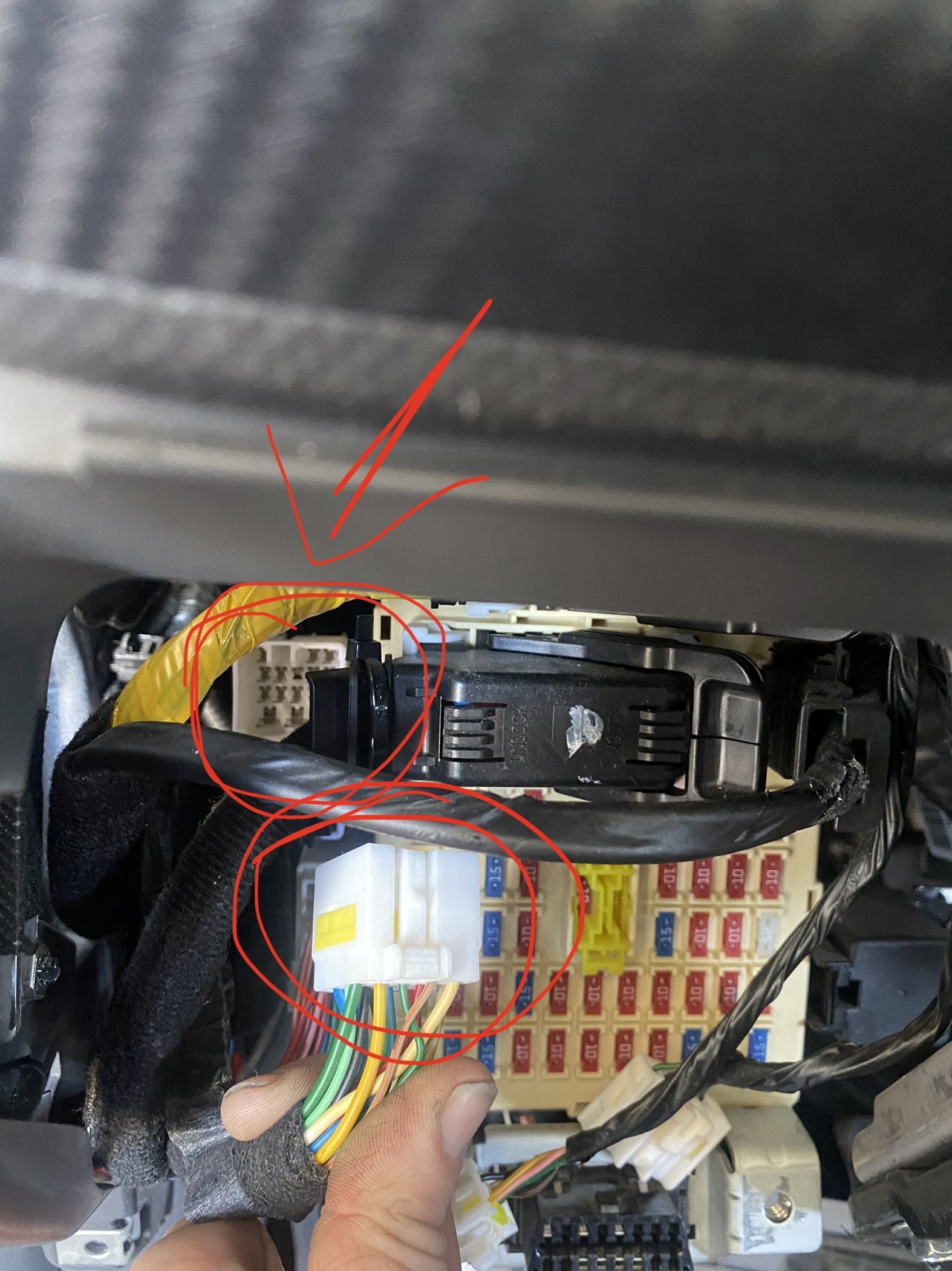

If the 40-amp fuse isn't failing, leave it. Now, since it starts normally when it cools off, I want you to try something. When it won't start, wiggle the relay and fuses to see if one makes a difference. Something may not be making good contact when it gets too hot. Keep in mind, that heat makes metal expand. I have a feeling that is what is happening.

The connection in my hand seems to be the culprit! . I barely touched it a few times and this recreated the problem I’ve been having
It doesn’t seem to be locking in place I can barely press on it, and it starts to fall out.
Jun 7, 2022 at 4:44 AM
  • 110,244 POSTS
Absolutely that can be the problem. It should snap into position. If it won't, closely inspect the pins inside each side and take notice if any seem bent or pushed inward.
If the connectors are all good and the clip is damaged, see if you can get a small zip tie around it to hold it closed and prevent it from coming apart.

Contacts are all good I use the screwdriver to push on it and clip it in place.
Just want to say thank you! And I am grateful for the service that this website provides! I think next time I am going to consult you guys first, lol because I literally didn’t need to spend a penny lesson learned $300.00 later, lol.
