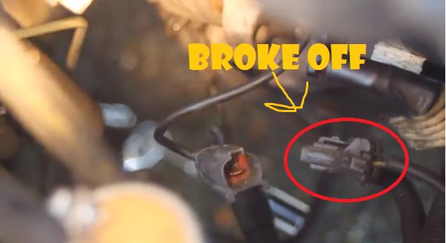

hey i need help , after i rebuilt my starter i took it to AutoZone to get tested , they said it was 100% working .. i came back to my car to find the wire that connects to the starter solenoid has busted off , i tried just putting it on anyway and no results .. i try to start it and it doesn't even crank .. i am close to giving up please help (its the wire from the body to the solenoid .) , this is really frustrating me , do you think i need to replace my whole wire harness ? no crank no start no click sound nothing , kinda sounds like electrical current the 1st few seconds i try to start it

go to the dealer and get anew connector tha tfits inside the old one and reconnect it to the wire. that's why your car won't start. it shouldn't cost you more than $5 for the part. it will need to be crimped on an dmake sure to put any weather pak connections on it.
