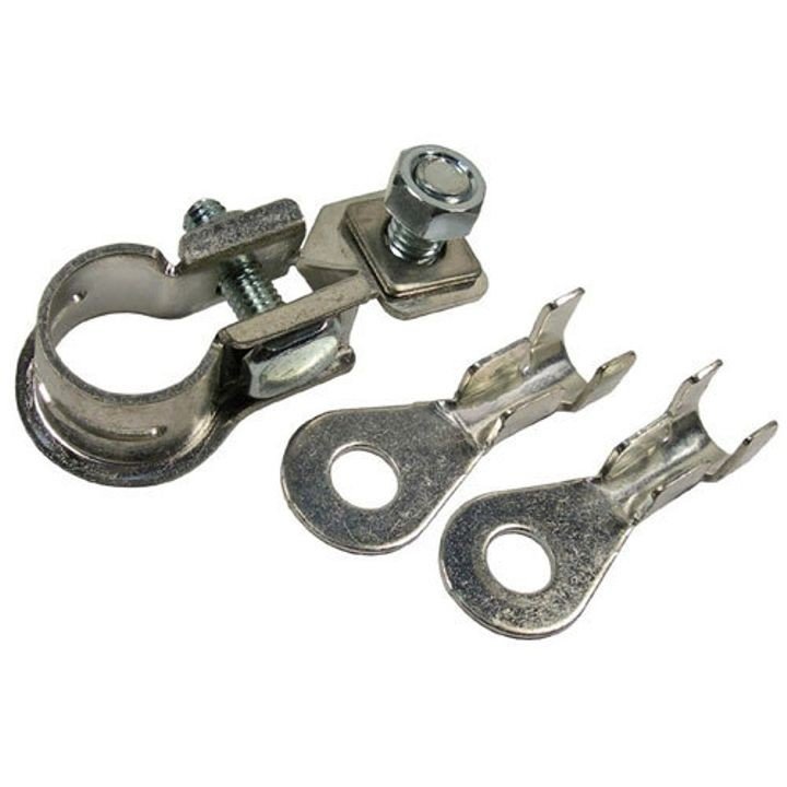

My car will have power but when I go to start it it will not even crank and I lose all power for hours.

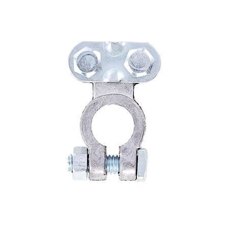

Hello. To me this sounds like either a loose connection somewhere or your battery has failed. If there's been a recent cold snap, that could cause the battery to fail. Your car has battery terminals that mount on top of the battery, aka top-mount terminals. A couple examples of those are in the attached images. Raise the hood and look at them. If you see any greenish whiteish gunk on them, clean it off using a cloth or something, and tighten the terminals as much as you can. A 10mm or 12mm wrench should take care of tightening the terminals.

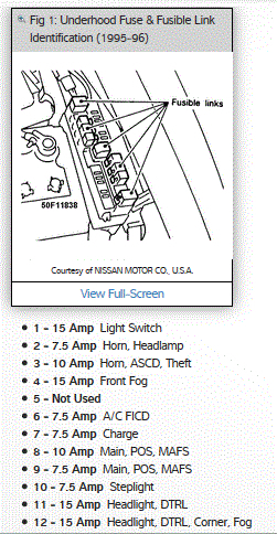

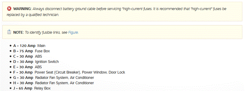

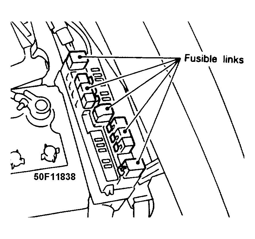

You can also try checking the fusible links, which are pictured in images 1 and 2 below, located under the hood of the car. Failed fusible links can cause all sorts of bad things to happen, and it's a common problem.
Finally, you might also look at the other fuses in the underhood fuse box, the layout is in image #3 below. In particular, look at fuses 7, 8, and 9. Check this guide out if you need some pointers on checking fuses: https://www.2carpros.com/articles/how-to-check-a-car-fuse
