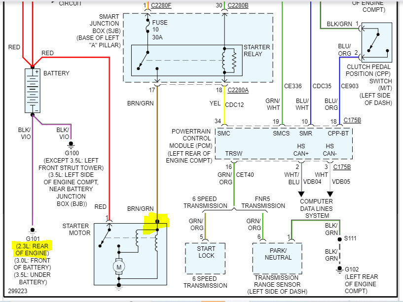

Hi there. The car listed above has trouble starting on hot sunny days. All I hear is a click. At night it starts with the first turn of the key. I’ve replaced the battery, the starter, and the smart junction box which contains the starter relay. I tested with a multimeter and whenever I turn the key and it doesn’t start there’s no voltage making it to the starter. I do the same test at night, and I get voltage to the starter, and vehicle starts.

First, I attached the wiring schematic below so that you have a reference. When it doesn't start, which wire on the starter isn't getting power? The larger gauge red should have power at all times. The smaller brown wire with a green tracer should only have power with the key in the start position.
I need to know which wire is being checked.

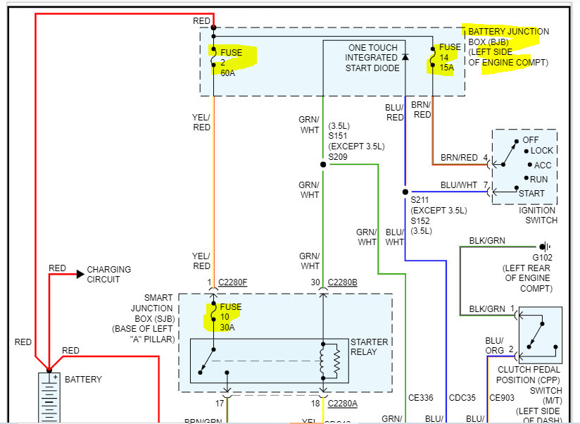

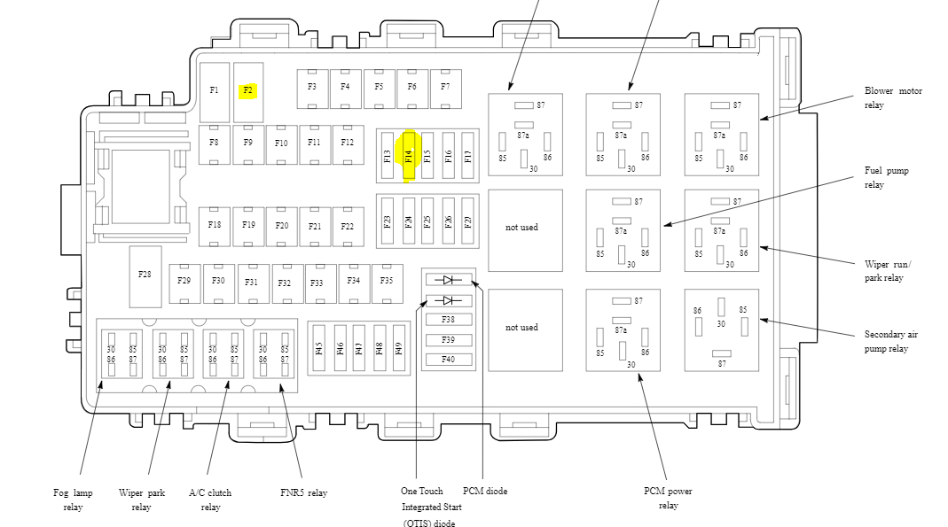

Also, heat causes metal to expand, so check fuses 2 (60amp) and fuse 14 (15amp) in the under-hood fuse box. Make sure both are clean, tight, and free of corrosion. Additionally, when it won't start, move those fuses around to see if it begins working.
Since you have already replaced the SJB, I will assume the relay and fuse there are both good.

Hey, thanks for the response! I’m going to check out those fuses tomorrow, but to answer your question, I was referring to the smaller brown wire. When I turn the key to start it doesn’t receive voltage and there’s just a click. When it cools down and I turn the key to start it does receive voltage and the vehicle starts up.

Just replaced the 2 fuses mentioned, and it’s still not starting.
