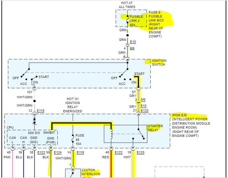

It sounds like you have a nightmare on your hands. The idea that it works and then it doesn't sound like either a switch issue or connector issue.
When it won't start, have you checked for power to the clutch safety switch? Power is provided to that switch via fuse 49 in the intelligent power distribution module (IPDM) under the hood. When the switch is closed, (clutch is depressed), power travels through the switch and seeks a ground via a CPU in the IPDM. So, at the switch (top of clutch pedal) check for power via a white wire with a green tracer. If that is present, depress the clutch and check for power out via a red wire.
If you have that, then we have power to the starter relay primary.
If there is no power, let me know where it is lost.

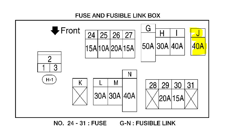

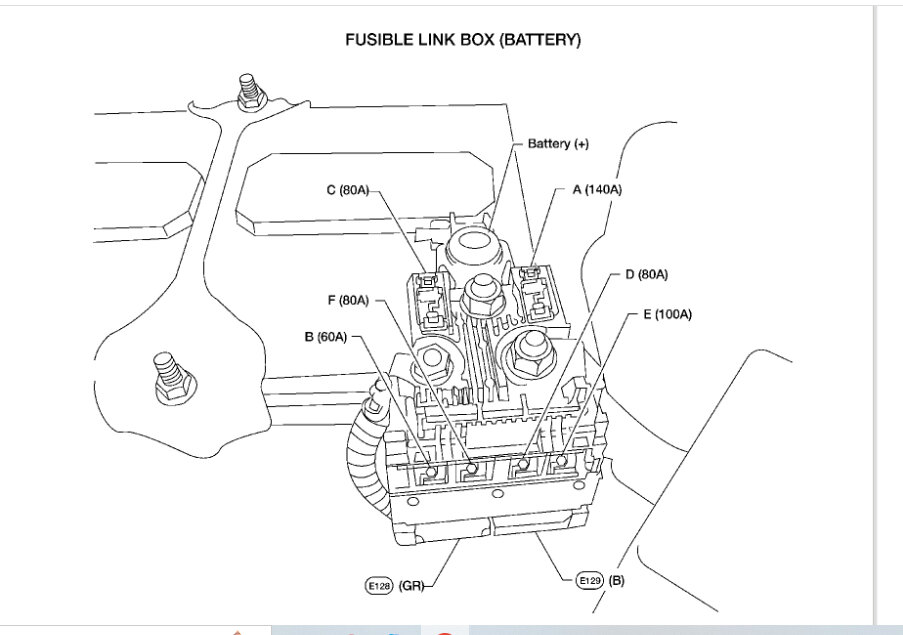

Next, there are two fusible links related to the circuit. Check fusible link J in the fusible link box (right rear of engine compartment). Make sure it is in good condition, not corroded, and is making good contact. If that is good, we need to check the fusible link in the battery fusible link box. Do the same there.
Do this and let me know what you find. Note that power between the battery and starter goes through the fusible link in the battery box. So, make sure it is good.

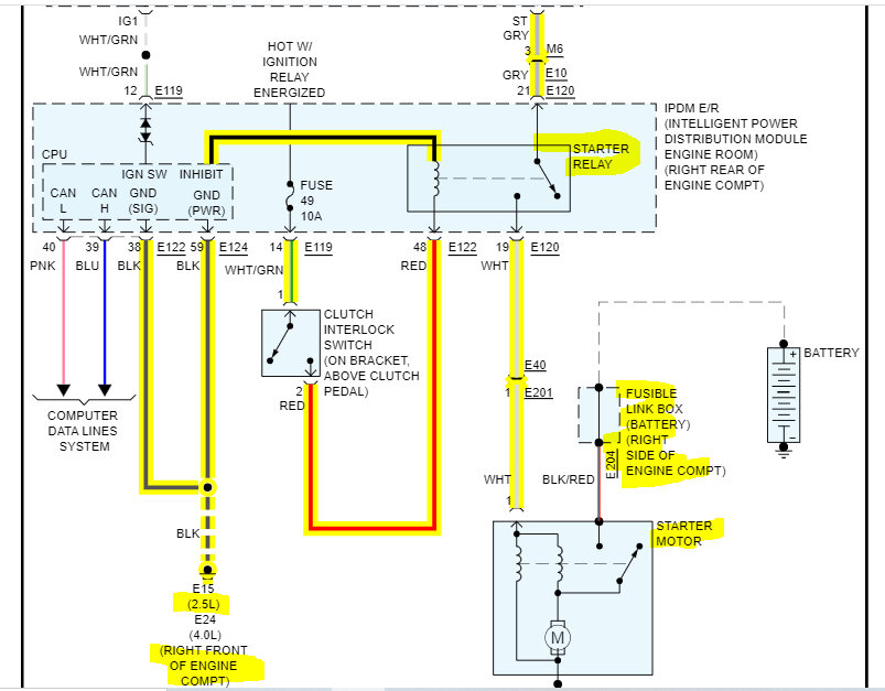

When it doesn't start, also confirm there is power to the larger gauge black wire with a red tracer at the starter motor. That should have B+ voltage at all times.
Let me know what you find or if you have questions. I attached the wiring schematic below for the starter circuit so that you would have a reference. I highlighted the wiring and components to check.
See pics below. Note: I had to cut the schematic in two to make it readable. I did overlap them so you can follow from one to the next.
