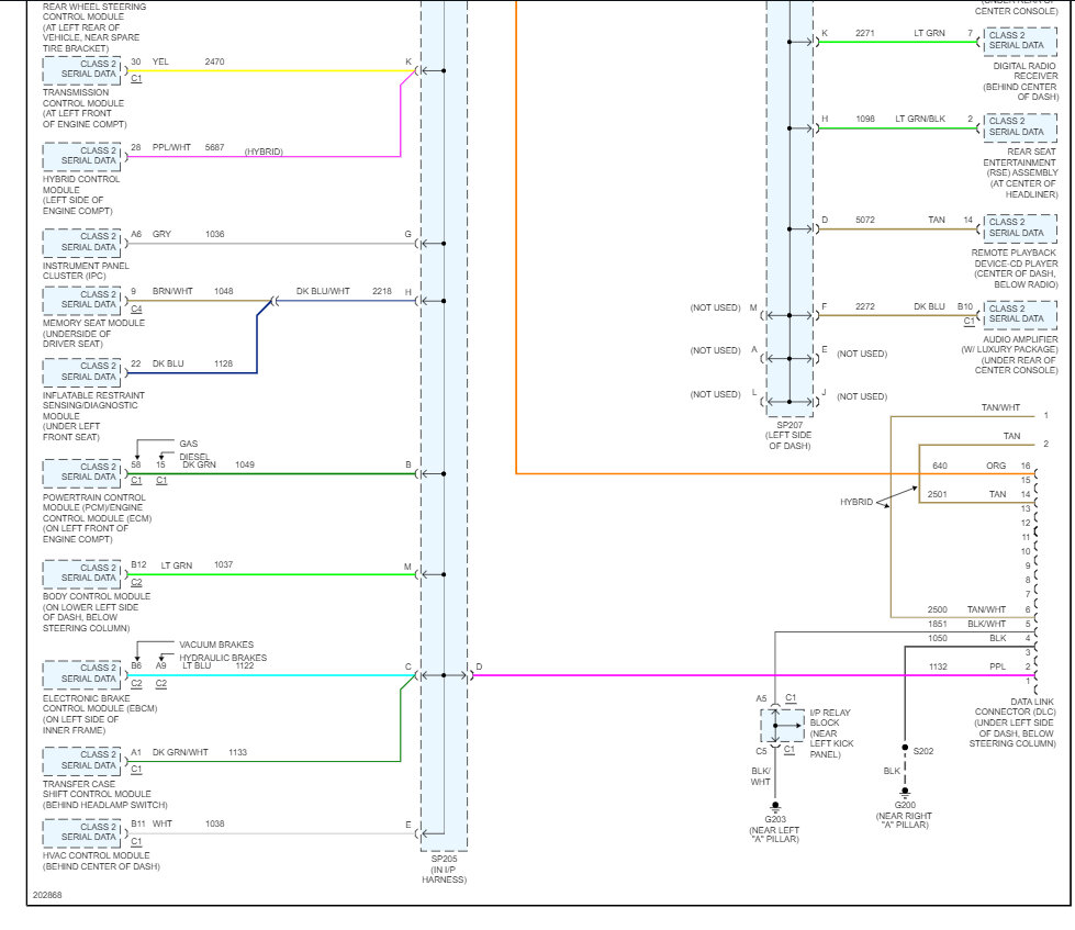

No crank, no start and no communication with the ECM?
165,000 MILES • 4.3L • V6 • 4WD • MANUAL
SHAGU2
If I disconnect the cable to the alternator battery control module I can talk to the BCM and do testing such as ABS testing.
Nov 20, 2022 at 10:15 PM
  • 55,464 POSTS

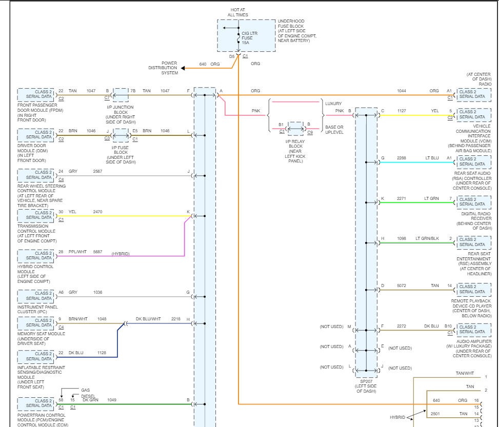

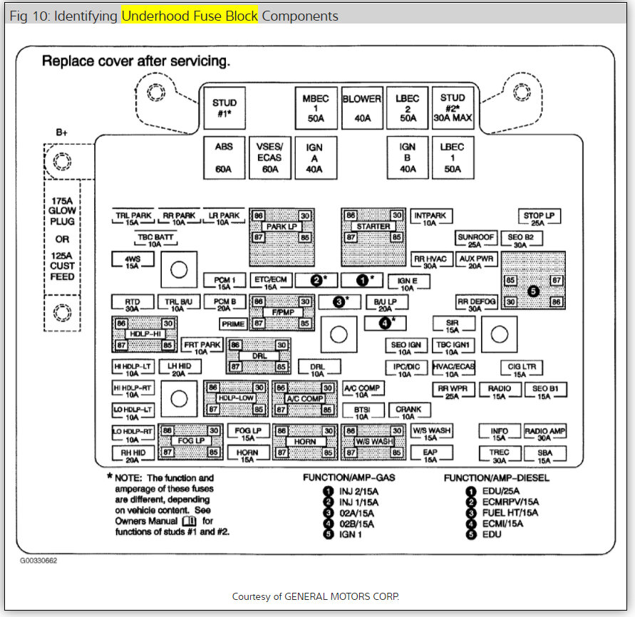

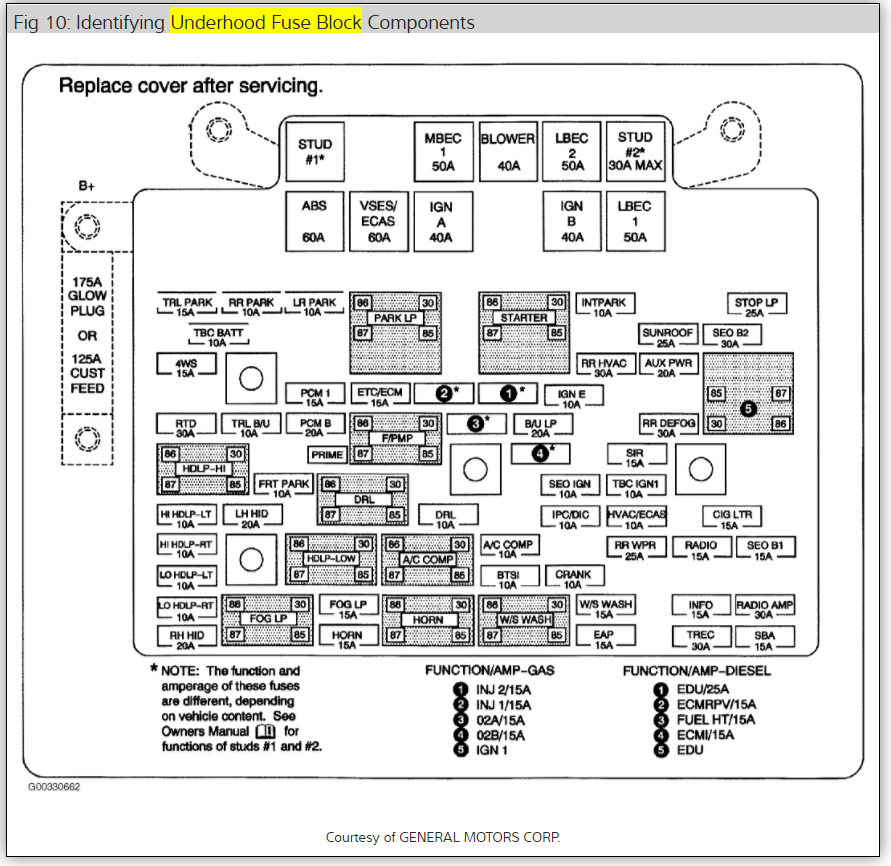

The first thing we need to do is check the cigarette fuse which powers the ALDL connector. Here is a guide that will help and the fuse location as well, also I have included the wiring diagrams so you can see how the system works.
If the fuse is okay, you might have a PCM that is out, let me know what you find. Check out the images (below).
