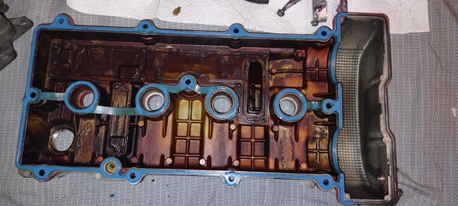

If you have 0 psi compression, it sounds like the timing is off and possibly bent valves. Did you upload a video of it cranking? It's not here.
If I recall, the 2.0 DOHC on this isn't an interference engine, so that is a good thing. What I suggest is to remove the valve cover so you can inspect the belt and if there are any issues with the cams.
Let me know. Pic 1 shows what I'm referring to and pic 2 shows the tightening sequence.

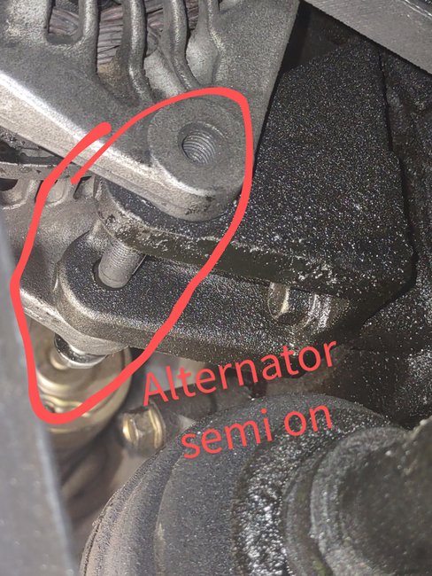

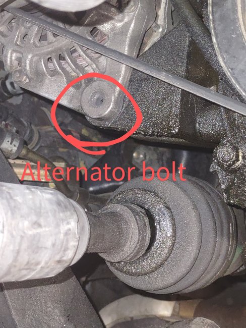

Hi Joe, happy 4th of July, long time no speak. I hope you're still with me. lol anyways since the last time I have worked on my car I do have some questions but first let me fill you in I took the spark plugs off and all that good stuff took the valve cover off I'm not sure what I'm supposed to be looking for on the cams to see if they are in good shape. I'll send a picture. I am confused maybe you can clarify on both cams there is a letter i and e on them both cams have both I and E on them is that suppose to be there. Sorry, I'm not too sure about that also I noticed a lot of oil sludge around the alternator and back of the oil pan and I noticed that the alternator bolt is half on half off. can that also play a part and why it wasn't starting? I'll send pictures of that too. I tried doing the bump start method to loosen the crank bolt however, it doesn't work. I'll send a video of that. I did notice the motor mount is broken, maybe that is the reason why the bump start method isn't working. Hopefully you can give me some pointers. Lastly, I did notice that the I and the e on the cams are very close so I try to move the crank a little to see if the I and the E would flush up together but before I did that, I noticed a lot of slack on top of the timing belt, is that a sign of something or is that normal? maybe you can elaborate on that. Anyway, I hope you're enjoying your 4th of July. I appreciate your help I really do thank you for your patience and your time and I hope to hear from you soon.

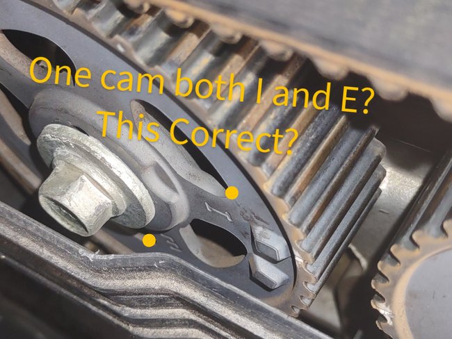

One last thing, while i have the car like this, do you have any suggestions on what i should be looking and or replacing other than what's been said? Does the crank have a gasket? Do i have to replace the crank bolt as well? I'm just making notes on the extra things that need to be replaced. Also, I'm curious and would like to know not just for what I'm currently working on, but anything related to this car so are there bolts, pulleys, gaskets tensioners etc. That can only be used once. Meaning since i removed things from its original place be a bolt, gasket, harmonic balancer, etc., does it have to be replaced if yes what are they? So, i can start familiarizing myself with them and i just don't want to have to take everything apart again. Lol

Now, the I and the E stand for intake and exhaust. It's identifying what each camshaft is for.
