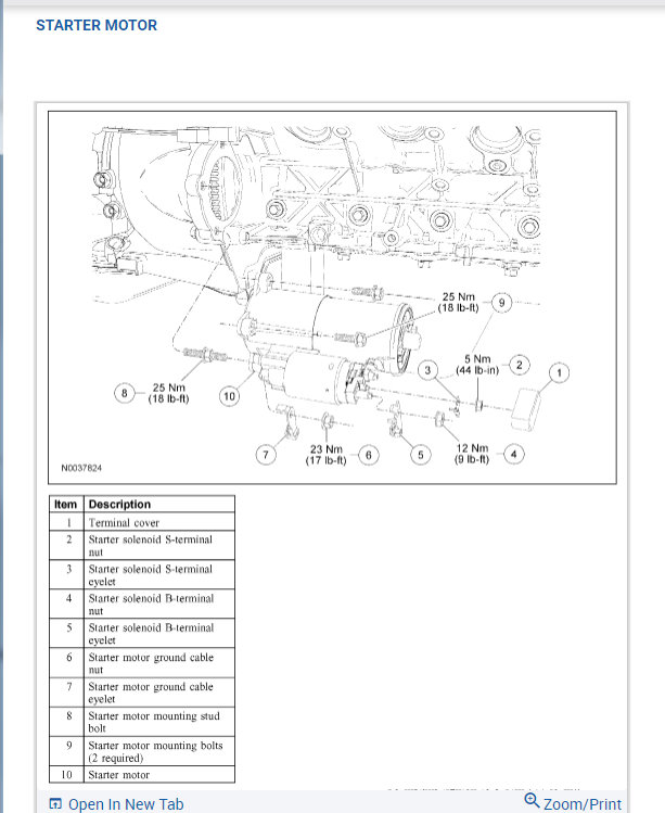

I had to change the flex plate and starter on my truck due to grinding of the starter due to flex plate teeth being worn down. I removed the starter pulled the transmission back and removed and replaced the flex plate and put everything back together and replaced the starter with a new one. Now when I go to start the truck it only clicks it will not crank or start at all. Can anybody please tell me why this occurring?

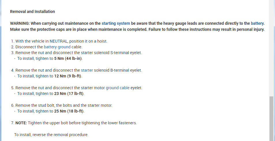

Here is a guide that will help with this. It sounds like you don' t need it but others that visit this page may.
Also, below are the instructions in case you or someone else needs these as well.
