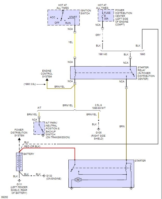

Hit pretty hard in front. Engine light came on. Next morning after driving for five miles lost all power. Would not restart. Lights work fan works windows work. Replaced ignition switch. Still the same.

Check the fuse B in the PDC under the hood, left side. If that is okay, put your finger tips on the starter relay and feel if it clicks once when the key is turned to start.

There is no clicking anywhere. where is fuse?

in the PDC (power distribution center) under the hood, left side.
