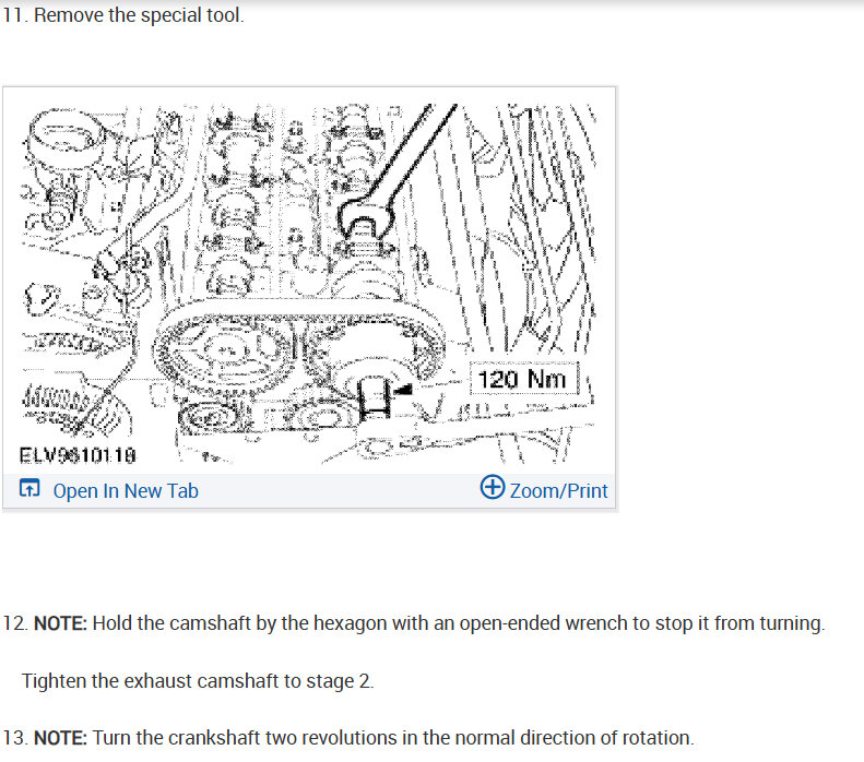

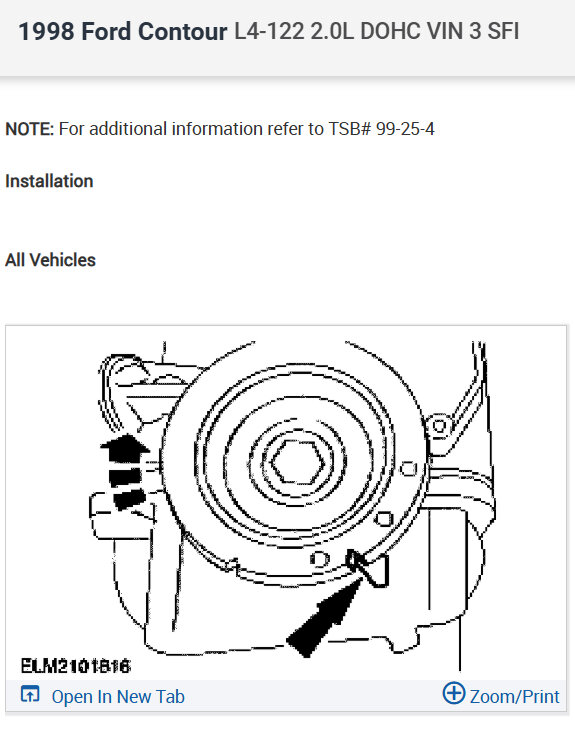

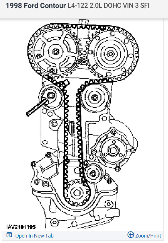

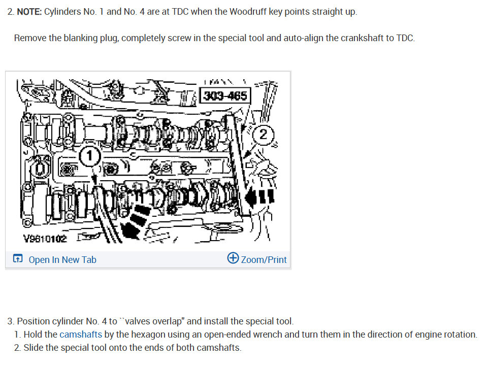

Yep, that timing belt is no good. The 1998 Ford Contour 2.0L 4-cylinder engine (Zetec DOHC) is a non-interference engine. So, I would replace the timing belt, and you should be okay. Clear the codes once complete, here are the timing marks for clarity. You will need a special camshaft alignment tool to do the job FYI. Check out the images (below). Let us know if you need anything else. Thanks for the video, it helps.
