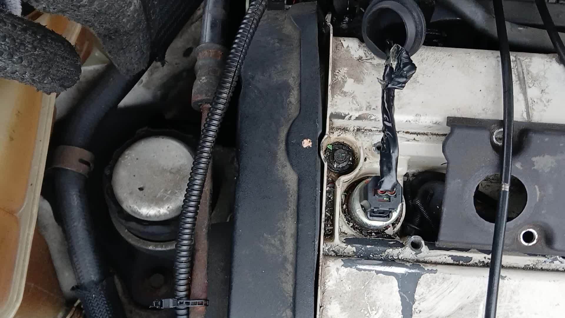

I changed the spark plugs and wires, ignition coil, I have not done a fuel test to check for pressure. Some people say you can open the oil reservoir cap, crank the engine and if you see something spinning your belt is not broken? Not sure if that is true. But I will check the camshaft position sensor and crankshaft sensor. I also need the correct firing order because I think the spark plug wires are wrongly hooked up. Another concern, a mechanic shop told me his computer system said my motor is an interference motor, but I searched on the internet and everywhere is saying that my motor is a non-interference motor.

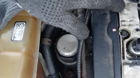

So i did some more investigating and decided to try to check the belt and noticed that it was loose, and it had cracks in the belt, not being a mechanic, I'm possibly sure the belt is too loose. My opinion. It might have slipped or was slipping off the pullies. I think I found out why I was getting a crank but no start.

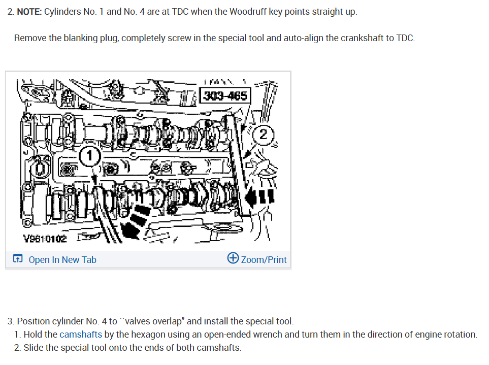

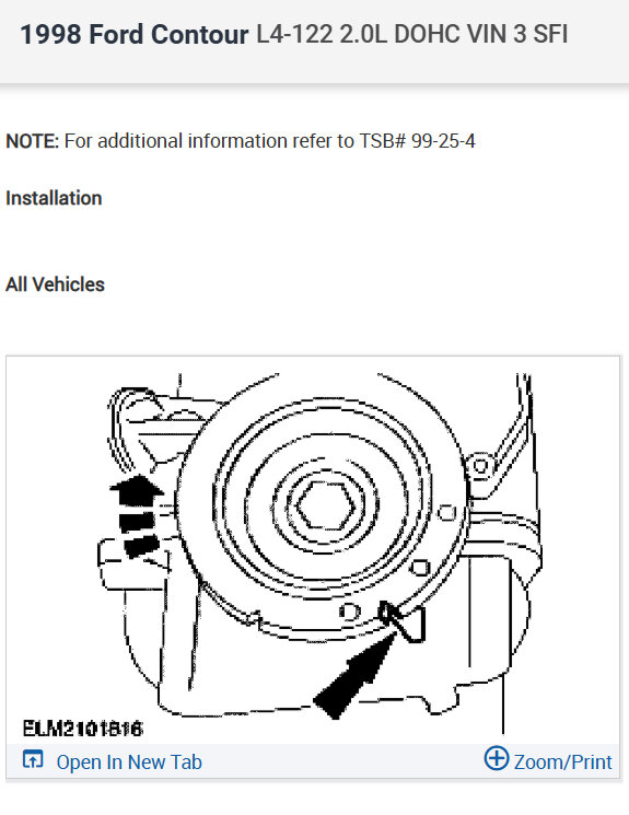

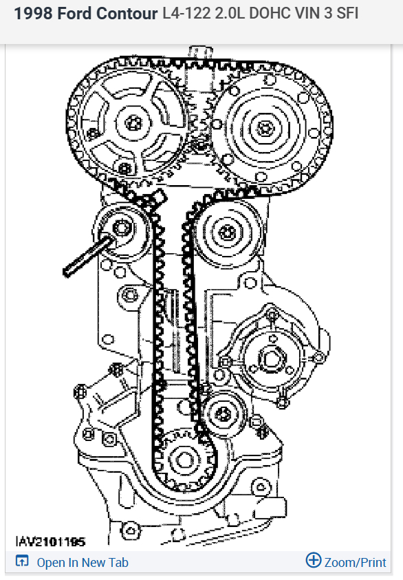

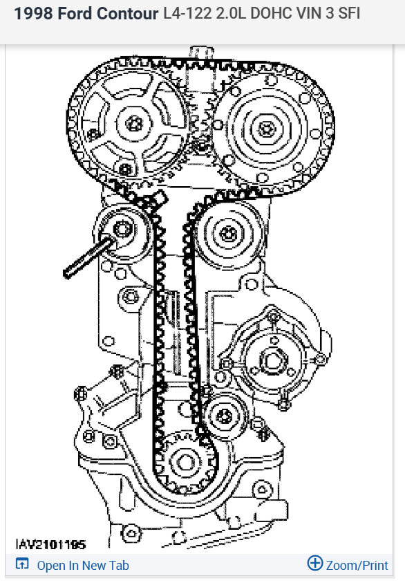

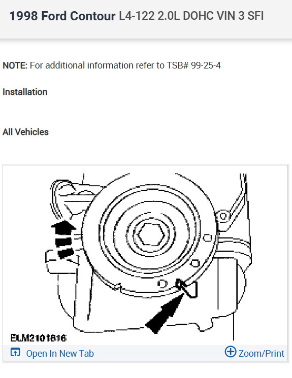

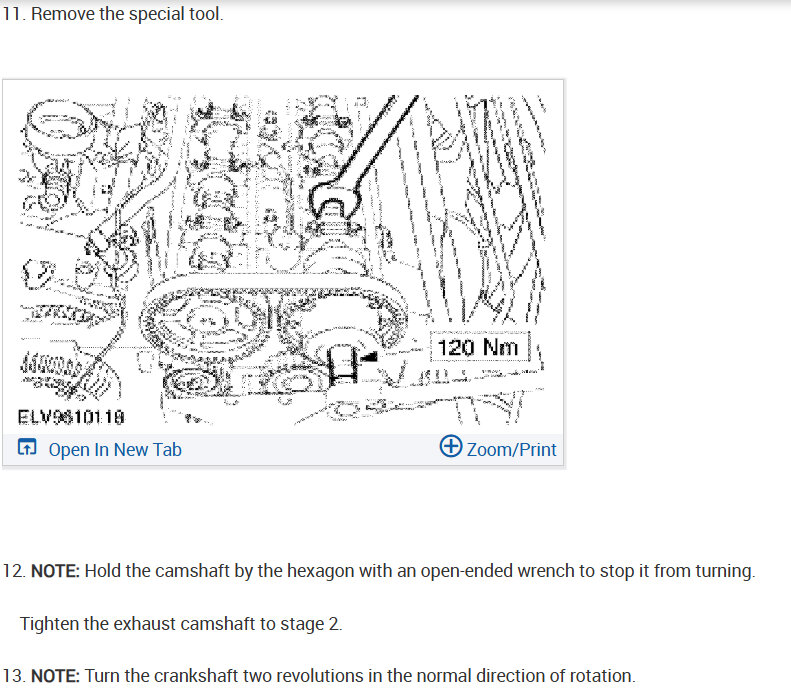

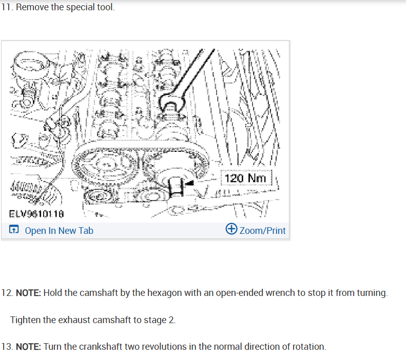

Yep, that timing belt is no good. The 1998 Ford Contour 2.0L 4-cylinder engine (Zetec DOHC) is a non-interference engine. So, I would replace the timing belt, and you should be okay. Clear the codes once complete, here are the timing marks for clarity. You will need a special camshaft alignment tool to do the job FYI. Check out the images (below). Let us know if you need anything else. Thanks for the video, it helps.
