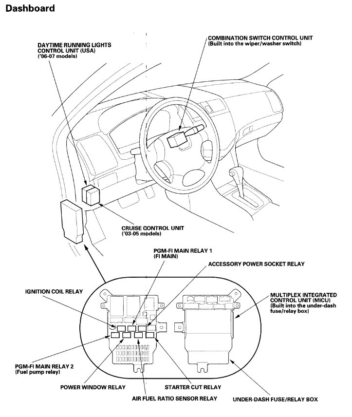

Now no crank, no start. Click under dash when key is turned. Battery is good
2007 HONDA ACCORD
310,000 MILES • 2.4L • 4 CYL • 2WD • AUTOMATIC
STEVEN73
First I was rear-ended banged up trunk lid, then radio would randomly stop working for a few days, come on for a few weeks, then stop again. The blower on A/C would stop working randomly. Now no crank, no start. Click under dash when key is turned. Battery is good.

There is a starter relay that is located under the dash on the driver side.
Since you are getting click to the relay, that means you are getting power to the relay.
On the lower left side you will see a fuse panel.
The starter relay is located in that panel (see diagram below).

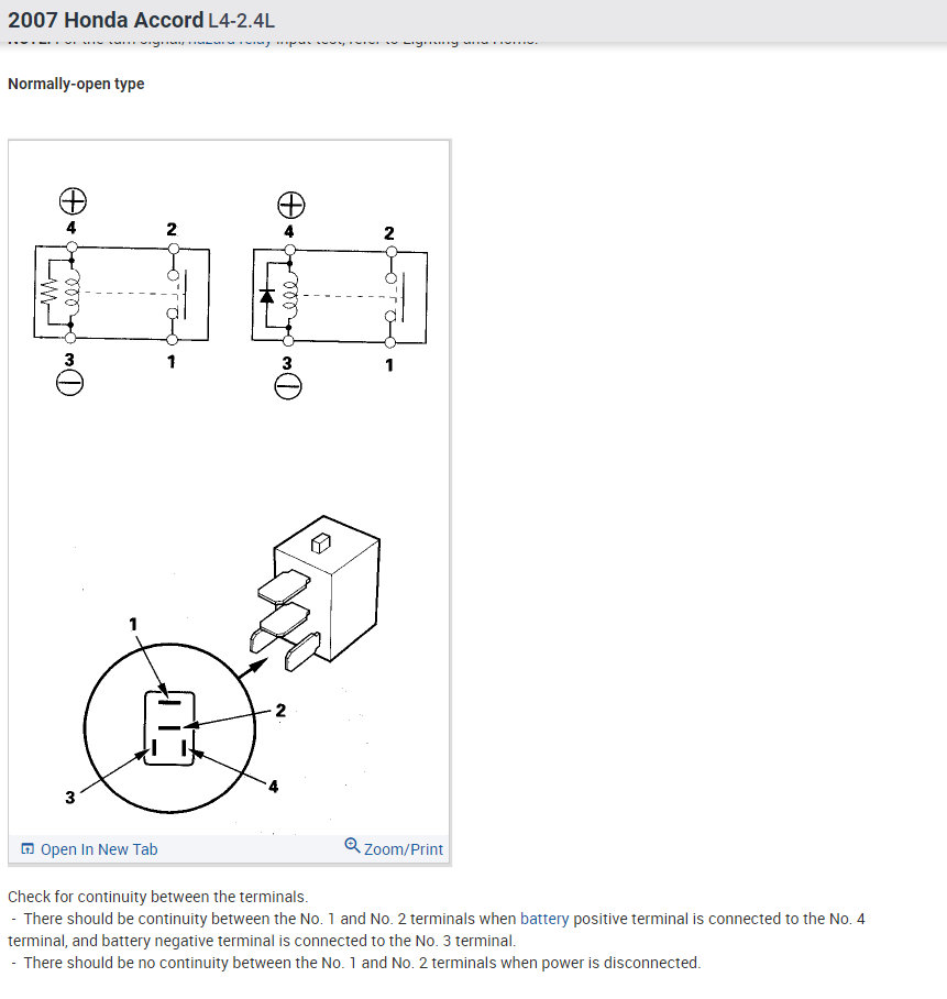

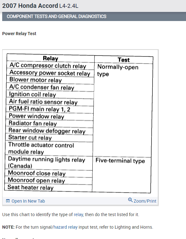

Test that relay to see if it is good.
I have attached the relay testing procedure as well.
