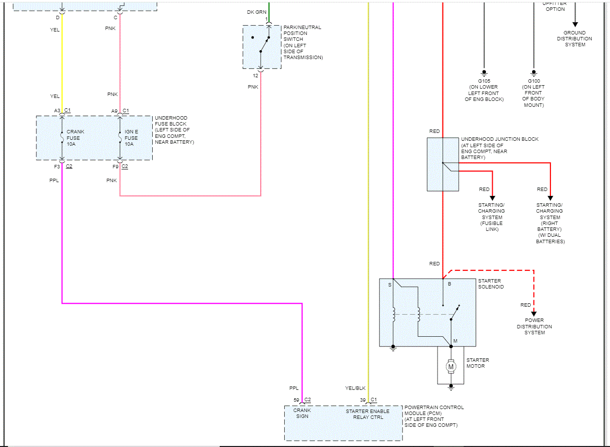

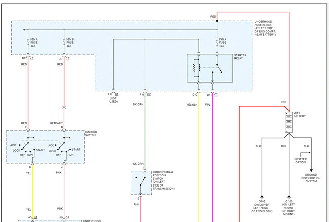

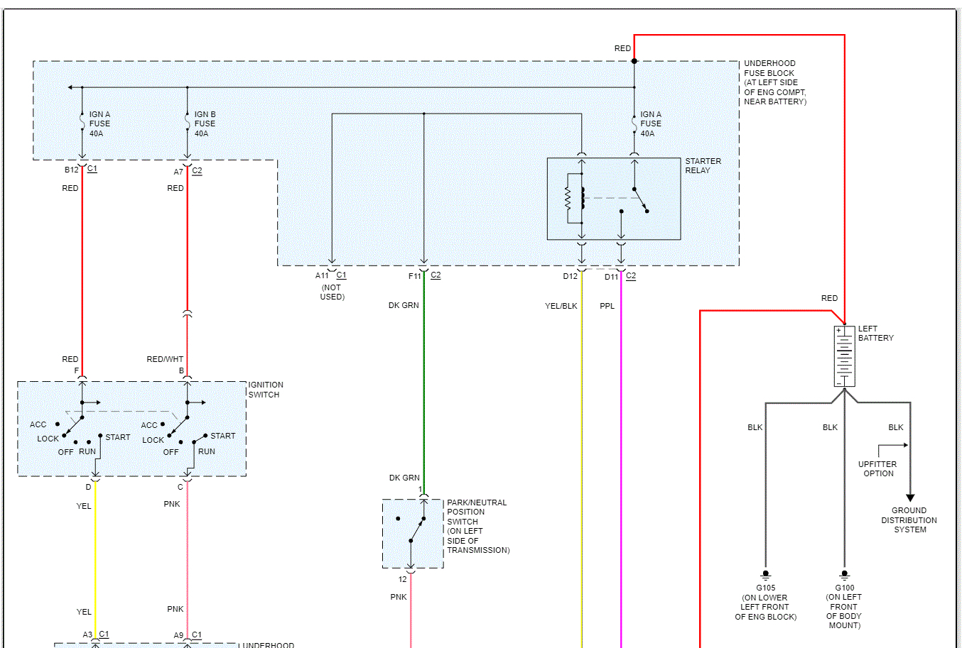

Okay, so, the vehicle listed above is a z71 flex fuel. I’m having a no crank, no start, no click issue. It has a new starter, a new ignition switch and a new 40-amp ignition fuse. When it’s doing this if I go key on and jump the starter to start the truck, I get a p0758 transmission code for the 2-3 shift. The other thing that happens is the blower will not work. It is very odd. It’s been to the dealer they said faulty ignition switch and a blown 40-amp fuse worked for a few starts and now I’m having the same problem again.

Do you know if it is the 40-amp ignition fuse A or B? I need to know that so I can trace things.
The idea that the blower doesn't work almost sounds like a faulty ignition switch. Since it is new, the next guess would be a faulty connection.
Take a look through the wiring schematics below for the starting circuit. I'm adding it so you have a reference. Let me know what fuse it is so I can go further into the schematics.
