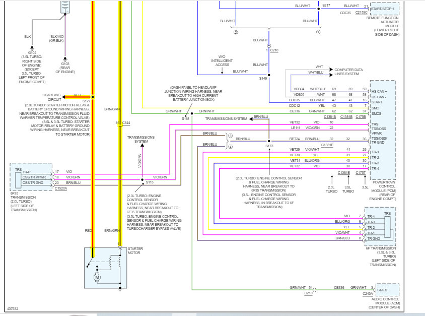

No crank no start?
2014 FORD TAURUS
172,000 MILES • 3.5L • V6 • 2WD • AUTOMATIC
BOSTONJ93
Power to some of the fuses in box. Car won't start.

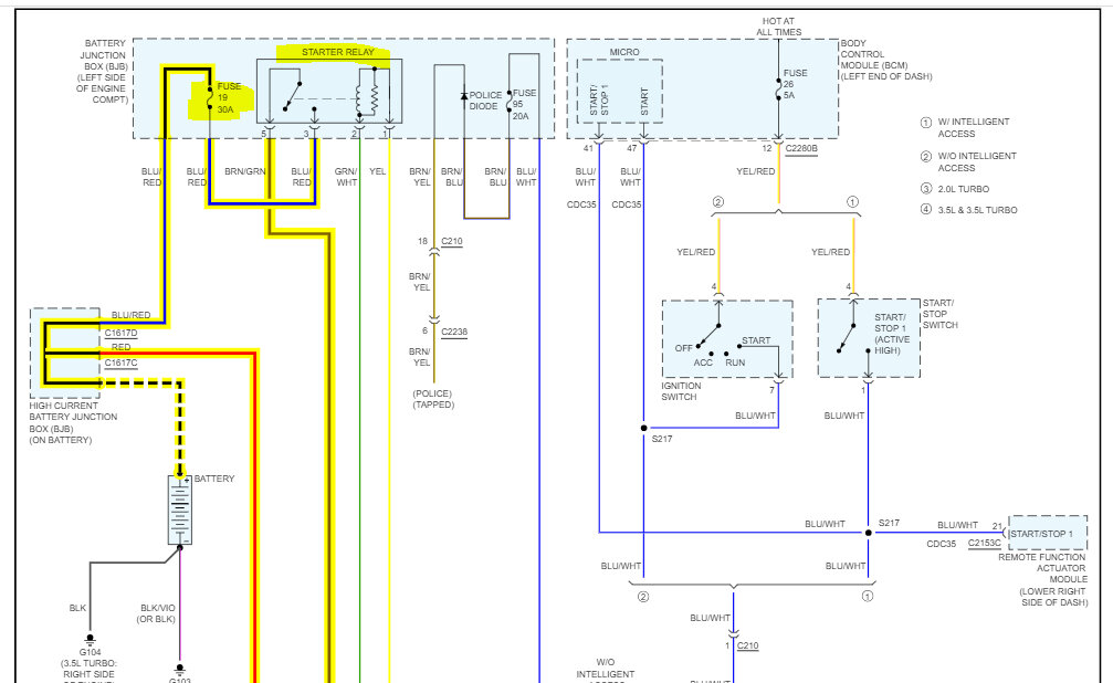

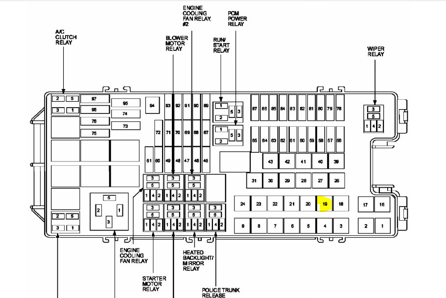

Since the starter isn't engaging, I attached the starter wiring schematic below, so you have a reference. I highlighted primary wiring. The first thing I need to know is if 19 in the battery junction box (under the hood) is good and has power to and from it.
Also, here is a link you may find helpful:
Note: Pics 1 and 2 below are from one page. I had to cut it in half to make it readable for you. I did overlap them so you can follow from one to the next. Additionally. pic 3 shows the fuse location (fuse 19)
Let me know what you find.
