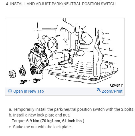

When in park the reverse light is slightly and the car no crank no start. Replaced neutral safety switch.
Mar 16, 2023 at 4:02 PM
  • 110,194 POSTS

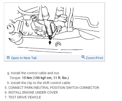

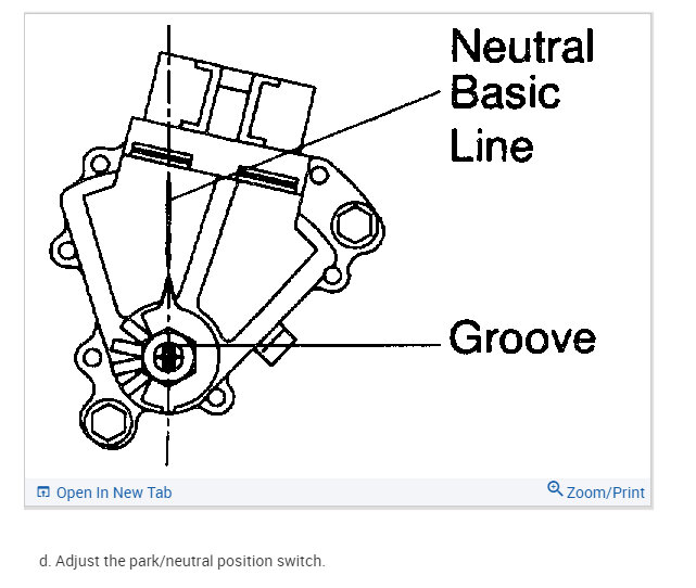

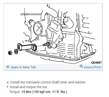

It sounds like the park/neutral switch is out of adjustment. Do me a favor. I realize you replaced the transmission position switch. However, it needs proper adjustment for it to properly function.
Take a look at the adjustment procedure below and let me know if this is what you did. If not, follow the procedure and let me know if it helps.
See pic below.
