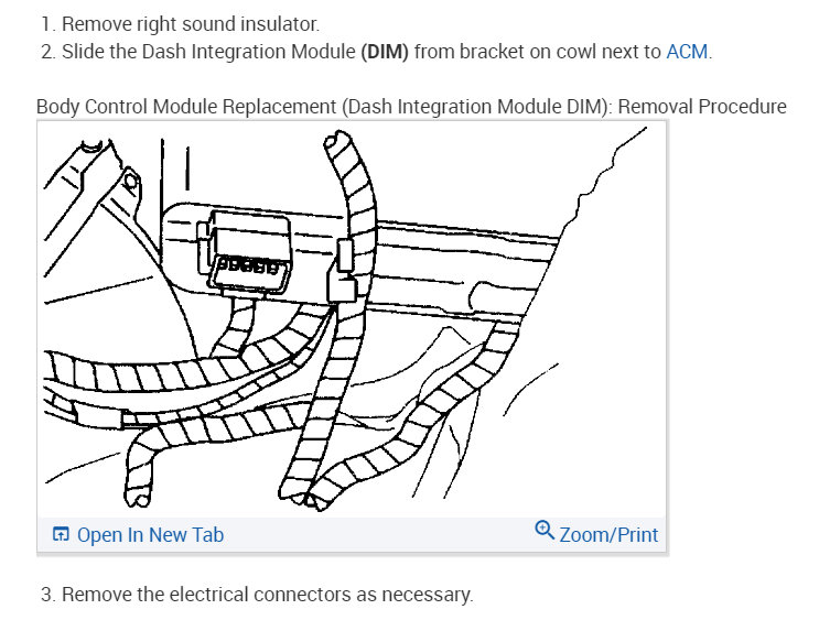

When I turn the key over everything comes on. No codes are being offered in the diagnosis. However, when pushed into the start position my dashboard goes blank. I don't want to have to replace the ignition if I don't have to. Also, curious if this is a case of needing to reprogram the keys, which would make super happy. That seems to be an easy process.
Also, the local pick and pull has an ignition that has all of the keys with it. The man that run the place said if I pulled the Body Control Module with it, I wouldn't have to do any reprograming at the dealership. Does that sound right?

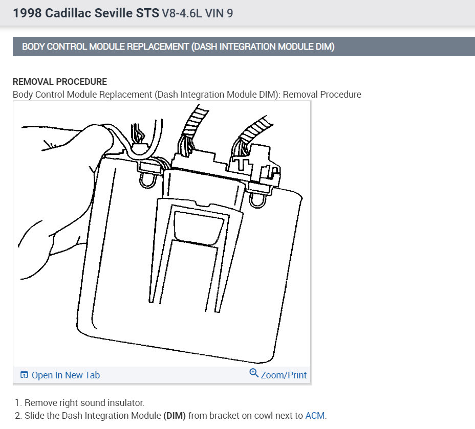

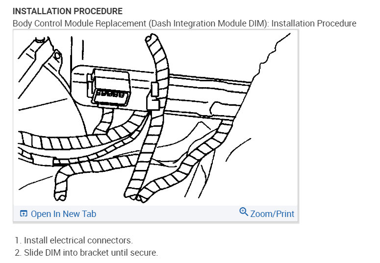

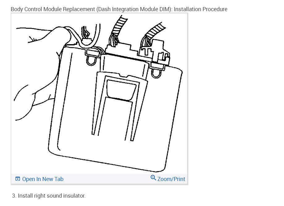

Do you have a security light flashing when you try to crank it over? If not, it sounds like the dash integration module (BCM) is not working. Here is the location of the module so you can check it out and replace it. Here is the location and how to replace it in the diagrams below. Check out the diagrams (below). Let us know what happens and please upload pictures or videos of the problem.

As a matter of a fact the dash does go black when attempting to start. I have misplaced my fob and tried to use the valet key to start it.
