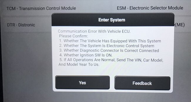

Engine ECM is not communicating with scanner. All other modules show on scanner. No voltage at starter relay. ECM was sent out and found software failure and corrected and reinstalled. Front sam check good on scanner. New battery installed. All fuses and relays check good. Need wire diagram for ECM connectors and what pins to check voltage. Thinking ECM is not getting voltage input.

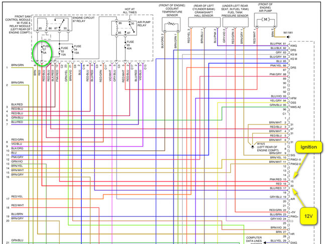

On the ECM you have 2 connectors.
C1 - 96 pin
C2 - 58 pin
Pin out at connector C2.
Pin 3, red/blue wire ignition 12V from fuse F53(15A) in front SAM
Pin 5, red/blue wire ignition 12V from fuse F53(15A) in front SAM
Pin 16, red wire constant 12V from fuse F57(5A) in front SAM
Also check your grounds at pins 2, 4, 6, brown/white wires.
Diagnostic wire, blue/yellow, comes from pin 29 to OBD connector pin 7.
See image below for 12V and ground wires.
Cheers, Boris

I’m assuming these tests are done with ECM removed. If so, I removed ECM and check pin 16 and has 12v constant. Pin 3 and 5 have no volts and fuse 53 no volts with key on position. Pins 2,4,6 have good ground. Pin 29 to pin 7 is good ohms. I replaced relays for circuit 15 and 87, still the same.

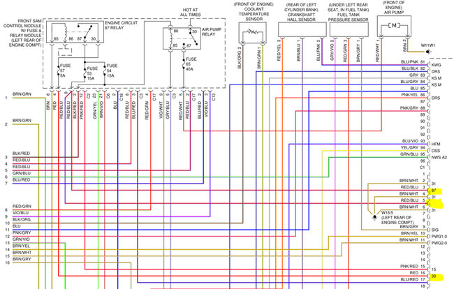

The ECM needs to be plugged in to activate the engine circuit relay 87, if ECM unplugged fuse F53 will not be energized.
ECM on connector C2 pin 27 outputs a ground on brown wire to front SAM pin 8, connector C2. This in turn will switch relay to output 12V to fuse F53.
Also fuse F53 needs to be live to energize the starter relay, see image below.
I had to separate wiring diagram for display purposes.
Cheers, Boris

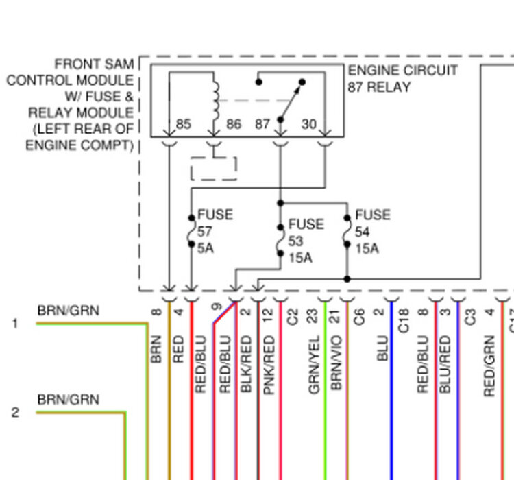

BORIS K
  • 836 POSTS
As fuse F53 is supplied by relay 87 you will only require the ignition to be on.
Suggest checking that the ECM switches a ground out at pin 27 to the front SAM at pin 8, connector C2.
See image below.
Cheers, Boris

On ECM connector C2.
Pin 15, pink/red wire 12V ignition from front SAM pin 12, connector C2.
Pin 16, red wire constant 12V from front SAM pin 4, connector C2, fuse F57(5A).
On diagram terminal 15 is ignition, 30 is constant 12V, 31 is ground.
See image below.
Cheers, Boris

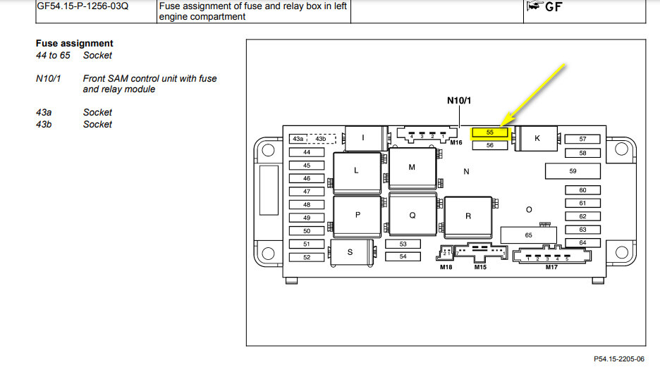

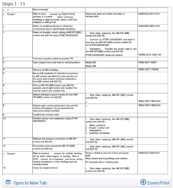

Fuse 55 in front SAM controls several different outputs.
See illustrations below.
Picture 3 shows description and front SAM connector and pin description.
Connector 21 and 9, as illustrated in image 1.
Cheers, Boris

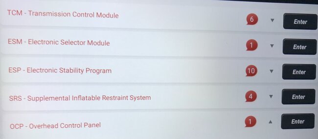

Lets run the codes to see if any are stored.
This guide can help:
Also, does the security light flash when the engine is cranking? If so, the system is enabled and needs to be reset.

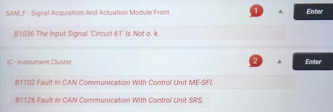

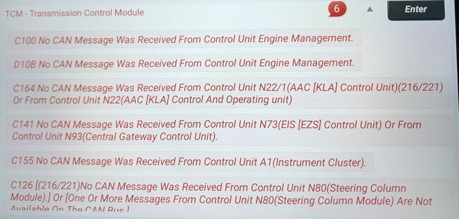

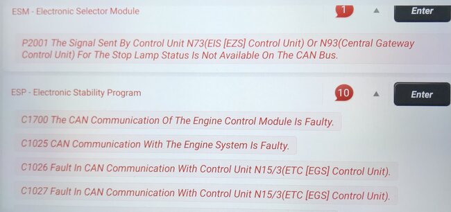

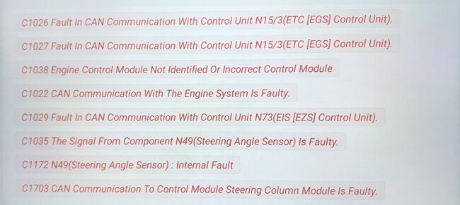

  • 55,381 POSTS
Can you post all of the codes please?
Apr 6, 2024 at 4:05 AM
HAL1958
  • 89 POSTS
Here are the codes below.
Apr 8, 2024 at 3:42 AM
  • 55,381 POSTS
Can I ask if this car was water damaged? Most of these codes are showing the engine control unit not working which can cause the additional codes. Let's get a rebuilt preprogrammed unit by searching google or ebay. Here is how to change the unit out. Check out the images (below). Let us know how it goes.

As previously discussed, fuse F53, as well as fuse F54, is supplied by Engine circuit 87 relay.
See image 1 below.
This relay is switched by a ground trigger on terminal 85.
This switched ground is supplied at pin 8 of connector C2 at the front SAM on a brown wire
The ECM is supplying the switched ground from pin 27 at connector C2(small 58 pin.
When bridging the starter relay terminals 30+87 are connected.
See image 2 below.
Terminal 30 is supplied by the Ignition circuit 15 relay and not by fuse F53.

I was notified that the ECM cannot be cloned due to not communicating. I need to send in the EIS module for cloning to rebuild ECM. Can you send me information on how to remove EIS module? Thanks.
Apr 14, 2024 at 6:05 AM
HAL1958
  • 89 POSTS
Can you send me information on how to remove EIS module ? Thanks.
Apr 17, 2024 at 9:08 AM
HAL1958
  • 89 POSTS
I figured out how to remove EIS myself since I wasn’t getting a reply. The rebuild ECM fixed my problem of no crank no start. Everything is working properly now.
