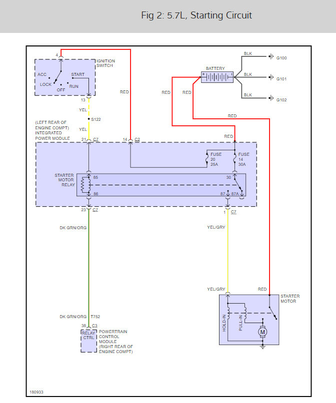

with key on i get lights but no crank. i can turn key on of off and take the top off starter relay and crank from there but still no start. replaced ignition and no change. drove it home and next day this is what i have

Can I ask if the security light is flashing? Here is a guide to help us get started walking you through the steps to fix the problem with the starter wiring diagrams so you can see how the system works.
Check out the diagrams (Below). Please let us know what you find. We are interested to see what it is.
