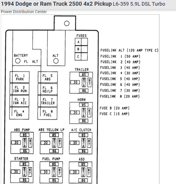

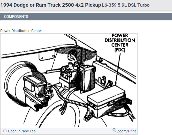

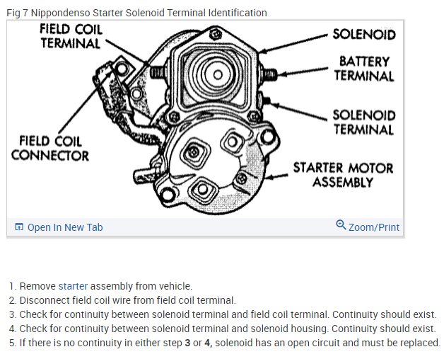

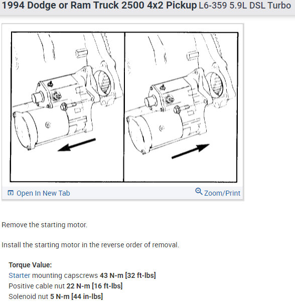

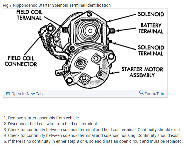

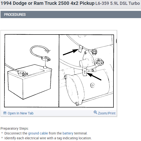

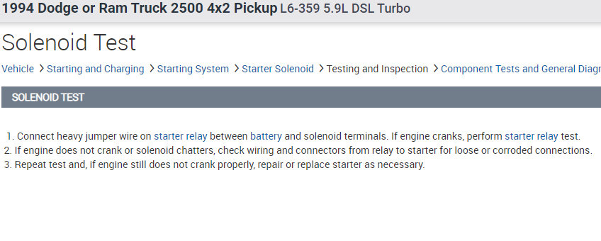

5.9 diesel will only start when I cross starter with a screwdriver battery's are new 1 year plenty of juice in the battery's just wont start like if it was in gear which it is not
Tuesday, February 16th, 2010 AT 3:57 PM
SQM
  • 6,383 POSTS

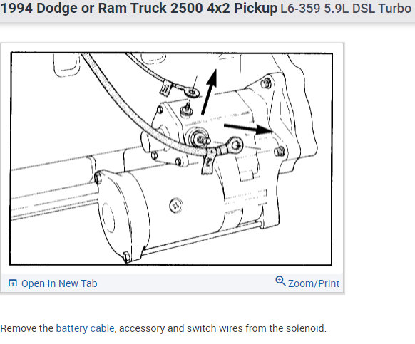

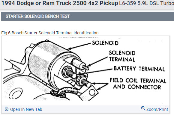

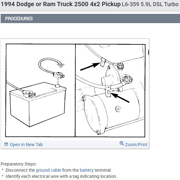

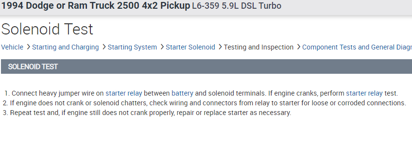

It sounds like you have a faulty solenoid or relay.
You might find this article helpful:
I have attached procedures of how to check the solenoid and the relay as well as the starter replacement procedure.
Any questions please let me know.
