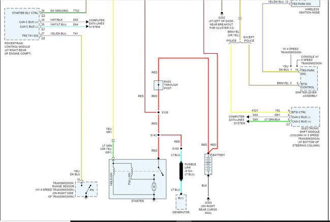

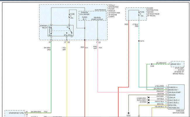

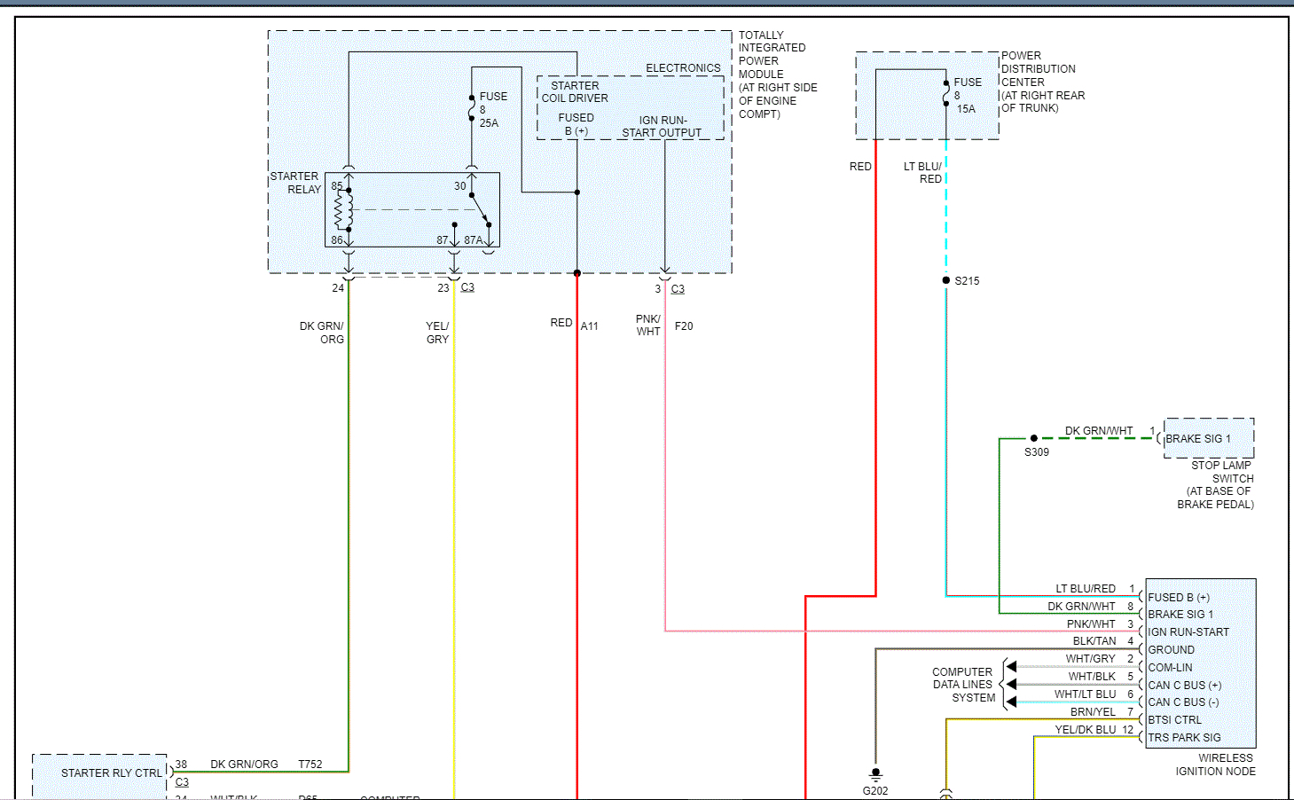

Let's dig into this a bit. Did you check to see if it will start in neutral? Also, if you look below, I attached the schematic for the starting system. I had to cut it in half to make it readable for you, but I did overlap the two.

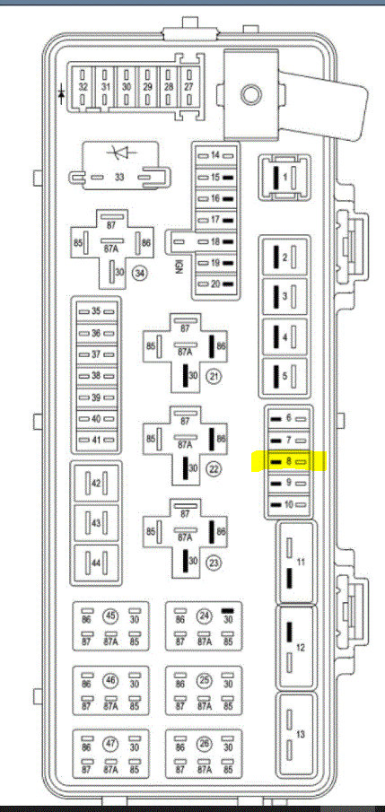

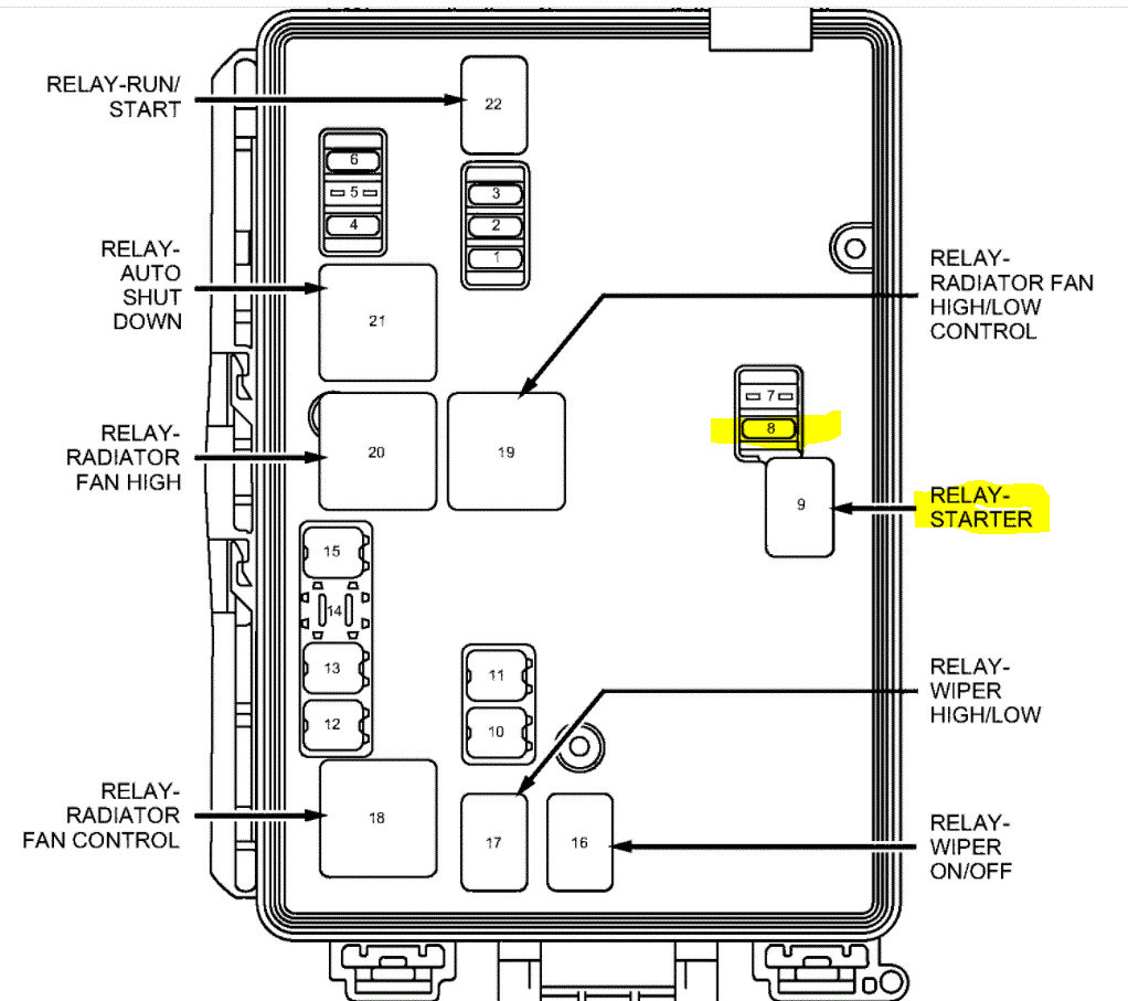

First, check to make sure fuse 8 in the under-hood fuse box is good as well as (again) fuse 8 in the power distribution box in the rear of the vehicle. Confirm they are both good and both have power to them. Here is a link you may find helpful:
If both are good and have power, then remove the starter relay in the integrated power module (fuse box) under the hood. If there is another one that has the same part number, switch them to see if it changes things. If there isn't one, here is a link that explains how to test a relay.

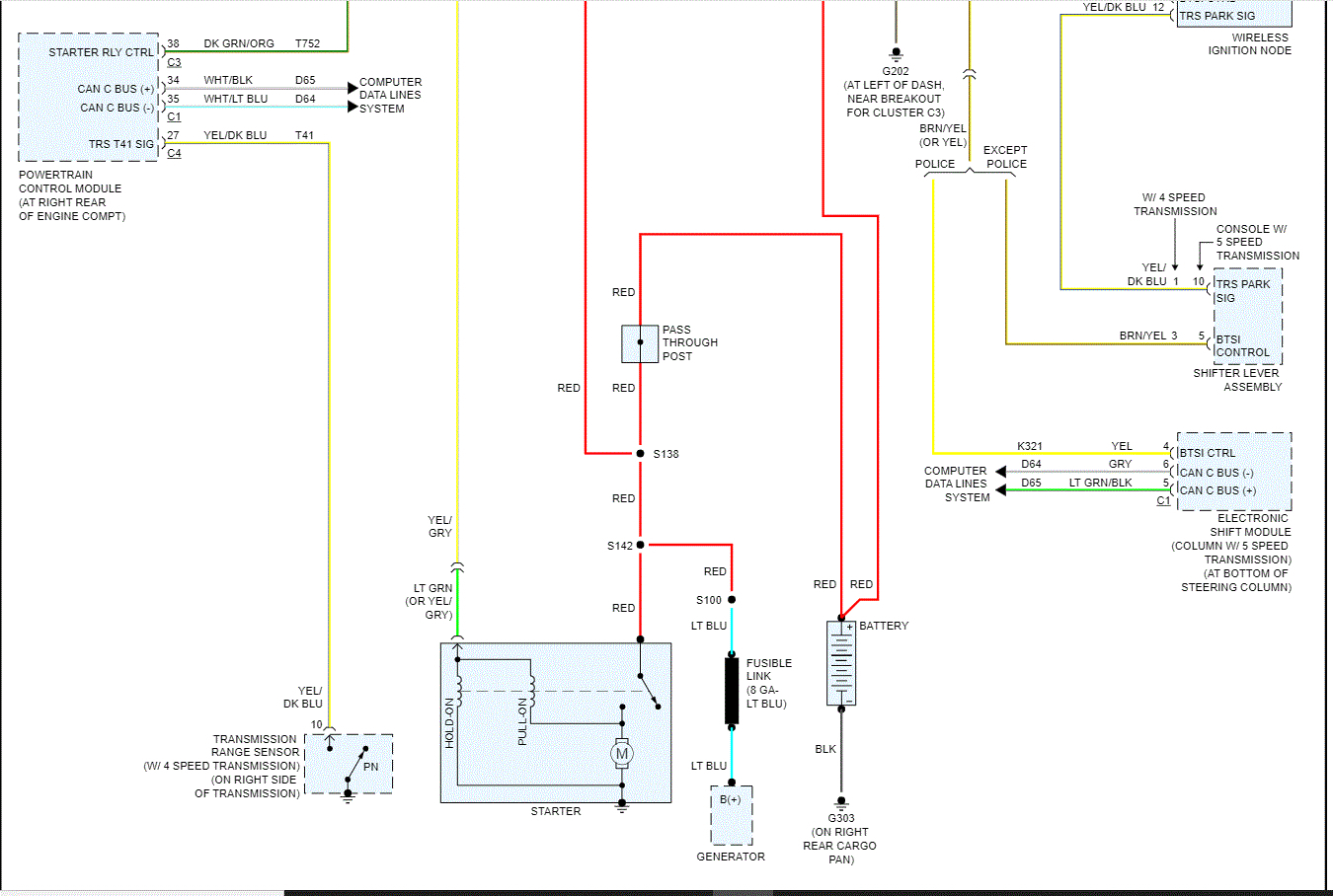

If the fuses are good and the relay is good, then I need you to get a helper. Have the helper put the ignition in the start position while you check for power at the smaller wire on the starter motor. That should only have 12v in the start position. Also, looking at the wiring schematic, it could be one of two colors. (Yellow wire with a gray tracer or a light green wire) Please review pic 2 below.
The red wire should have 12v at all times.

See pics below. Note: Pic 3 is the under the hood fuse box and pic 4 is the rear fuse box. Both fuses are fuse number 8.
