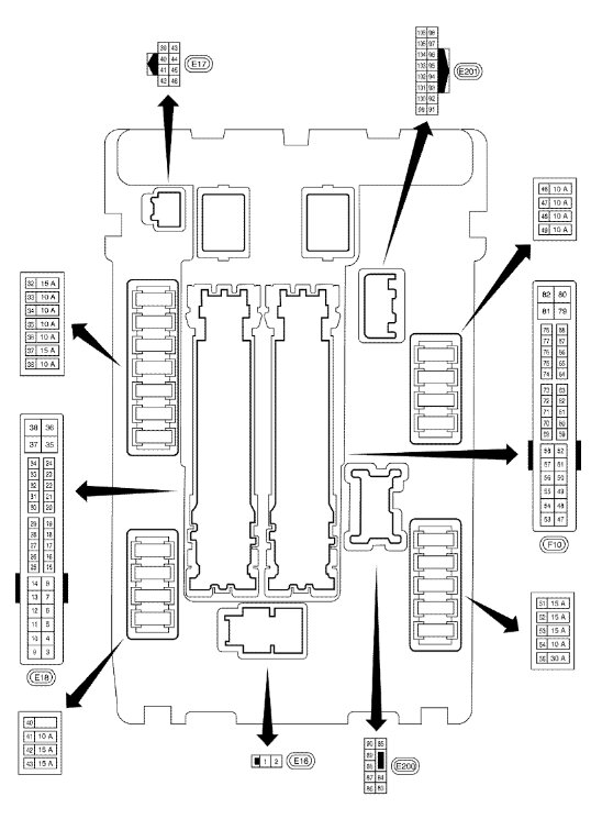

My car (push to start) won't start. I was changing the ignition coils connecter when two wires touched on the number 2 coil the looking front of engine would be second from left to right and since then has not started and all my warnings light on sashes are on and the two key light also are on now all electric components come on like normal just the dash light are on and engine won't crank when push.

Yep, that will pop a fuse, here is a guide to check and I have included the fuses you should be testing.
Fuse #4 in the fuse panel under the dash, and fuses #'s 35, 45, 42, 37, 33 and 32 in the fuse panel under the hood. You may have shorted out the TIPM, but we can cross that bridge when we get there. Check out the images (below). Please let us know what happens.

It was fuse ,42. thanks, you're awesome.
