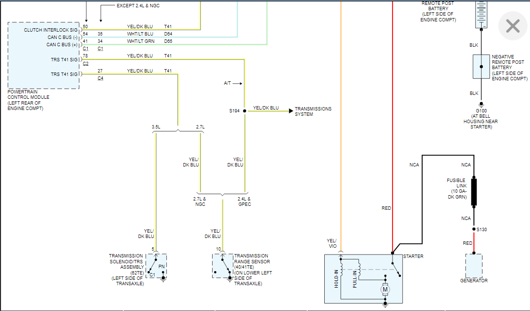

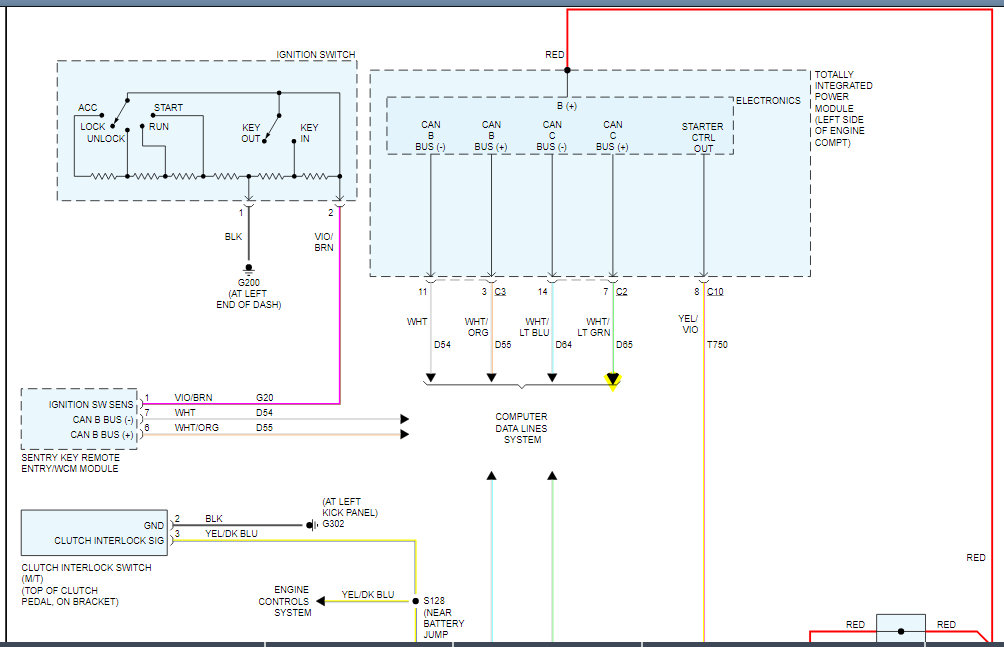

No crank no start
2007 CHRYSLER SEBRING
130,000 MILES • 2.4L • 4 CYL • 2WD • AUTOMATIC
DANIEL NICHOLAS RAVESE JR
No power to starter signal wire, replaced broken ground terminal. need wiring diagram, starter relay location if not part of TIPM itself. Thank you in advance.

Hello, I'm Danny.
I've attached the wiring diagram you requested below.I cut it in 2 pieces to make larger.Hope this helps and thanks for using 2CarPros.
