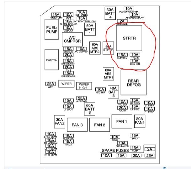

I have the car listed above SS model.
I have had a no crank no start, not turning on or starting no audible click with starter either. Just put a brand-new starter in the car and I am still experiencing the same exact issue.

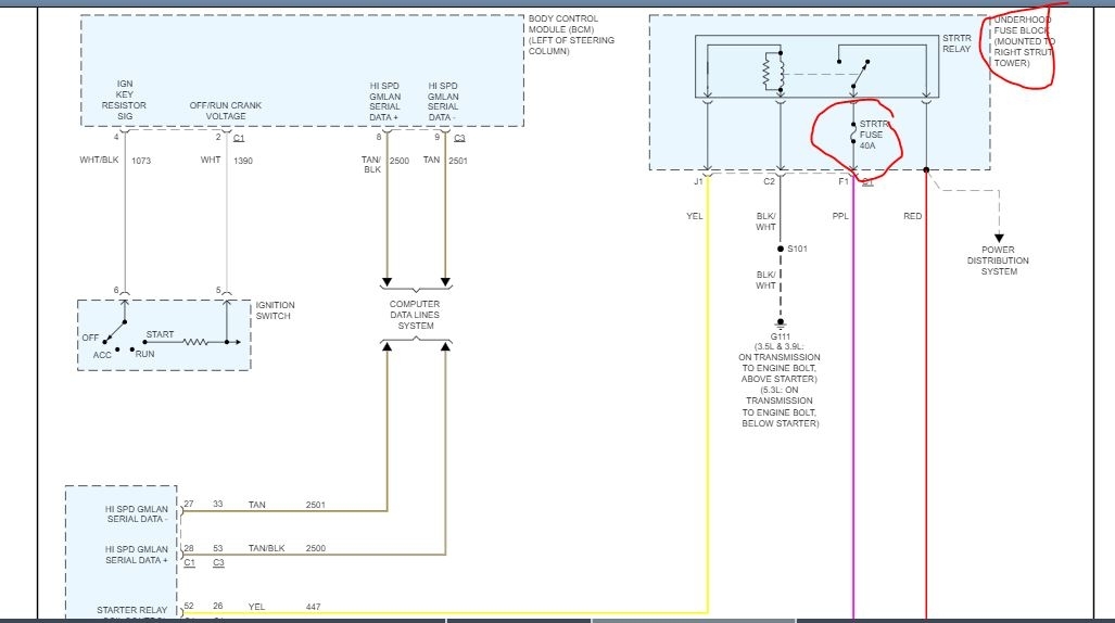

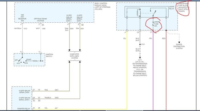

I attached a wiring diagram for you to view.
You need to test for any power to the starter solenoid with the key in the start position.
This could be a bad starter, relay, or park/neutral switch.

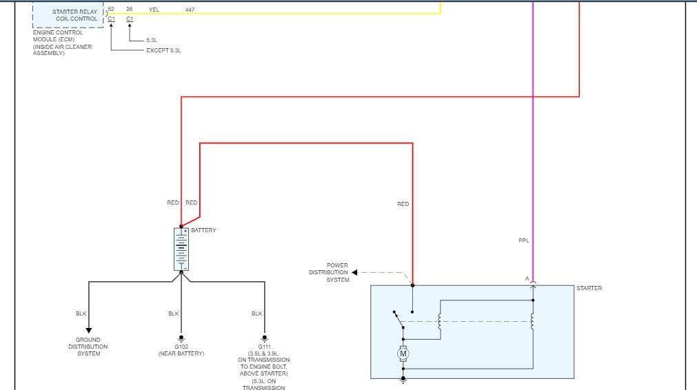

I am guessing I will use a test light to test the purple wire at the starter for power then?
Nov 17, 2021 at 12:56 AM
That will be fine. It should have power only in the start position.

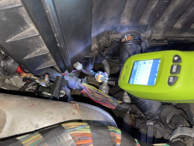

Ignition to on position and I’m not getting power from the purple wire.

As I stated, the key needs to be in the start position, not the on position.
Try it that way and let me know.

found the issue was my starter relay, I took it out adjusted the pins and the car starts every time now.
