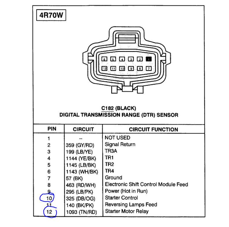

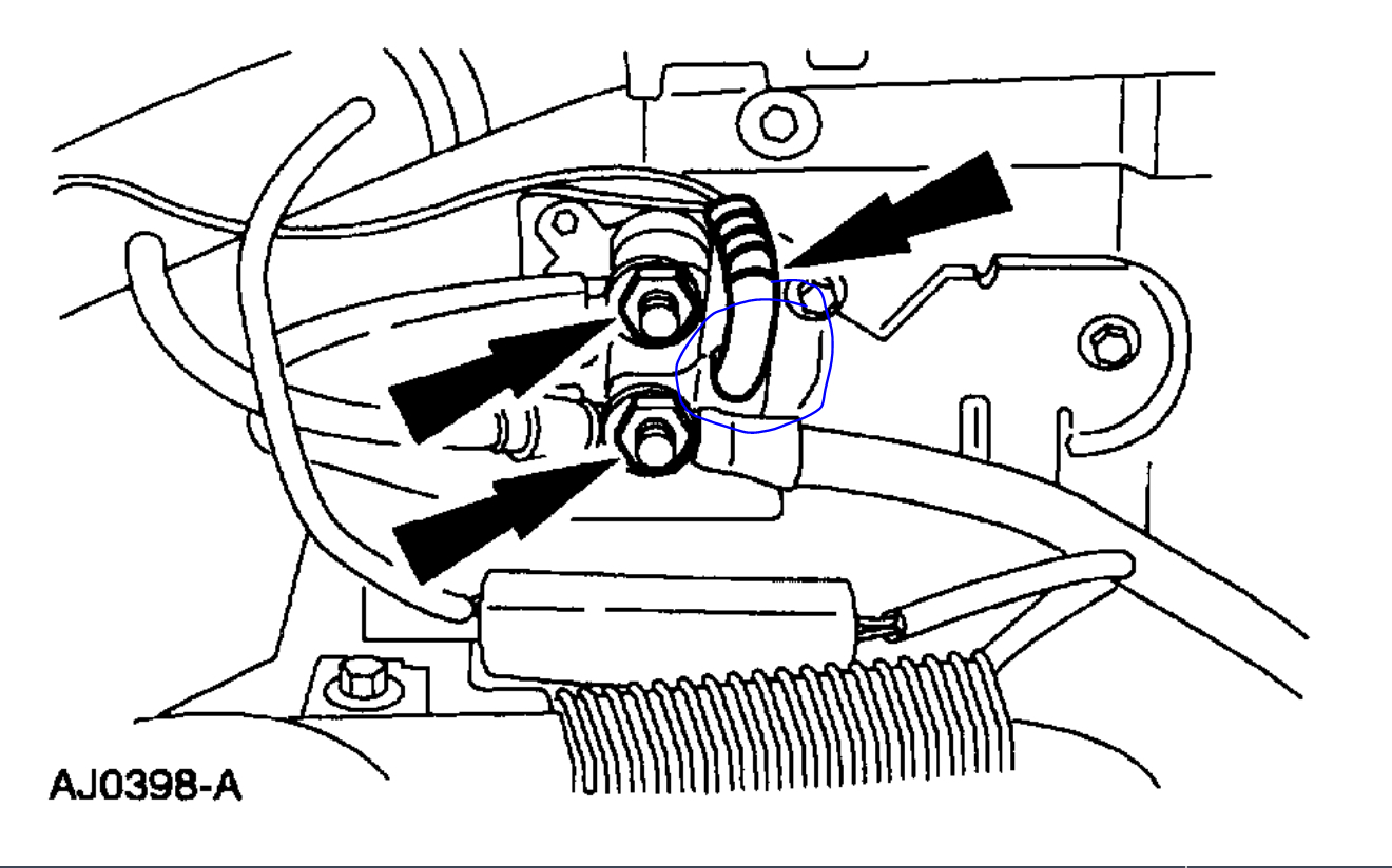

Transfer case motor stuck in 4×4 low. replaced motor, sensor above motor wire out, replaced with junk yard sensor. Also replaced water pump and pulleys, thermostat, serpentine belt, replaced ignition switch, all lights come on in run, 4×4 light stays on when car is running, it's blinking. To get car to start i jump solenoid on firewall, checked wires the fuses there is no power on small wire from ignition to solenoid on firewall in the start position with key. is that wire my problem? because the 4×4 blinking i think that sensor is like neutral switch. also and not sure but that won't let car start either. I'm so lost help.

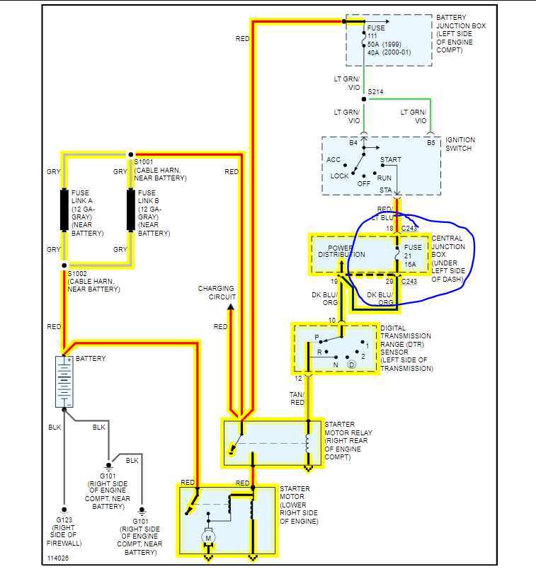

I attached a diagram of the starting system for you to view. Check the fuse listed for power with the key in the start position to be sure the ignition switch is sending a signal.
Let me know the results so we can get to the root cause of failure

The fuse is in the fuse box in the car, not under the hood.
The only relay for the system if you look at the diagram, is under the hood on the firewall.
Those 2 relays are not in the circuit.
Did you verify power to the fuse I circled?
