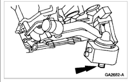

I flush my radiator twice a month but I keep having oil in my coolant , so I had the heads checked and they were fine all the power and everything so what I need to know is what is causing this, thank you
Mar 7, 2010 at 3:42 AM
  • 55,432 POSTS

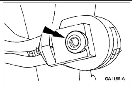

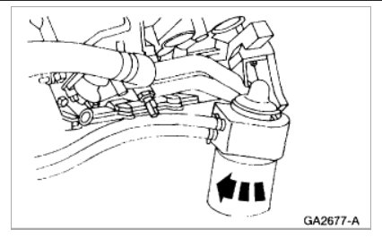

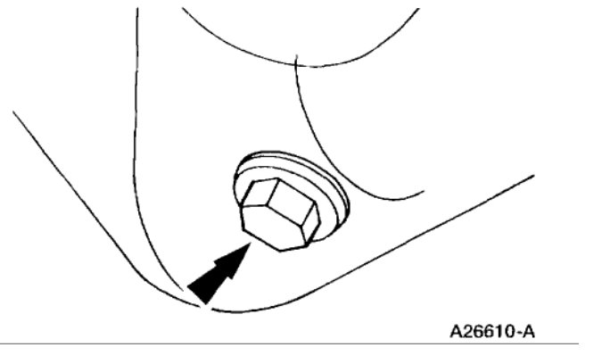

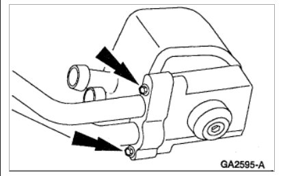

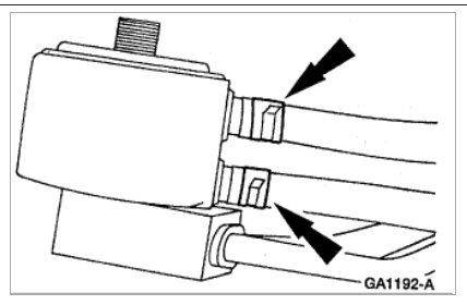

Yes you have a oil cooler that has failed which is located by the oil filter. What happens is the oil pressure is greater than the pressure in the cooling system so engine oil gets pumped into the radiator. Here is a guide and some diagrams (Below) that will help you get the problem fixed.
https://www.2carpros.com/articles/coolantantifreeze-in-the-engine-oil
Check out the diagram (Below)
