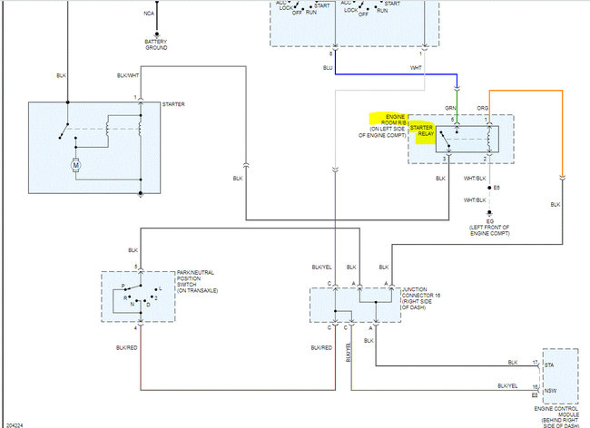

Hello, the vehicle sometime would not give a sign of cranking, I checked the voltage or power source on the solenoid, there was none while cranking but sometimes there will be power. With the ignition switch in "on" position, I use wire to connect Power from the battery to the solenoid, the vehicle start. Please could you help me with the cranking circuit diagram?
Oct 23, 2020 at 6:26 PM
  • 110,194 POSTS
If you get power sometimes and not others to the S terminal on the starter, chances are the starter relay is failing. Here is a link that shows how to test a relay:

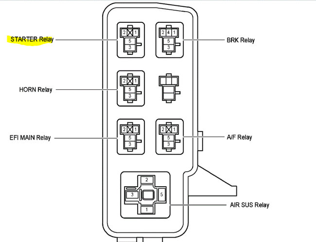

If you look at pic 1 below, it is a portion of the starting system wiring schematic. I highlighted the relay and its location. Pic 2 shows the relay's position in the relay box.
This is where I would start.
Let me know what you find.

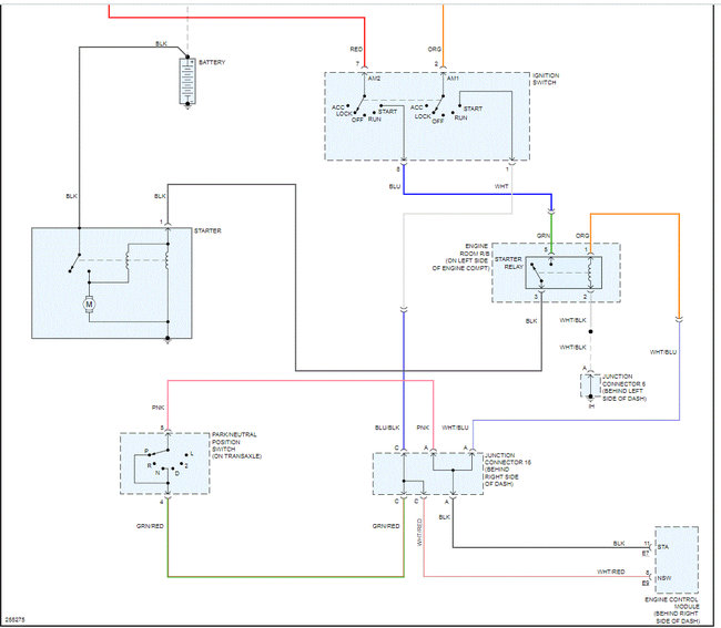

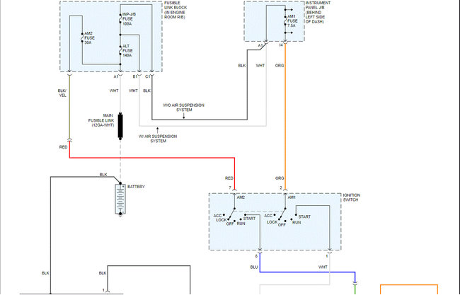

Thank you, but for the first diagram you didn't add the top. Please add it.
Oct 26, 2020 at 8:14 PM
  • 110,194 POSTS
Here is the entire starting system schematic. Please note this is for an 2007 RX350. I am showing nothing for an 2006. Since these were introduced in 2006, I suspect it was a late production.
I hope this helps.

You are very welcome. Please remember, the schematics came from a 2007 manual.
