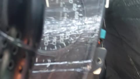

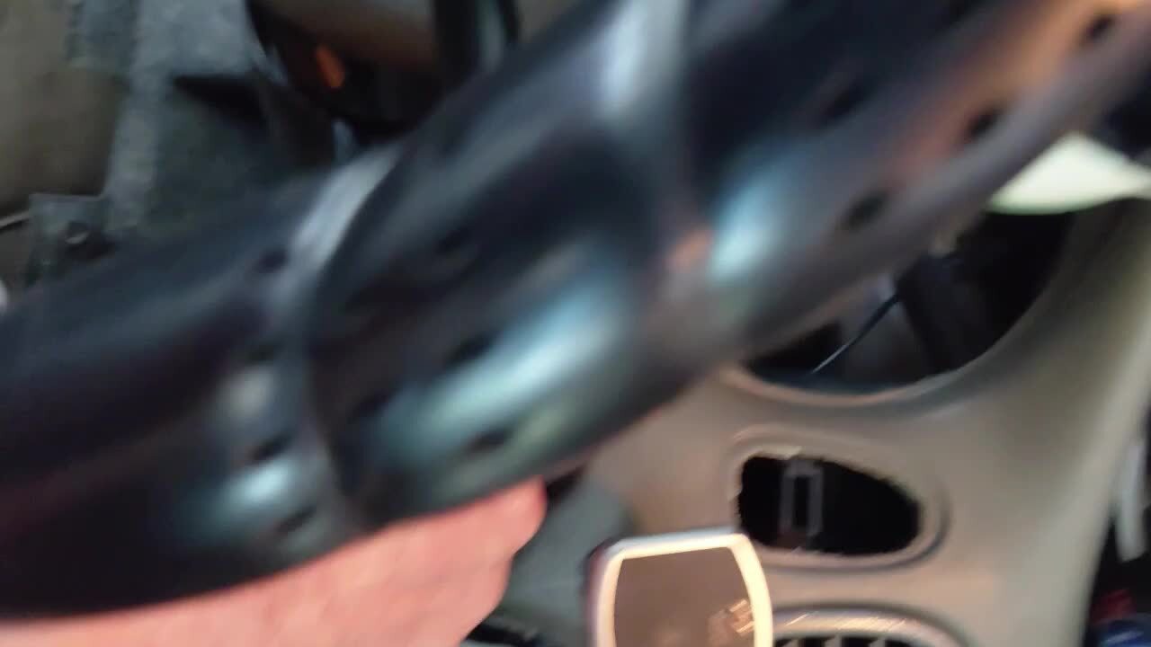

It has new starter and ignition switch. When key is in on position the security light comes on and stays on, no blinking. While ignition is on, I can start car at relay with plastic cover off by squeezing the relay. The car starts right up and then shuts itself off within a second or two. So I figured it had something to do with the alarm theft system so I tried a bypass passkey and relearning signal with 30min process but security light never went off after 10min and just stays on. Please help.

DOBSKY72
I believe the video says it all
Sep 16, 2025 at 6:08 AM
  • 55,224 POSTS
Thank you, I seem like the fuel pump is not working or you are not of gas or the car has old gas in it. I would try starting fluid to see if you can keep the engine running. This video will show you how.
https://www.youtube.com/watch?v=lXLJbuAZ4CE&t
The cars like it is in many pieces? Are all of the electrical plugs back together?
