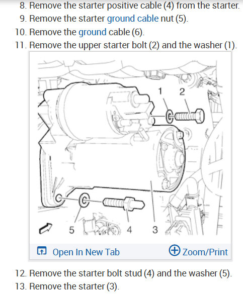

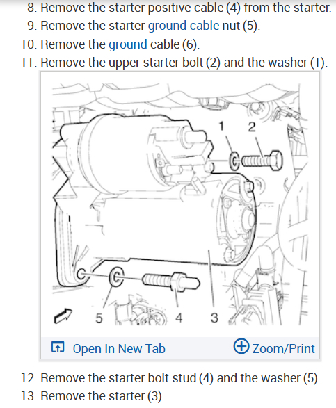

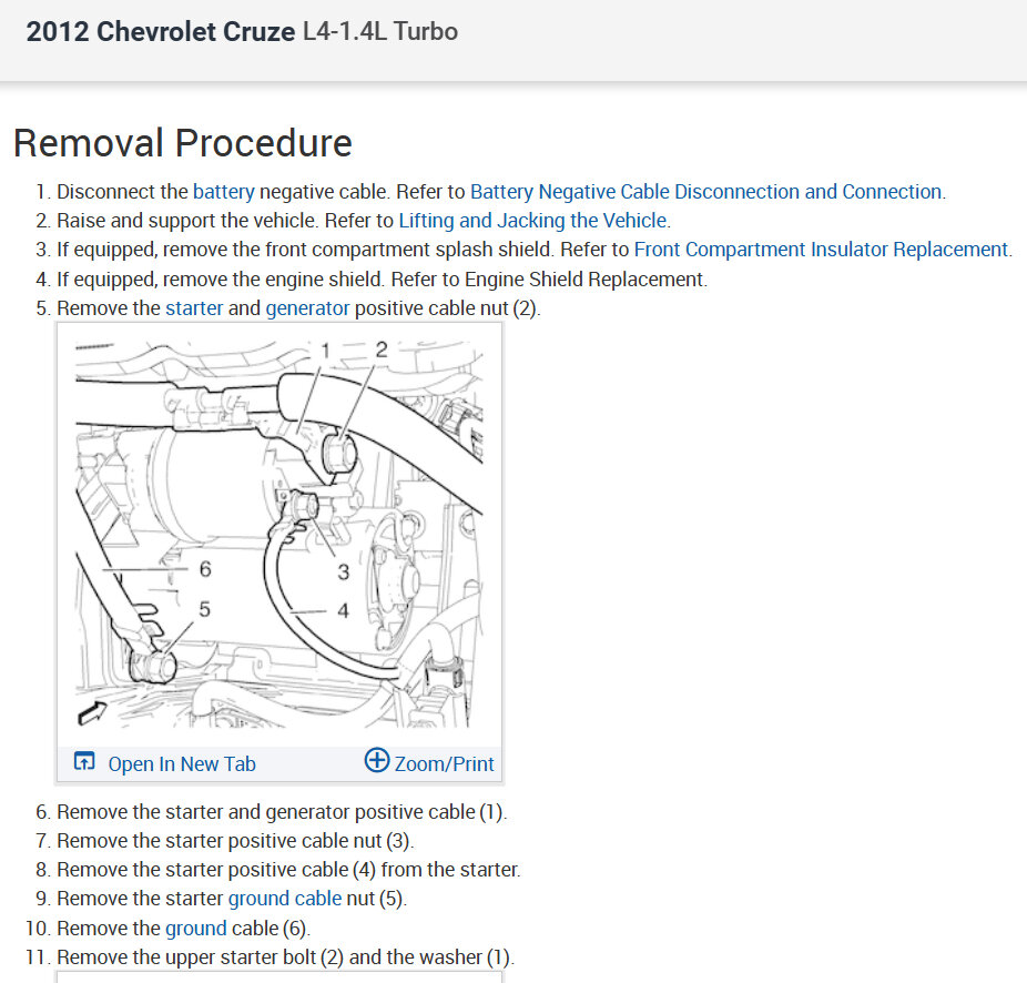

It sounds like the starter motor has gone bad, but to be sure we need to check for power at the starter solenoid trigger wire.
This guide can help you:
Here is the start motor location so you can check it out, and I have included a video that may help as well.
https://www.youtube.com/watch?v=6YRW8fyNudY&t
Check out the images (below). Please upload pictures or videos in your response of any problems so we can see what to help you with.
