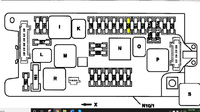

Please can you tell me or show me how to fix my fault? I drove my car without fan and my temperature went over 109% and it was working perfectly when I switch it off and try to start it won't start anymore. check all the fuses and they are all working fine. I discovered that my park light won't come on. when I tried to diagnosed the ECM/ESP/EPS is showing me communication error none of the modules are communicating. please and I don't know what to do anymore.

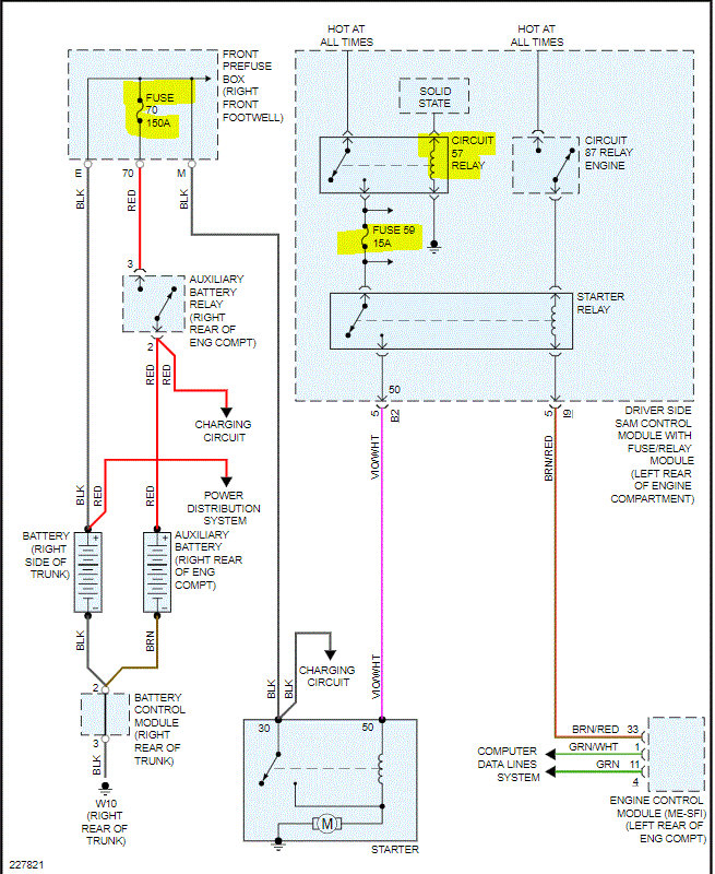

Do me a favor. I attached a portion of the starting system wiring schematic. Check the fuses I highlighted and the relays in the pic as well.
In addition to checking fuses, confirm there is power to them. Here is a link that shows how to check a relay and one dealing with fuses that you may find helpful:

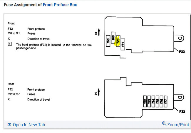

Pics 2 and 3 show fuse location.
