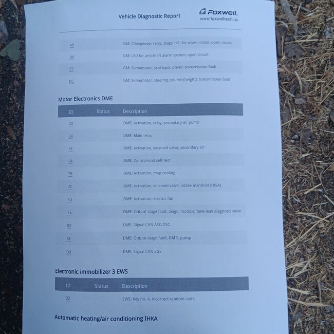

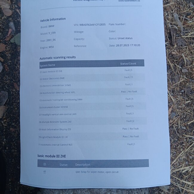

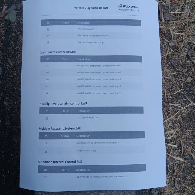

This is what my scanner told me. i hope you can help me.
Jul 28, 2023 at 4:20 PM

  • 55,214 POSTS
In the scanner can you go into the faults and get the numbers please? There are faults but it doesn't say what they are. Also can you make the image text larger, it is hard to read.
