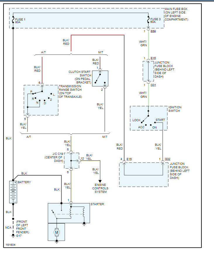

Hello again,
Please go through the guide in the link below.
and if everything checks out with that then please go through the guide in the diagrams down below. Let us know what you find out. I have included a link down below with instructions on how to use a volt/multi-meter if you need it as well.
Thanks,
Alex
2CarPros

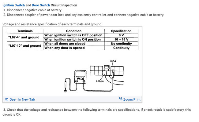

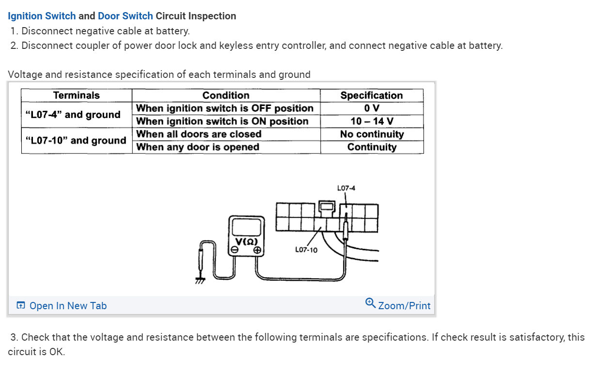

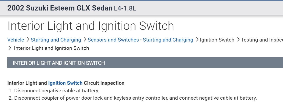

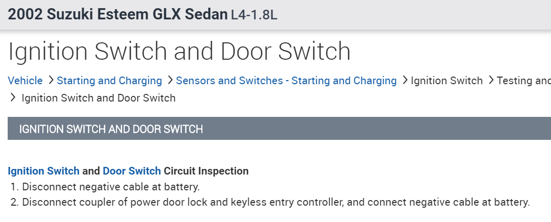

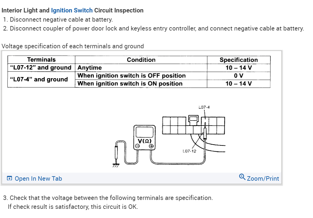

SCGRANTURISMO
  • 4,897 POSTS
Hello again,

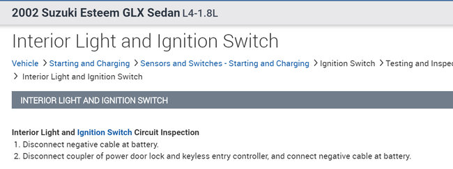

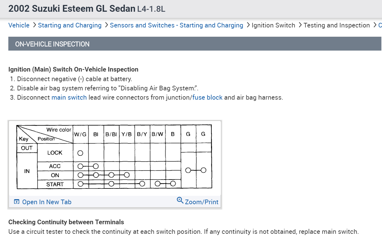

Okay, I have included in the diagrams down below a troubleshooting guide for checking your ignition switch. Please go through these guides and get to us with what you find out.
Thanks,
Alex
2CarPros
Feb 21, 2019 at 4:33 AM
LARRY NASON
  • 48 POSTS

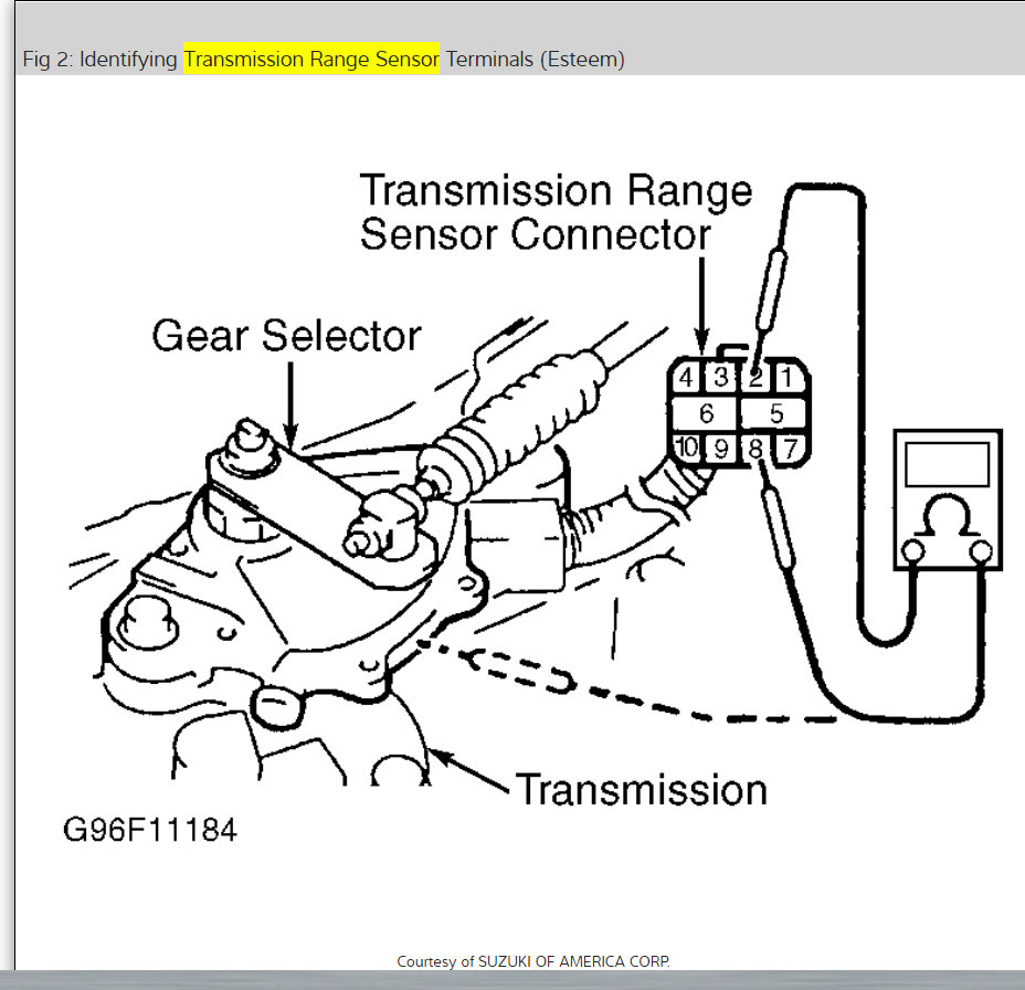

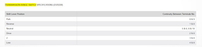

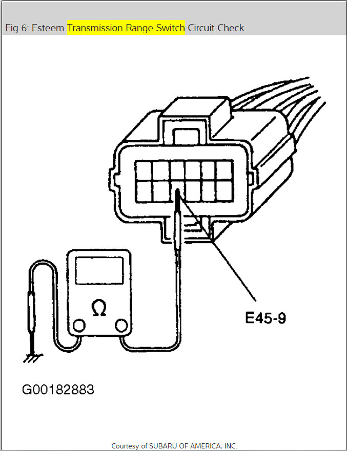

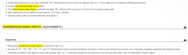

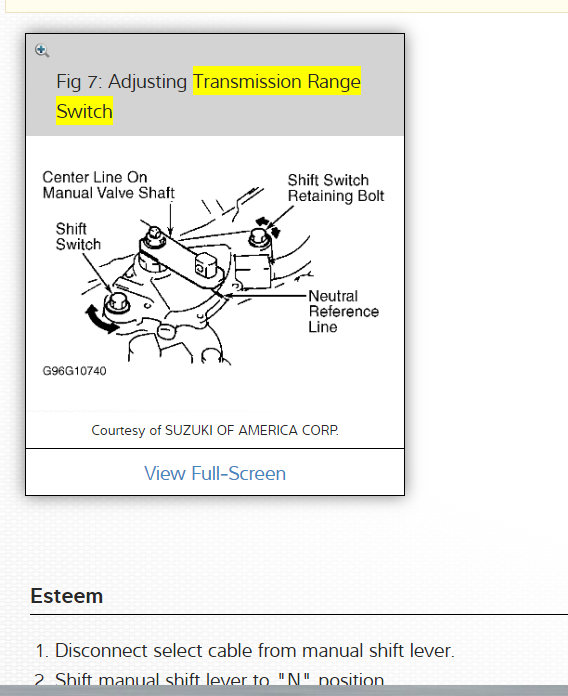

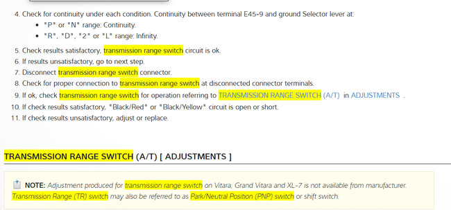

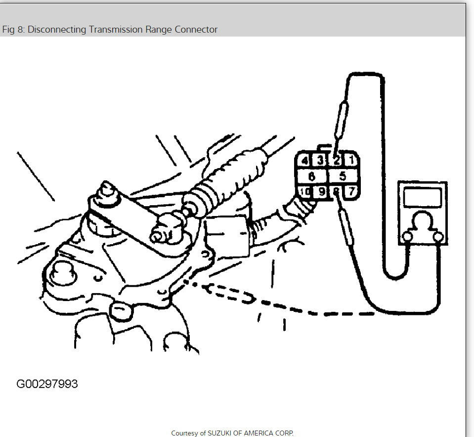

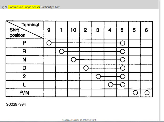

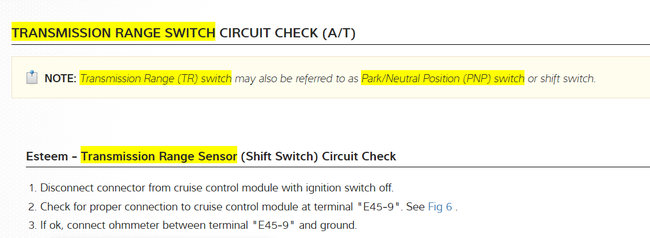

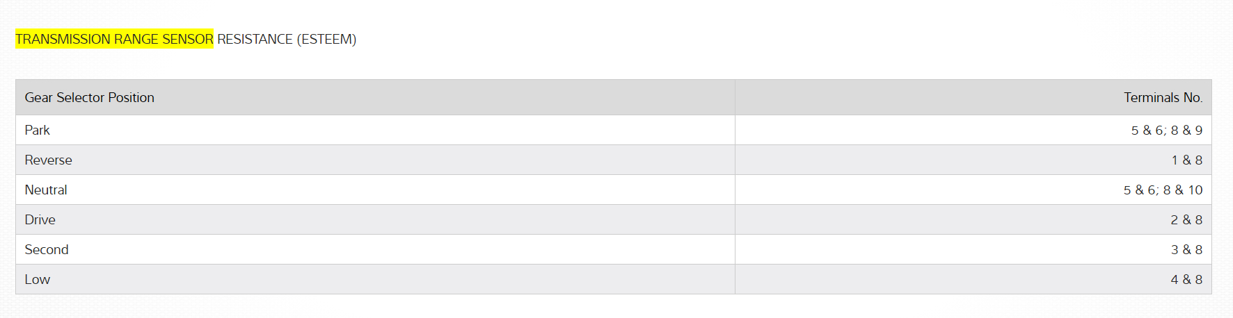

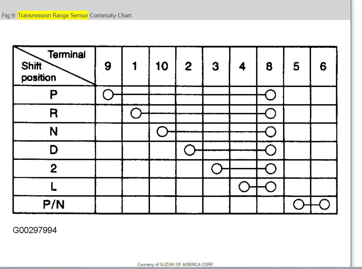

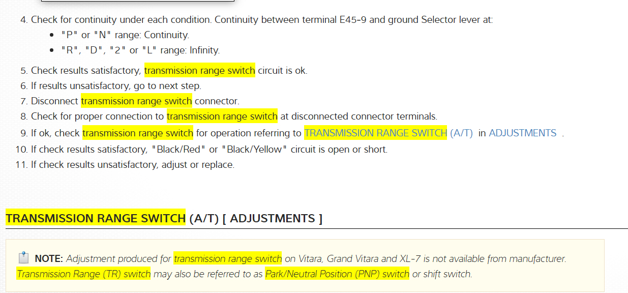

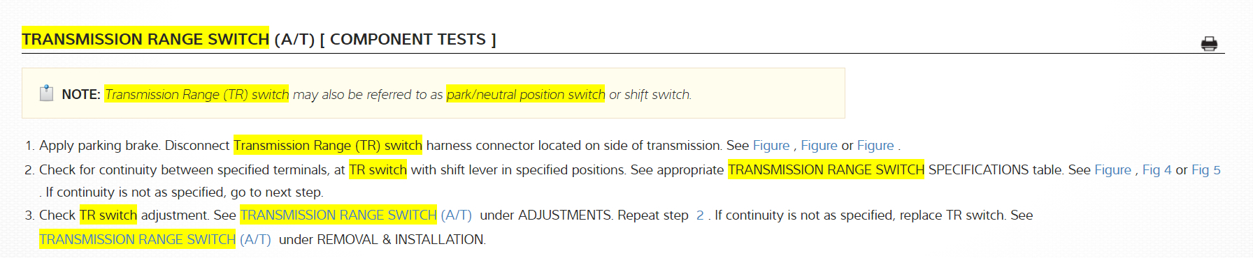

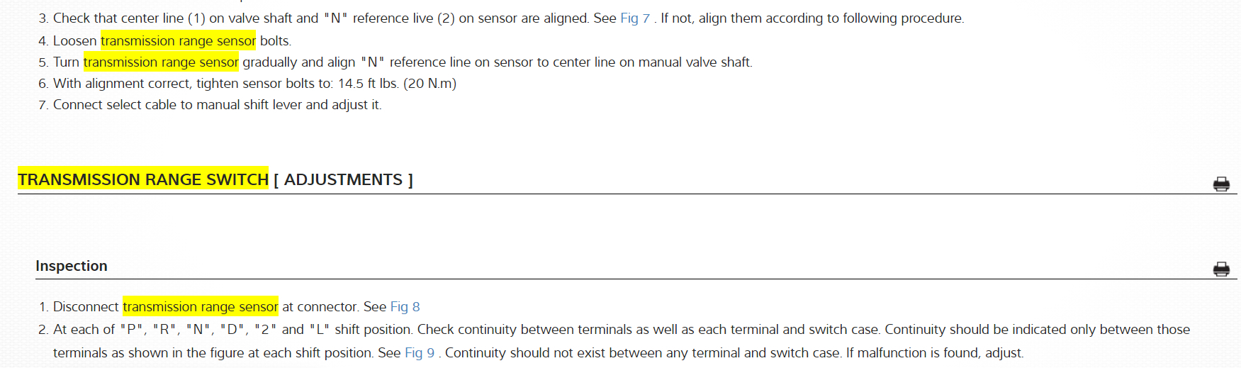

So I replaced the ignition switch still no luck. Can you tell me where the neutral safety switch is on this car?
Feb 23, 2019 at 11:21 PM
SCGRANTURISMO
  • 4,897 POSTS
Hello again,
I have included the information you requested as well as a few other things in the diagrams below. Let us know what you find out.
Thanks,
Alex
2CarPros
Feb 24, 2019 at 12:51 AM
