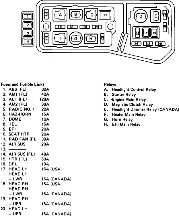

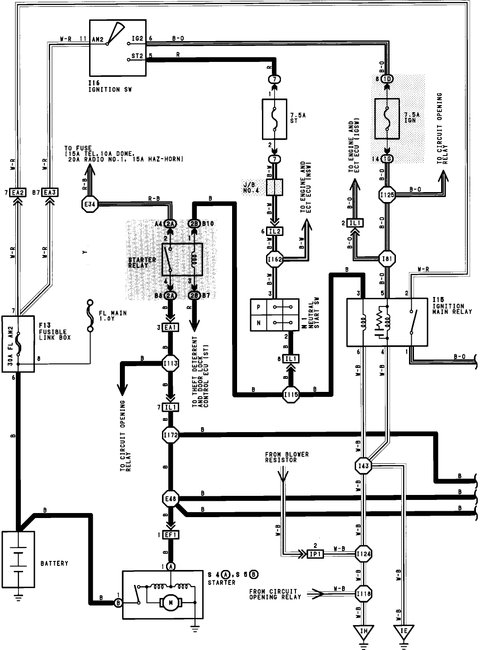

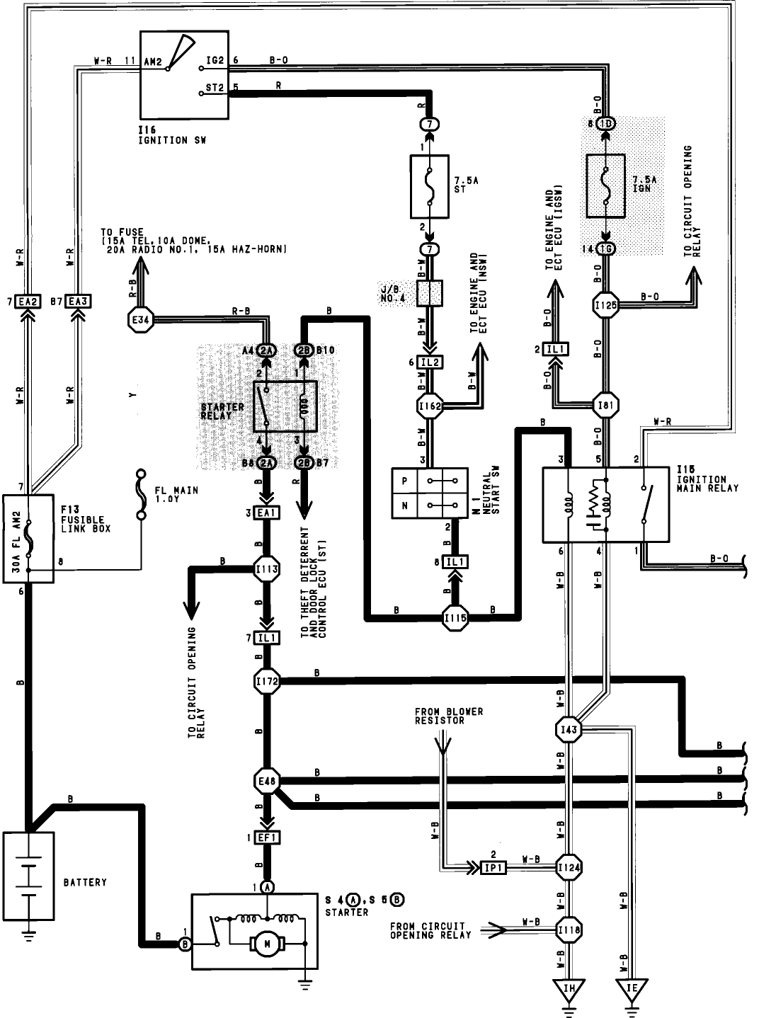

OK, when you say nothing with the key do you have lights and such but no starter function or are the lights out also?
If you have all the rest but no starter action go to the junction box on the drivers side under the hood and find the starter relay. Have someone turn the key while you put your finger on the relay. Do you feel or hear it click when the key is turned?
If yes then the starting circuit from the ignition switch to the relay is OK and we will look at the relay to starter motor side. The easiest way to test the relay is to simply swap it for another. When you pull it look close at the pins and the connections. They should look clean. I believe the starter relay and the horn relay are the same, for the test you can just pull the horn relay and plug it into the starter relay socket. Try starting it now. If nothing then check the battery cable from the starter to the positive battery terminal, you can use a set of jumper cables to see if the cable is the issue, just connect them from the battery terminal on the starter to the positive batter terminal. Try starting it now. If it starts now you have a bad cable, they can corrode inside and cause problems.
This car doesn't have any aftermarket items like remote start or security add-ons does it?
