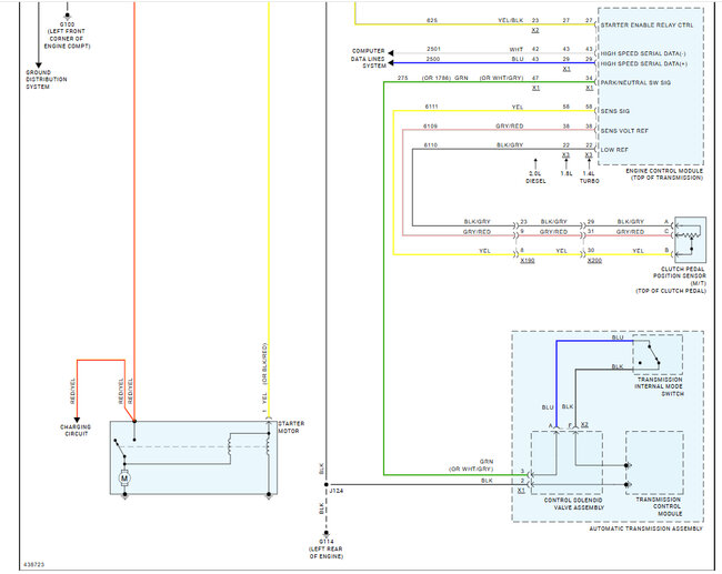

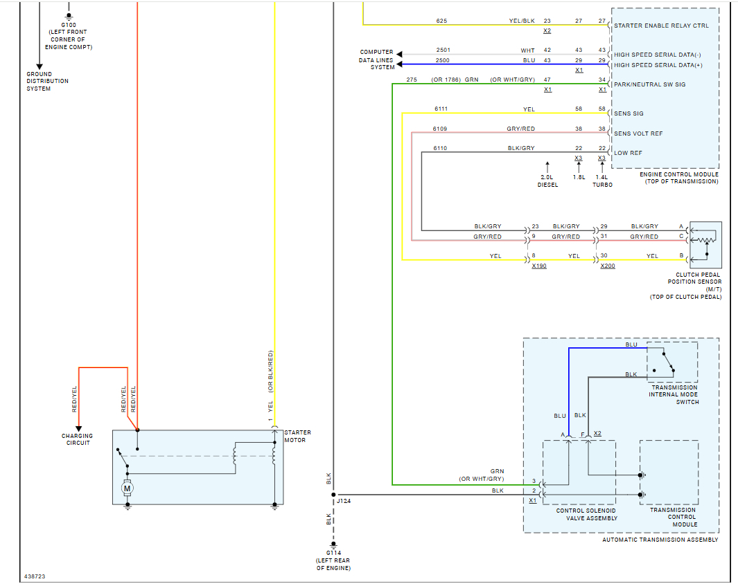

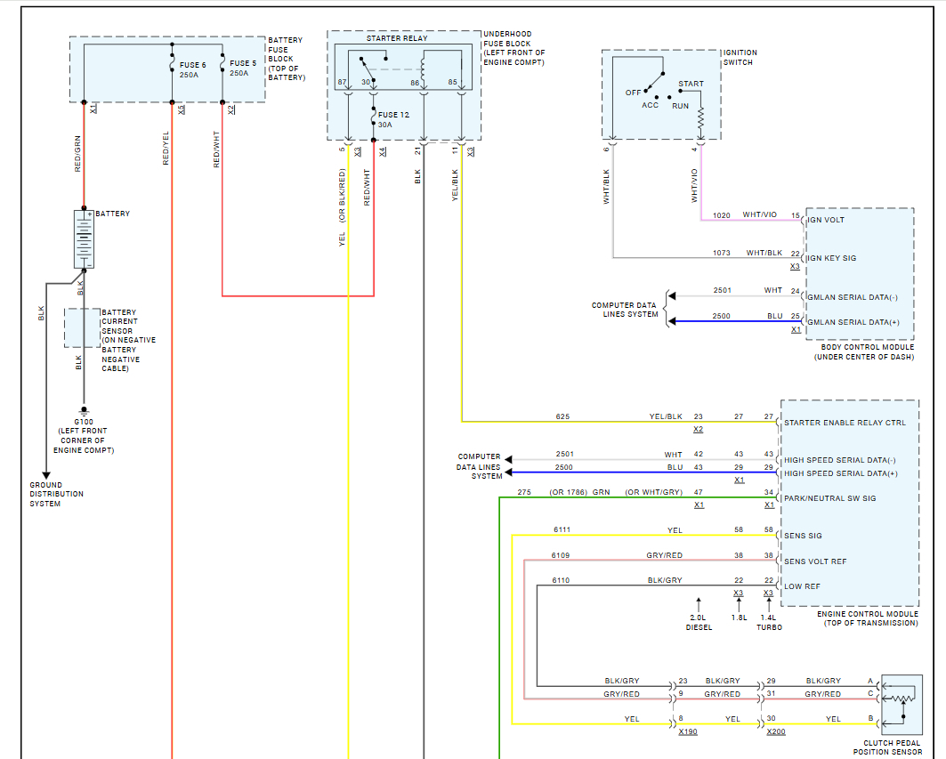

So it does not crank over (starter) correct? Here is the wiring diagrams for the starter motor so you can see how the system works.

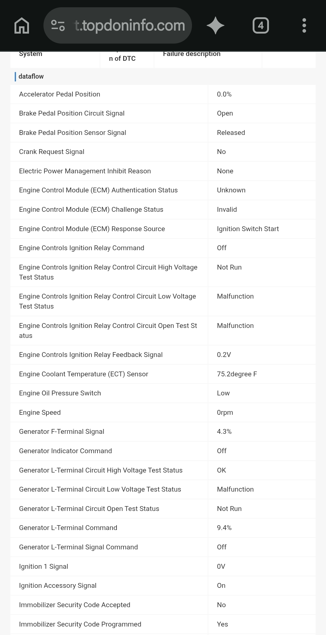

Still can't get the video to you guys wish I could somehow its only 42 seconds but here's some live data off the scan tool
Oct 5, 2026 at 8:03 PM
  • 55,691 POSTS
The site admin increased the video time to 1 minute. Please try again. The data looks okay, are there any other codes?
Oct 6, 2026 at 9:26 AM
DB123
  • 37 POSTS
Just a refrigerant code, its just not letting me send the video, when I get to the shop in the morning I'll see if I can't make another short video
