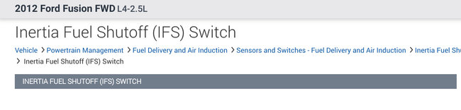

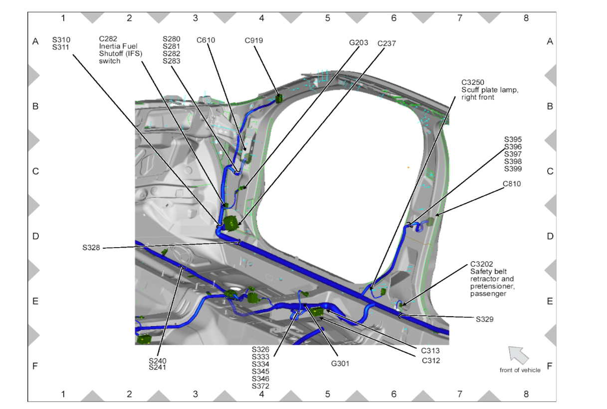

This could be a case where you just need to reset your vehicle's inertia fuel cutoff switch. It should have a button on top that you just need to push down. This switch is set to open on an impact to shut off the fuel pump in case of a bad accident to keep your car from exploding. In the diagrams down below I have included a diagram of the inertia fuel cutoff switch's location which is behind the passenger side kick plate. Please get back to us with how everything turns out.
