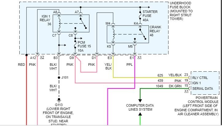

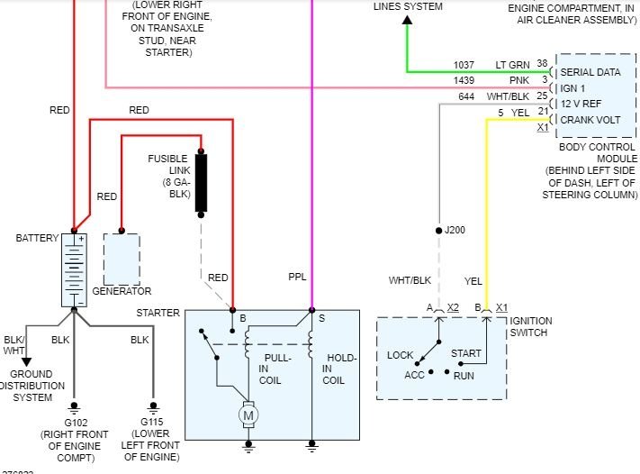

Honestly, it sounds like a bad ground. Reconfirm that the battery terminals are clean and tight, the ground to the engine is clean and tight as well as other grounds from the battery (There are a total of three) and make sure the connections at the starter are tight. I have a feeling when installing the new engine, one of the body grounds were damaged.
I attached two pictures of the starting system. I overlapped them so you could follow them. Note the three body grounds. Also, note fuses.

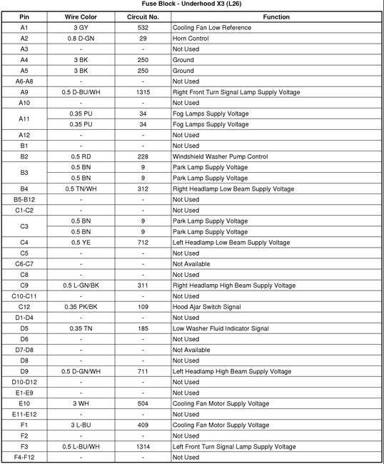

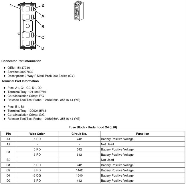

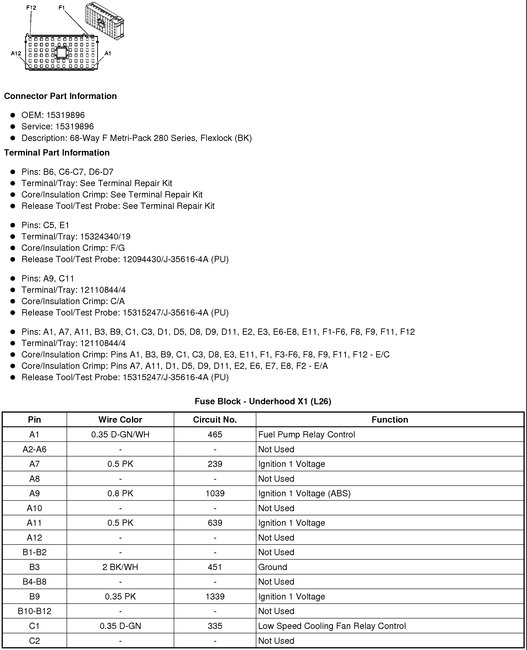

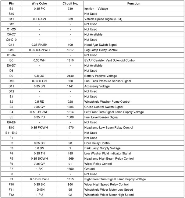

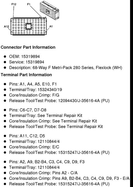

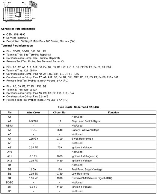

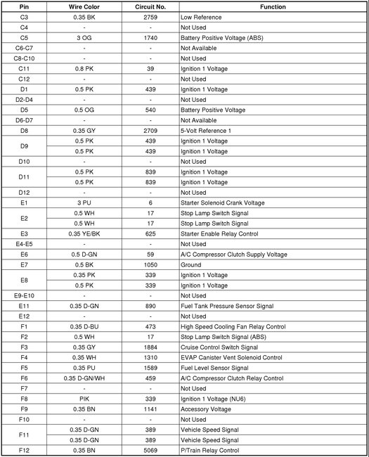

Okay, if the grounds are good, then there is either a weak connection in the power distribution box or there is an issue with one of the pins. I have attached the plugs which are on the back side of the box. You need to check these for one that is disconnected, corrode, or got damaged during the work. I attached the legends so you can see what each plug powers.
Let me know if this helps.
