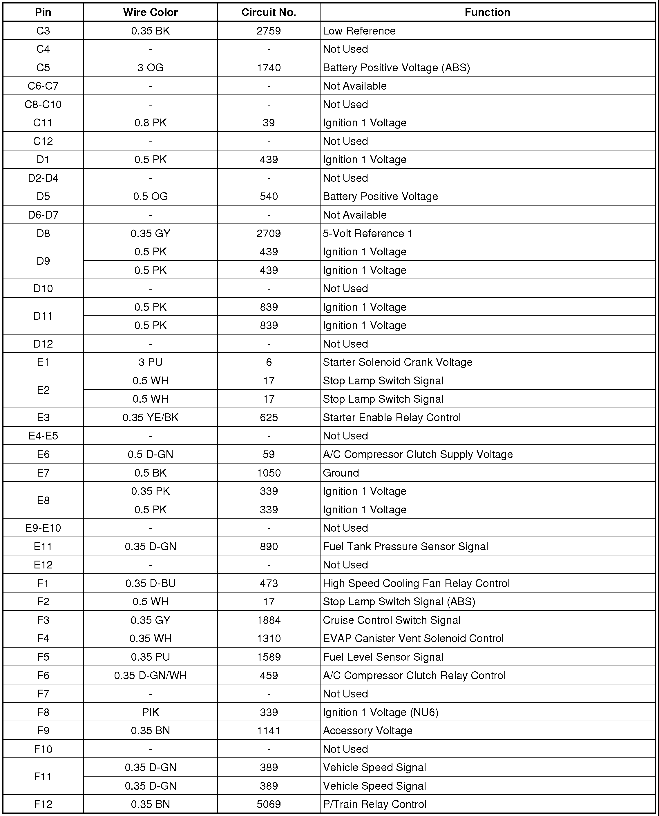

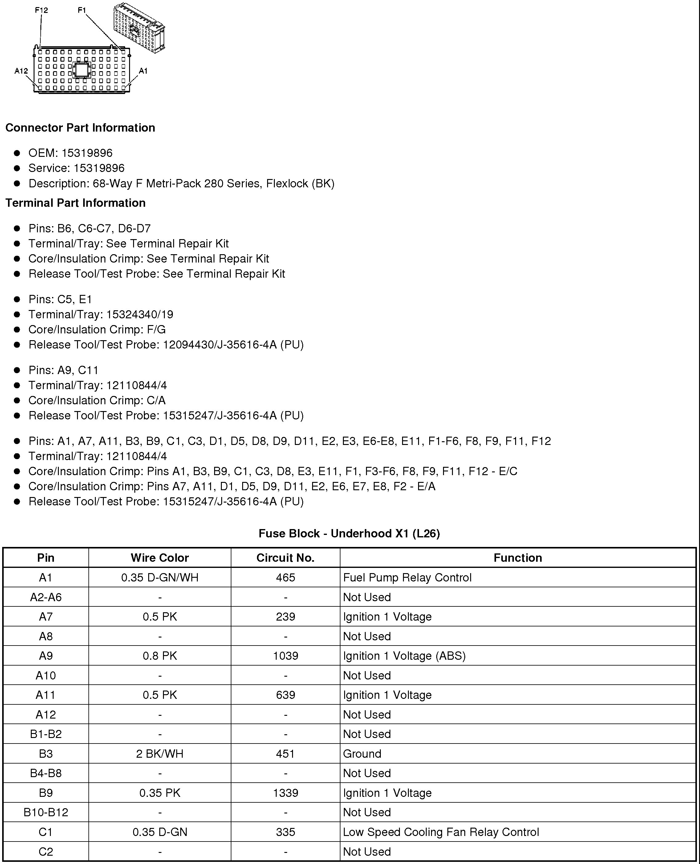

Hi there, after doing a engine swap on my Grand Prix i am faced with a no crank , no start issue. My original motor was a 2008, 3.8l series 2 and i swapped it with a 2007 3.8l series 2 out of a Buick. To be safe i swapped all sensors from old engine to new, i also used old ignition control module and coils, i put new plugs in as well all grounds are hooked up and cleaned before hooking up and i have power to the starter. When i went to start for first time, I turned key , lights turned on , when i went to start, nothing i could hear relay click once after letting off key, however i just noticed when i turn key to "on" position my information center turns on then shuts off.

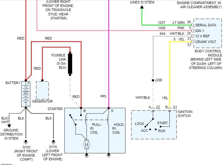

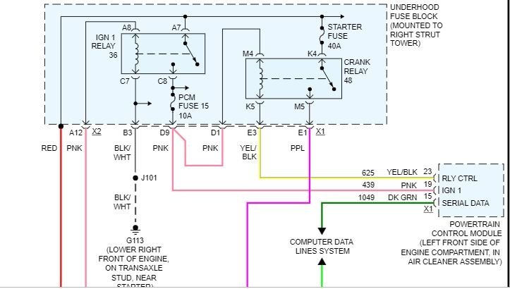

Honestly, it sounds like a bad ground. Reconfirm that the battery terminals are clean and tight, the ground to the engine is clean and tight as well as other grounds from the battery (There are a total of three) and make sure the connections at the starter are tight. I have a feeling when installing the new engine, one of the body grounds were damaged.
I attached two pictures of the starting system. I overlapped them so you could follow them. Note the three body grounds. Also, note fuses.

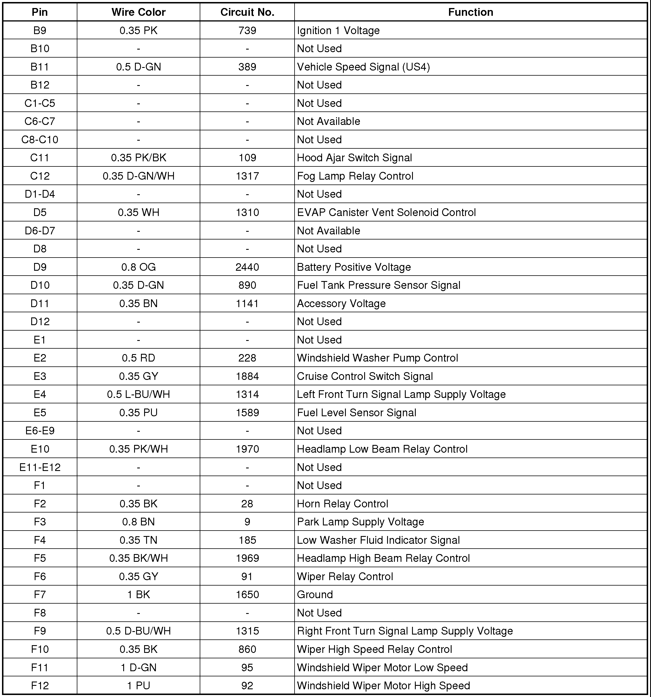

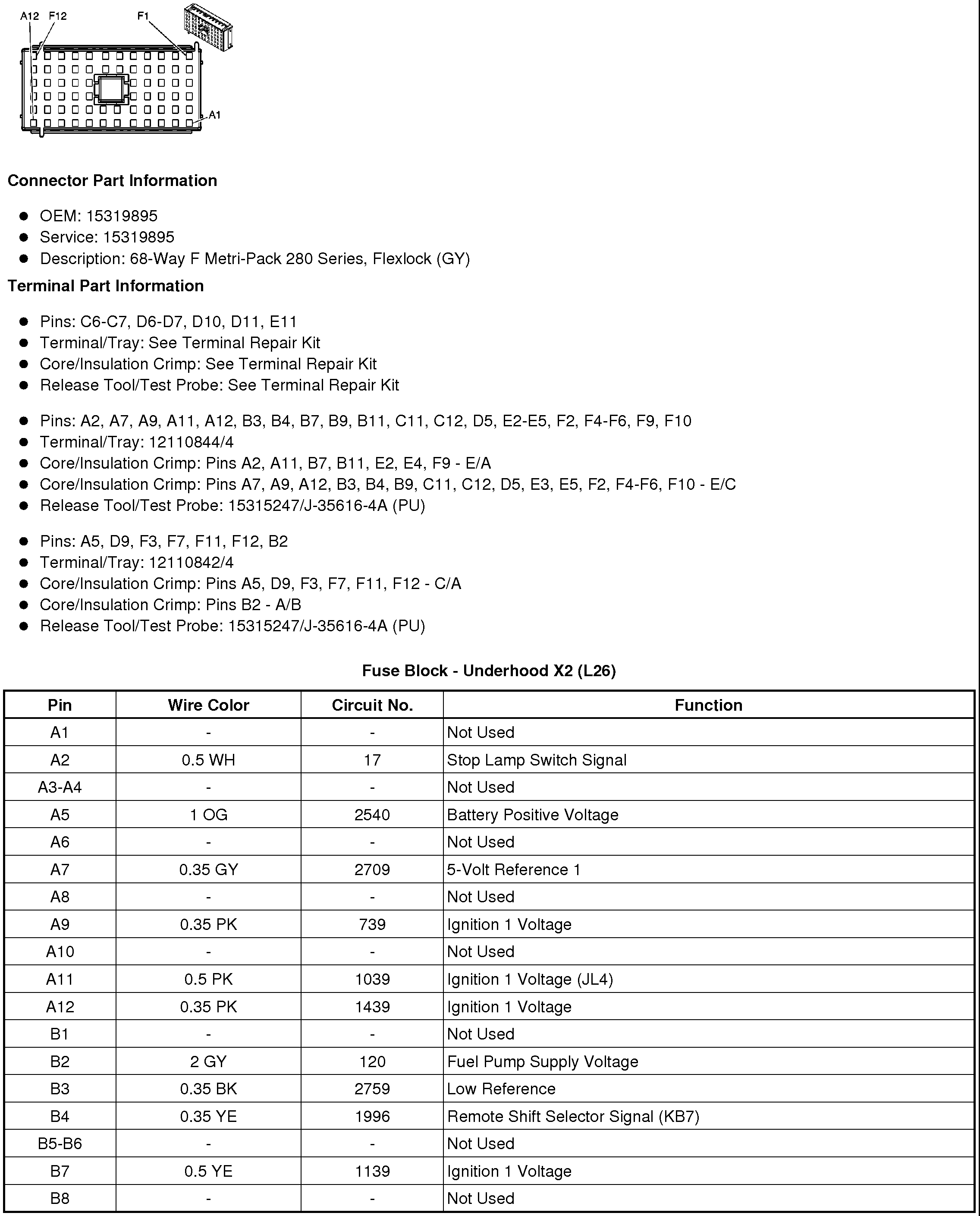

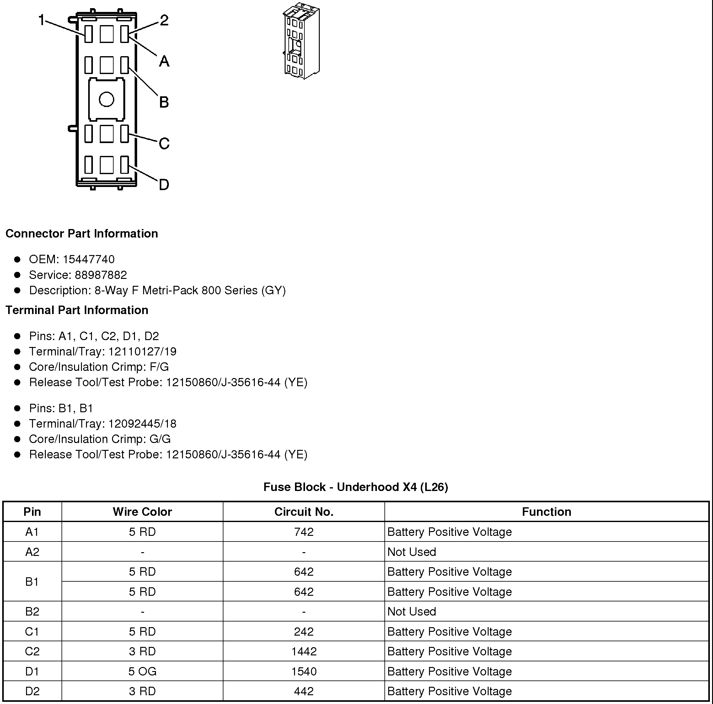

So i checked and cleaned all grounds , still no crank , no start , i tested all fuses , and found that the top section of my fuse panel under the hood is not getting any power for whatever reason, when i turn key on. information center lights up then shuts off still, but found when i shut my headlights off the information center turns back on. i jumped the starter and my car fired right away. i still need to resolve no crank no start.
Jan 25, 2019 at 3:03 AM
  • 110,194 POSTS

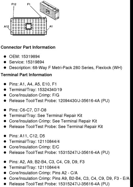

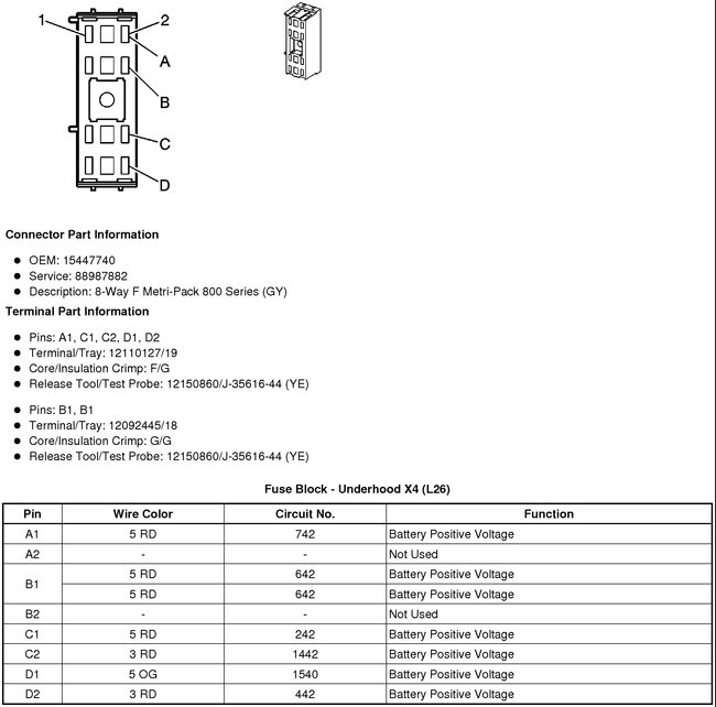

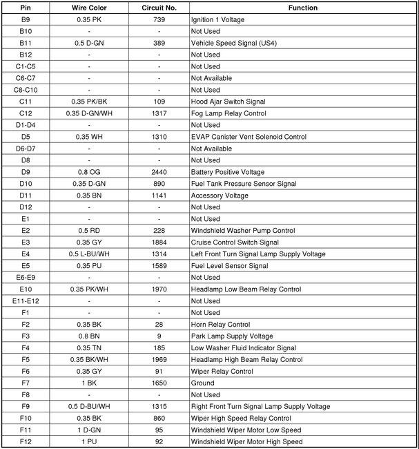

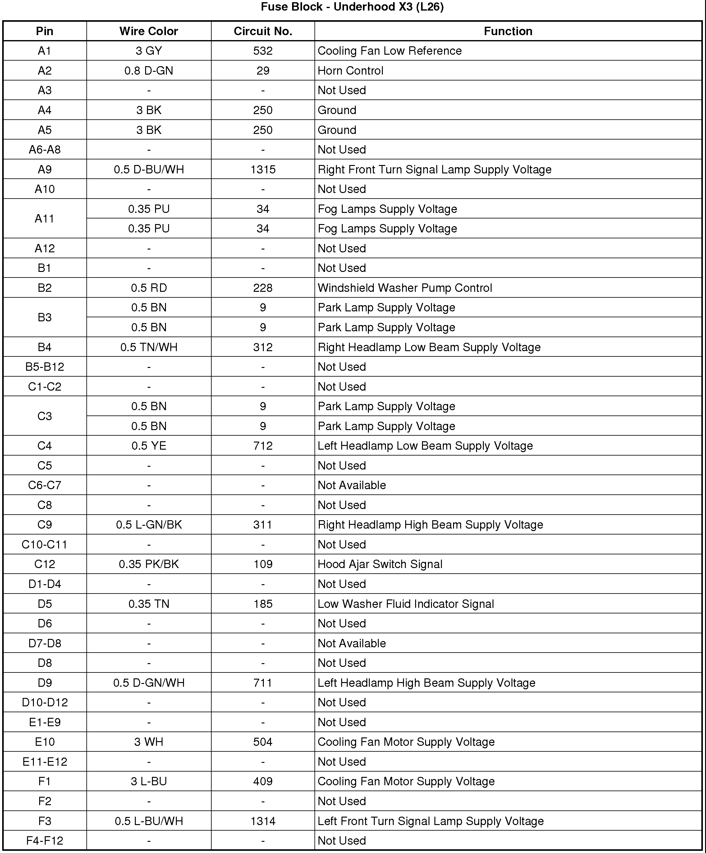

Okay, if the grounds are good, then there is either a weak connection in the power distribution box or there is an issue with one of the pins. I have attached the plugs which are on the back side of the box. You need to check these for one that is disconnected, corrode, or got damaged during the work. I attached the legends so you can see what each plug powers.
Let me know if this helps.
