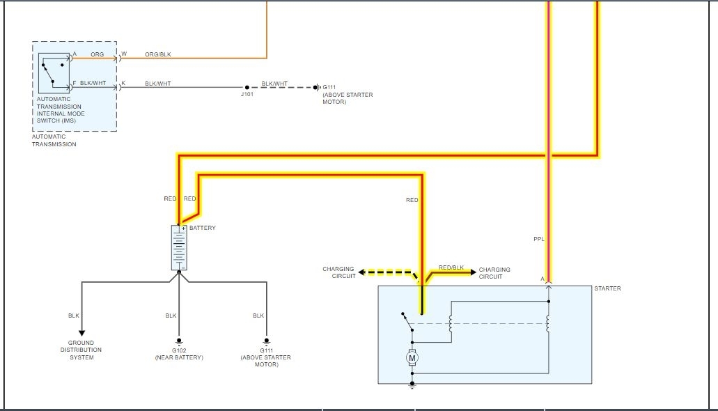

Engine shuddered and now won't start.
Saturday, January 16th, 2021 AT 7:14 AM
3 Replies
MECHANIC
52,797 POSTS
Good morning,
The first thing to check is the battery. Make sure it has 12.6 volts so there is enough power to crank and run the engine.
Next, I would make sure the engine turns. Try and turn the engine manually to be sure it turns.
I attached a wiring diagram for you of the starting system. We need to do some voltage checks for the starter to be sure it is good.

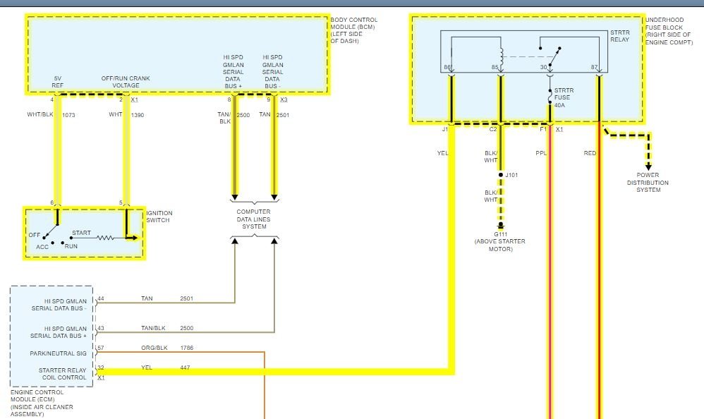

Just put in new battery lights work everything's on and again just 1 click.
Saturday, March 6th, 2021 AT 5:50 PM
MECHANIC
52,797 POSTS
Okay, can you go to the relay and do some testing for me? We need to see if there are any signals to the relay.
