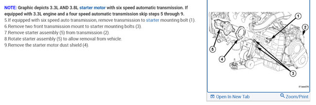

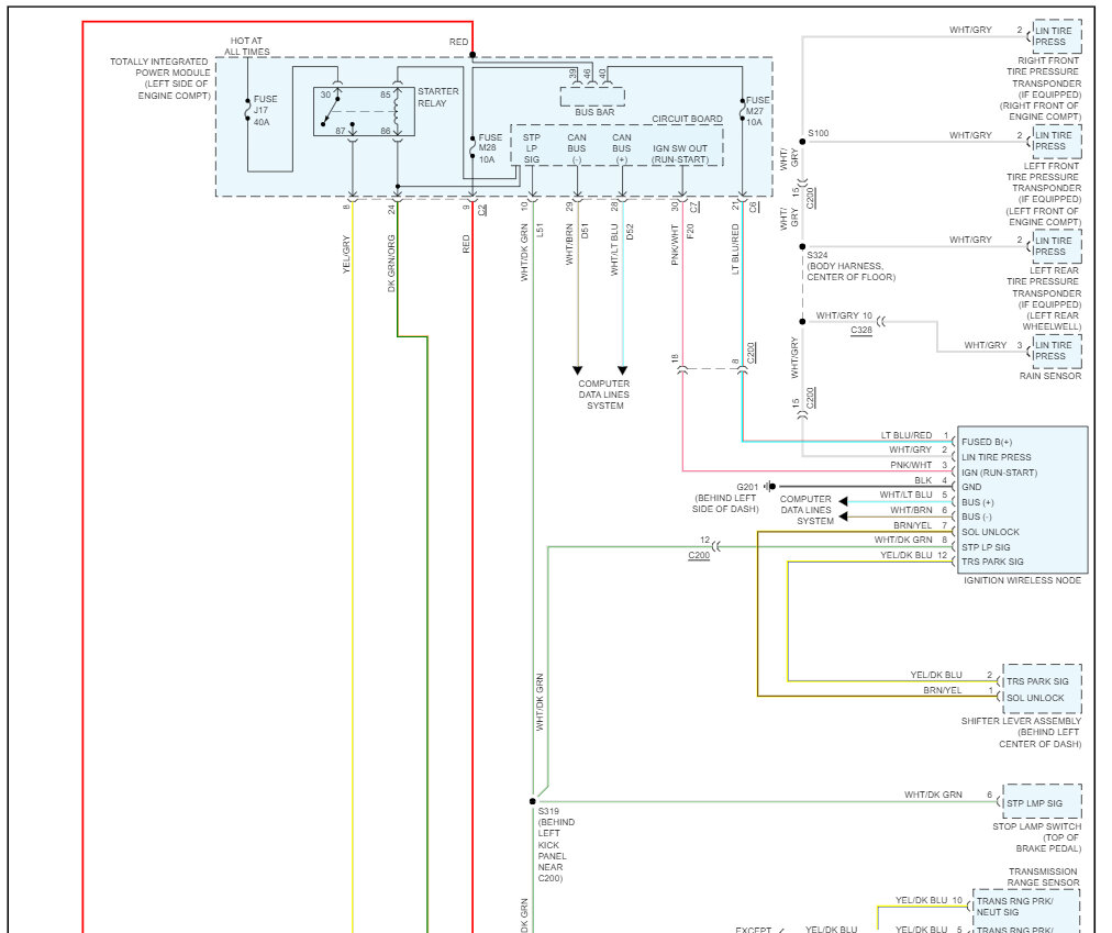

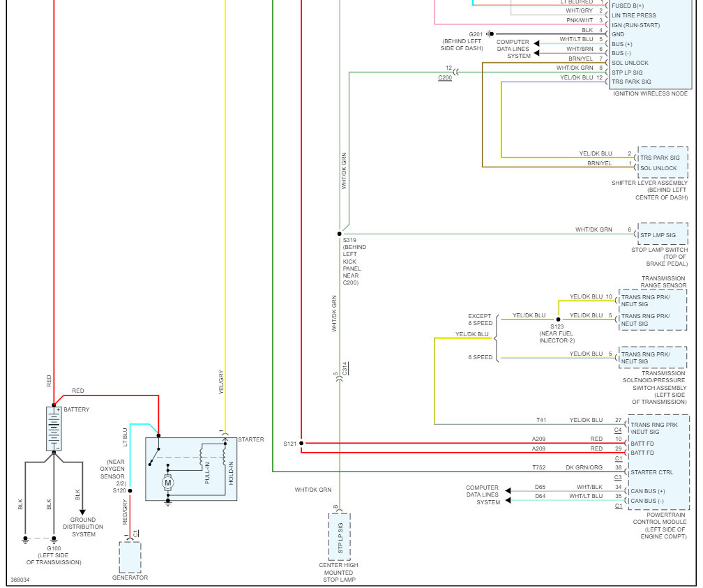

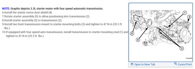

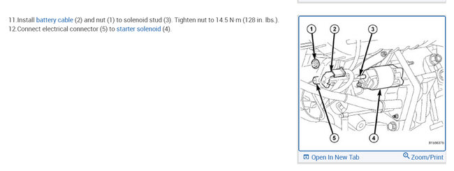

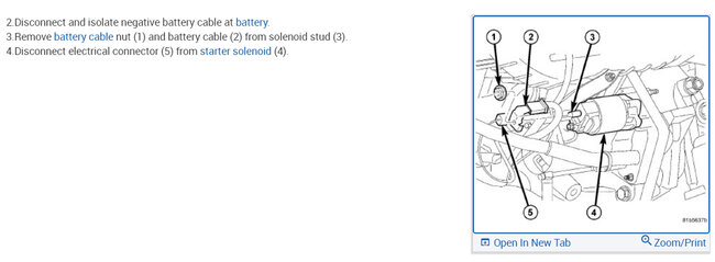

Chances are #1 the starter motor is going bad or #2 the starter relay is bad or #3 TIPM is going bad. When the engine does not crank over, we need to test the starter solenoid trigger wire for power.
here is a guide to help:

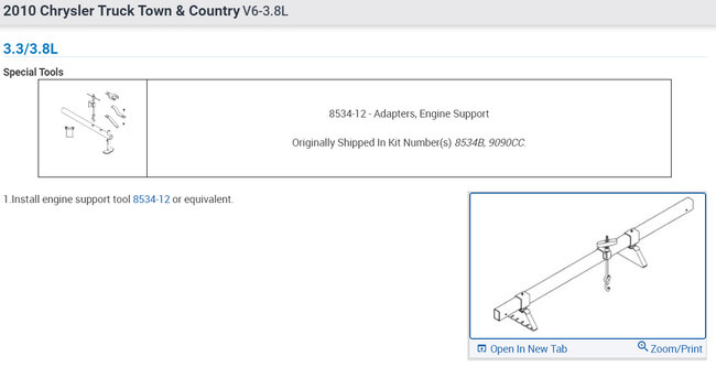

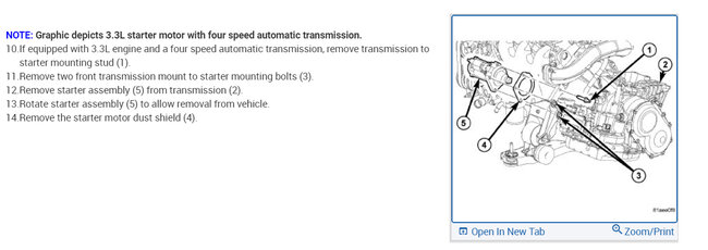

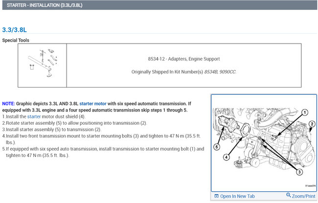

If the wire has power when cranking and the starter is not working the starter is bad. If not, it could be the starter relay or TIPM. Here are the starter wiring diagrams and how to change the starter out in case you need it. The starter relay is inside the TIPM under the hood. Check out the images (below). Let us know what happens and please upload pictures or videos of the problem so we can see what's going on.
