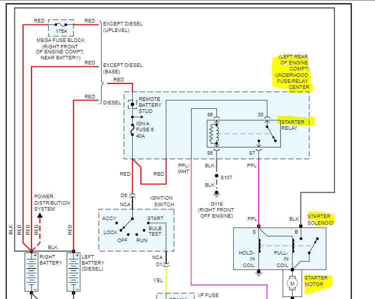

Replaced a fuel pressure regulator. Started the truck and shut it down. Went to start it again and it just made a clunk noise. Replaced the starter and now it will crank 10-15 Revo then stops and acts like it's out of power. Give it an hour or so and ya get 10 revos. Jumped the starter solenoid and it just clunks. Could it need to be shimed?

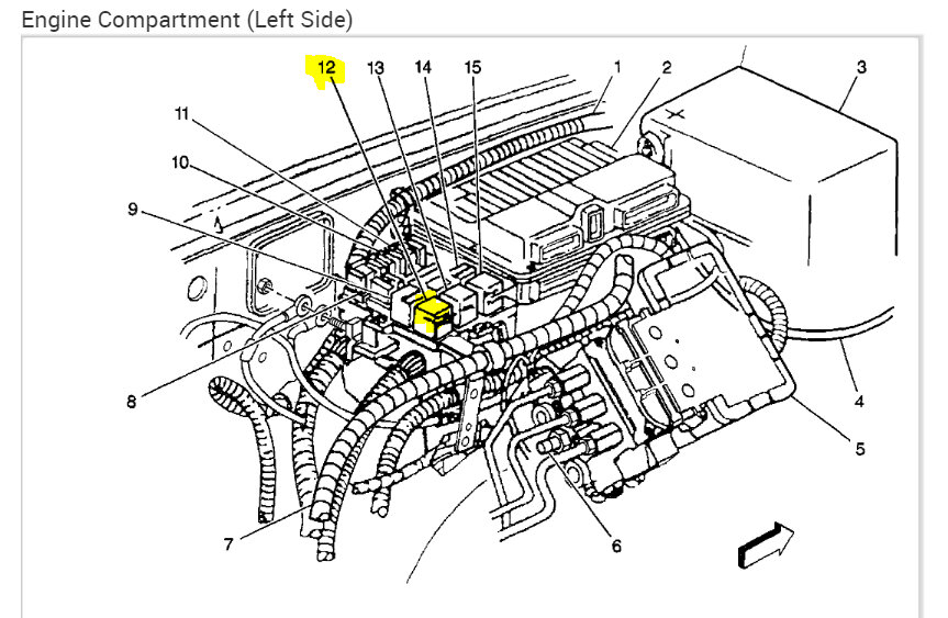

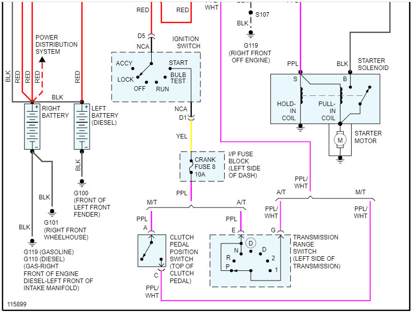

I attached the wiring schematic below for the starter circuit so that you would have a reference. Try switching the starter relay in the fuse box under the hood with a different one in the box having the same part number to see if that makes a difference. Additionally, confirm the connector pins for the relay are in good condition.
