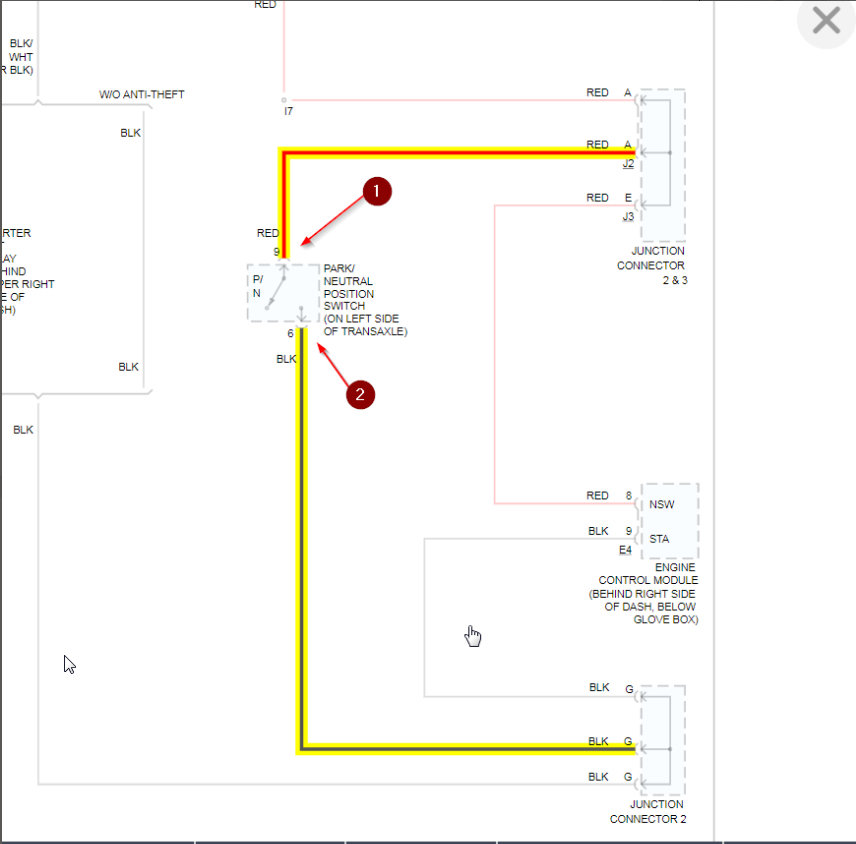

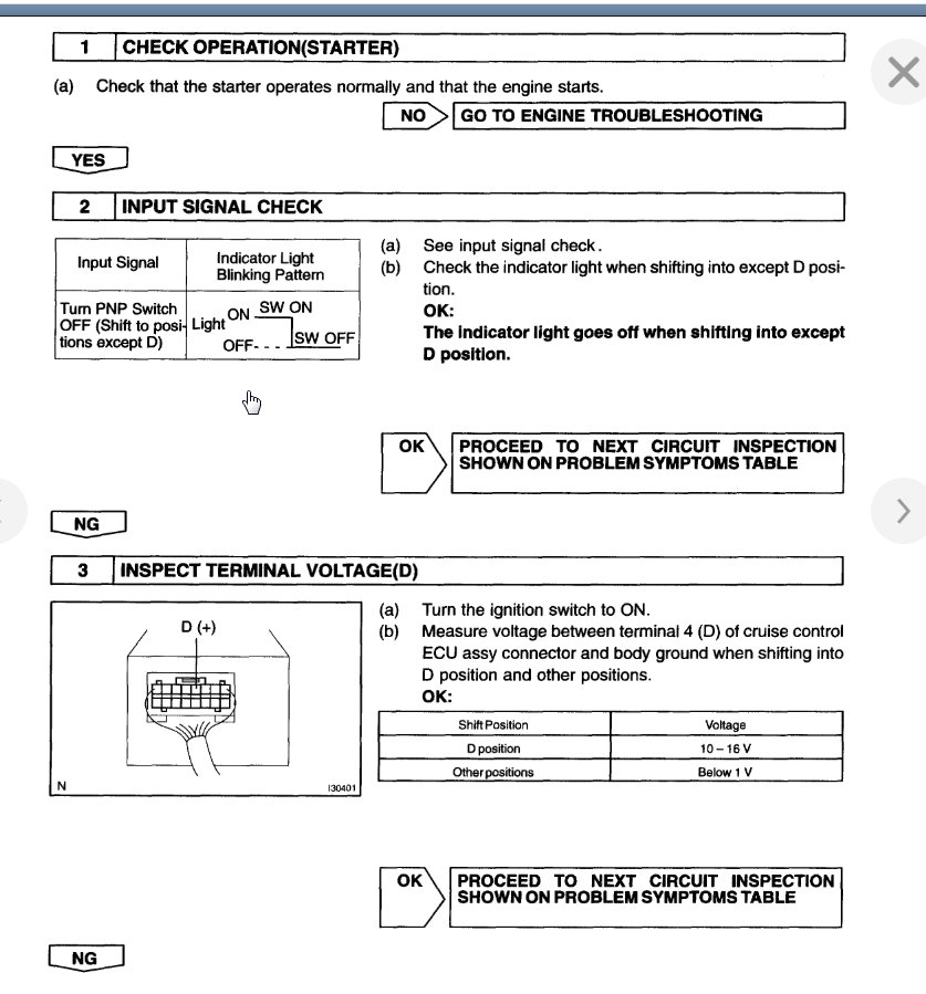

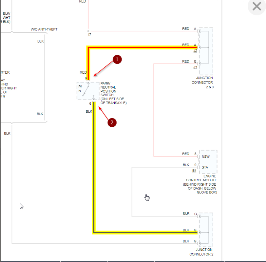

Yes. This could be the neutral safety switch so we need to test that. I attached the testing. Before you do that, does the theft light go out in the dash when trying to start the vehicle? If not, we need to go down that route.
If it does, then run through this testing and let me know what you find. Thanks.

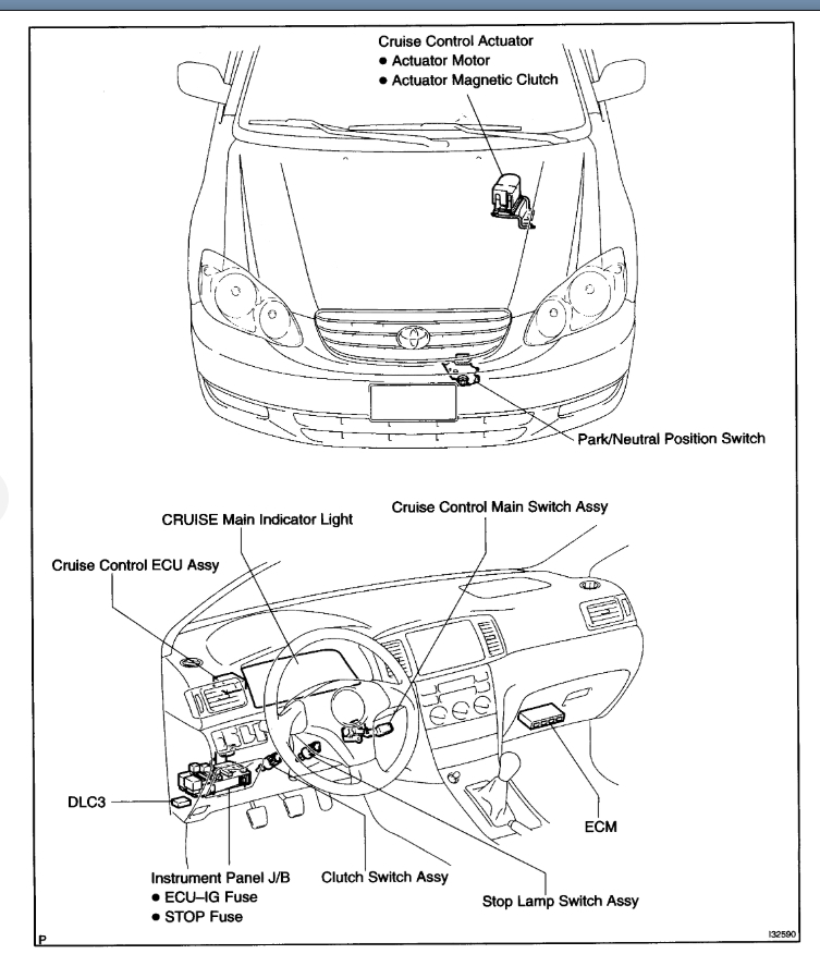

Alright so I checked everything you told me to check and everything is good, so the only thing I’m looking at now is the neutral Safety Switch it self. I checked the harness that goes to it and it’s giving off a good reading to the battery I even try to reset the ECM by unhooking the negative Battery terminal and the main fuse for 30 mins to see if maybe it would turn over but it didn’t. So idk if maybe it would need to have a new ECM or a New Neutral Safety Switch which I know for sure it does bc it’s not wanting to stay in park unless I get under the hood and pop it back in park by that way.
Friday, June 25th, 2021 AT 5:03 PM

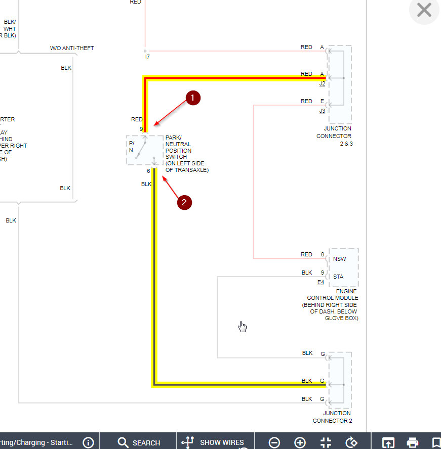

Okay. Can you just let me know what the voltage is for point 1 and 2 while cranking the engine? You could be correct but with that info that it will not stay in park points to an issue with the shift cable. When you manually put the vehicle in park are you able to start the vehicle?

Okay. Try setting your meter up on these points one at a time and then turn the key to the crank position and see what the voltage is. When cranking you should have 12 volts on both sides. Let me know what you find. Thanks
