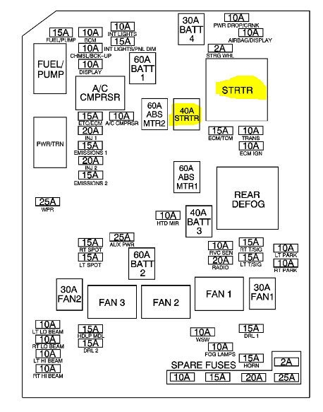

No crank no start, good battery, some of the electrical stuff works and some of it doesn't. I don't have any wiring diagrams to help me find the ignition or starter relays.
Aug 13, 2023 at 4:16 AM
  • 110,244 POSTS
Both the starter fuse and relay are located in the fuse box under the hood. See pic 1 below for locations.

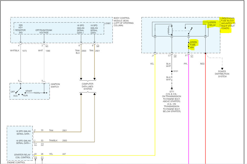

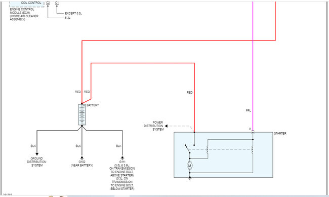

Next, I attached the wiring schematic for the starter circuit. Note that the 40-amp starter fuse doesn't get power until the key is in the start position and the relay actuates.
I had to cut the schematic in half to make it readable for you. I did overlap the two so that you can follow from one to the next.
Let me know if this helps or if you have questions.
