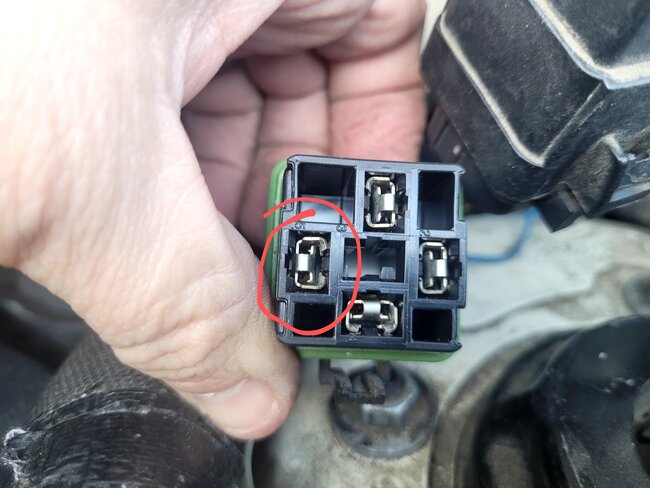

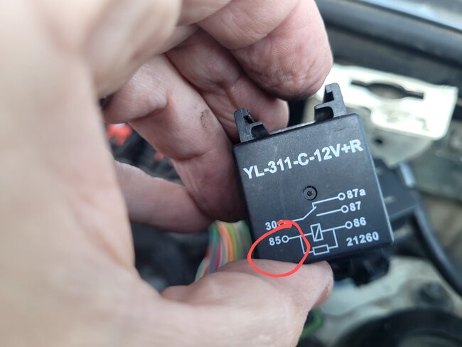

I tested the wire from the battery to the starter and it's good. The red wire to the engine is good at the battery terminal, and the integrated power unit has power. I don't see where the wire attaches directly to the engine. I installed a new starter relay and tested the port where it plugs in. 30 and 86 are showing power, 87 and 85 are showing ground when tested. I also tested all of the fuses and they are good. Also, I have already replaced the battery, starter, and ignition switch.
Apr 22, 2023 at 8:39 AM
ZURENARRH
  • 10 POSTS
Correction: PIN 85 is *not* showing ground. It should show ground for the PCM. I have already replaced the PCM (purchased it programmed).
Apr 22, 2023 at 10:35 AM
  • 110,248 POSTS
When you checked Pin 85 for the signal ground, was the key in the start position? If it was and the PCM relay control circuit didn't provide a ground path, there is likely a problem with the new PCM, the wire between the two components, or a connection issue.

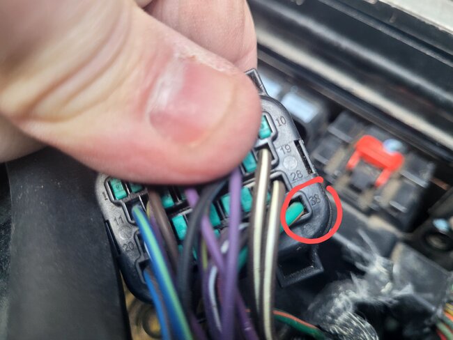

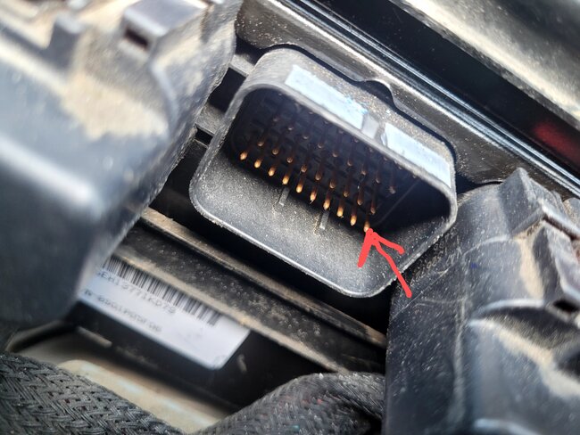

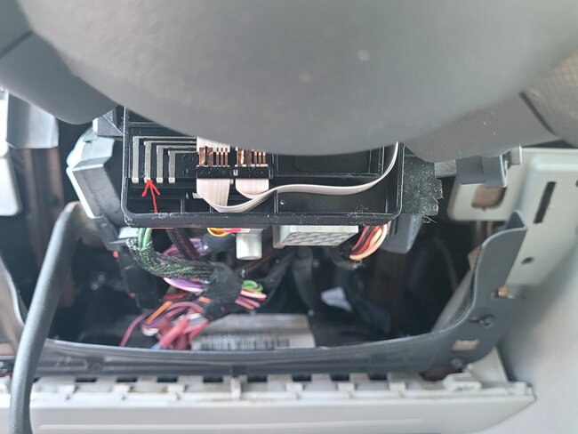

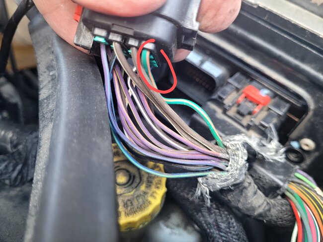

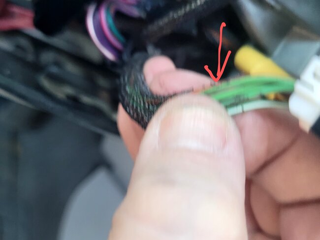

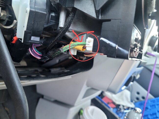

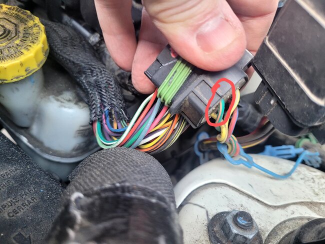

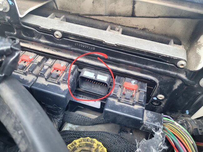

Update: First, I haven't yet followed your most recent instructions (I was checking something and forgot). I realized that my relays were mounted backwards, I haven't been working with the right one. 30 is live, 87 ground, 86 live, 85 is ground but very weak and sometimes blinking when checked (only when key is at "on" position). I followed the wire (green with orange stripe). It ends in the steering column. When I test where the wire connects on that end, I do not get confirmation of ground (tried with key out and in "on" position). I also tested the corresponding pin in the PCM, and it did not give confirmation of ground. I have attached pictures, but they may not show up in order. What are your thoughts?
Apr 25, 2023 at 10:15 AM
  • 110,248 POSTS
The connectors and wiring look new. If the PCM isn't providing a constant ground, that is the likely issue. Is it under warranty? If so, I would contact the supplier.
