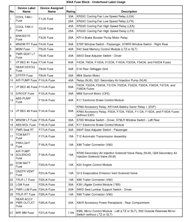

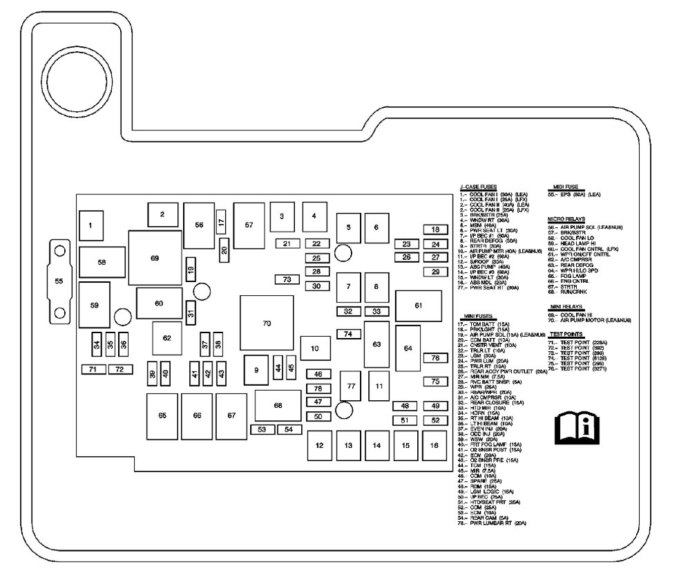

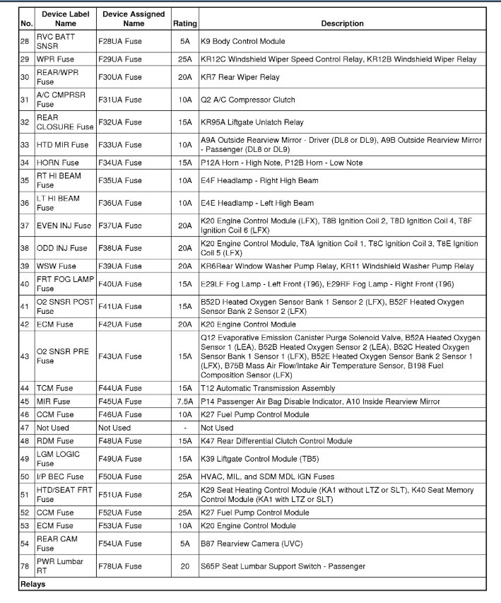

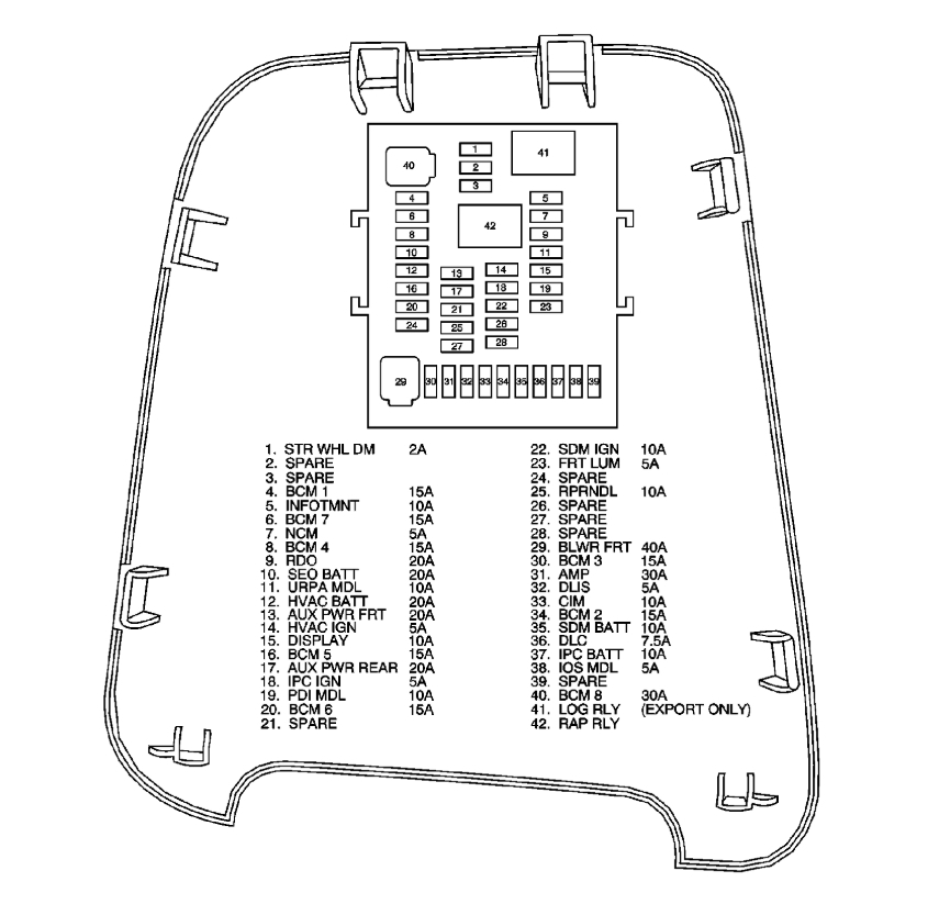

No communication? can you please try the scanner on another car to see if it works? , if so lets check the system fuses. here is a guide and the fuse panel locations make sure the key is on. Also when you turn the key to the on position without cranking the engine over can you hear the fuel pump run in the tank for 5 seconds?
Mar 30, 2020 at 11:06 AM
DONATO68SS
  • 16 POSTS
Yes, I have checked the scanner on my other car and it works fine. I do not hear the fuel pump run when ignition is on. I have checked every fuse also.

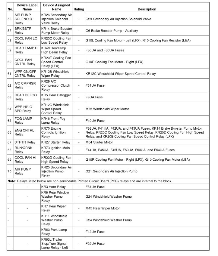

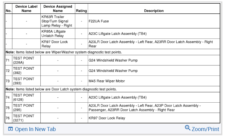

I got the car to crank by jumping the starter solenoid with the 30 and 87 pin. I have checked all fuses. I got a hold of another scanner but still can’t communicate with the car. Any other suggestions?
Mar 31, 2020 at 6:13 PM
You just bypassed the relay. The ECM is preventing it from starting due to the communication issue.
Mar 31, 2020 at 6:16 PM
DONATO68SS
  • 16 POSTS

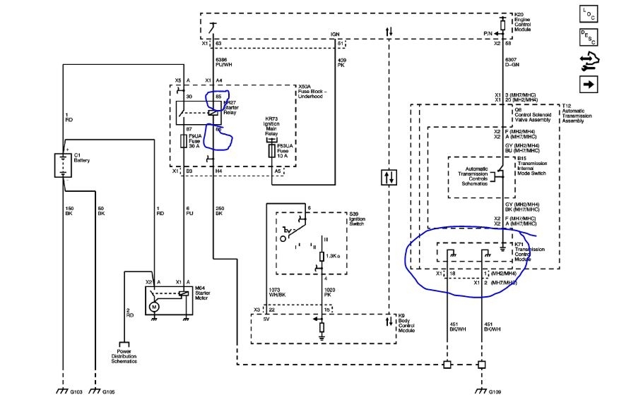

Do you possibly have the wiring schematics for the starter?
Mar 31, 2020 at 6:53 PM
Diagram attached.
Let me know if you have any other questions.
Mar 31, 2020 at 7:02 PM
